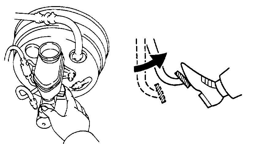

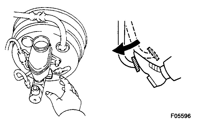

2. BLEED MASTER CYLINDER
HINT: If the master cylinder has been disassembled or if the reservoir becomes empty, bleed the air from the master cylinder.
pic 2
(a)Disconnect the brake lines from the master cylinder.

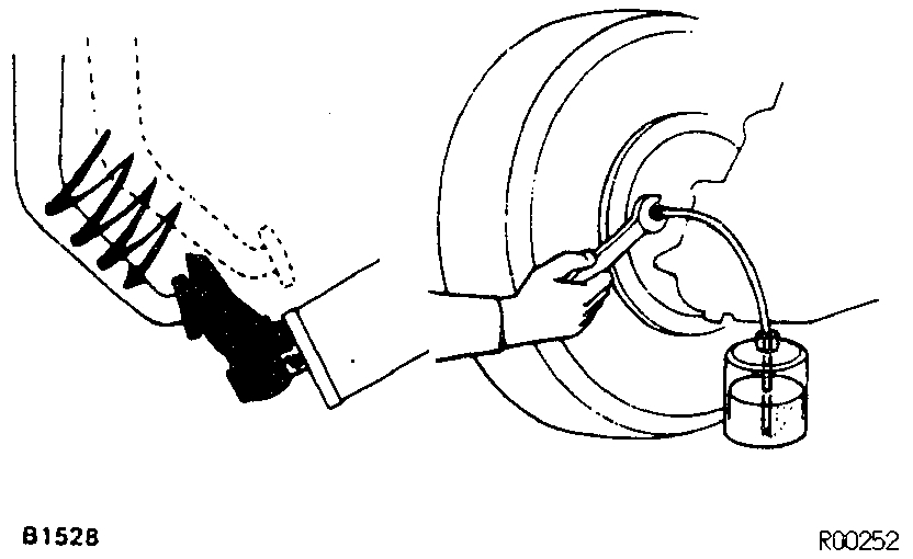

(b)Slowly depress the brake pedal and hold it.
pic 3
(c)Block off the outlet plugs with your fingers, and release the brake pedal.
(d)Repeat (b) and (c) 3 or 4 times.

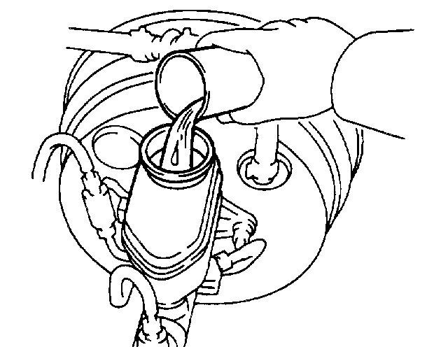

Loosen/Tighten Bleeder Plug
pic 4
3. CONNECT VINYL TUBE TO BRAKE CALIPER OR WHEEL CYLINDER BLEEDER PLUG
Insert the other end of the tube in a half-full container of brake fluid.
NOTICE: Bleed air of the rear brake first. If front brake is bled first, rear brake air cannot be bled.

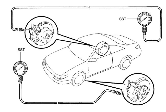

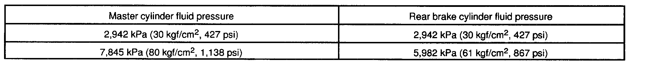

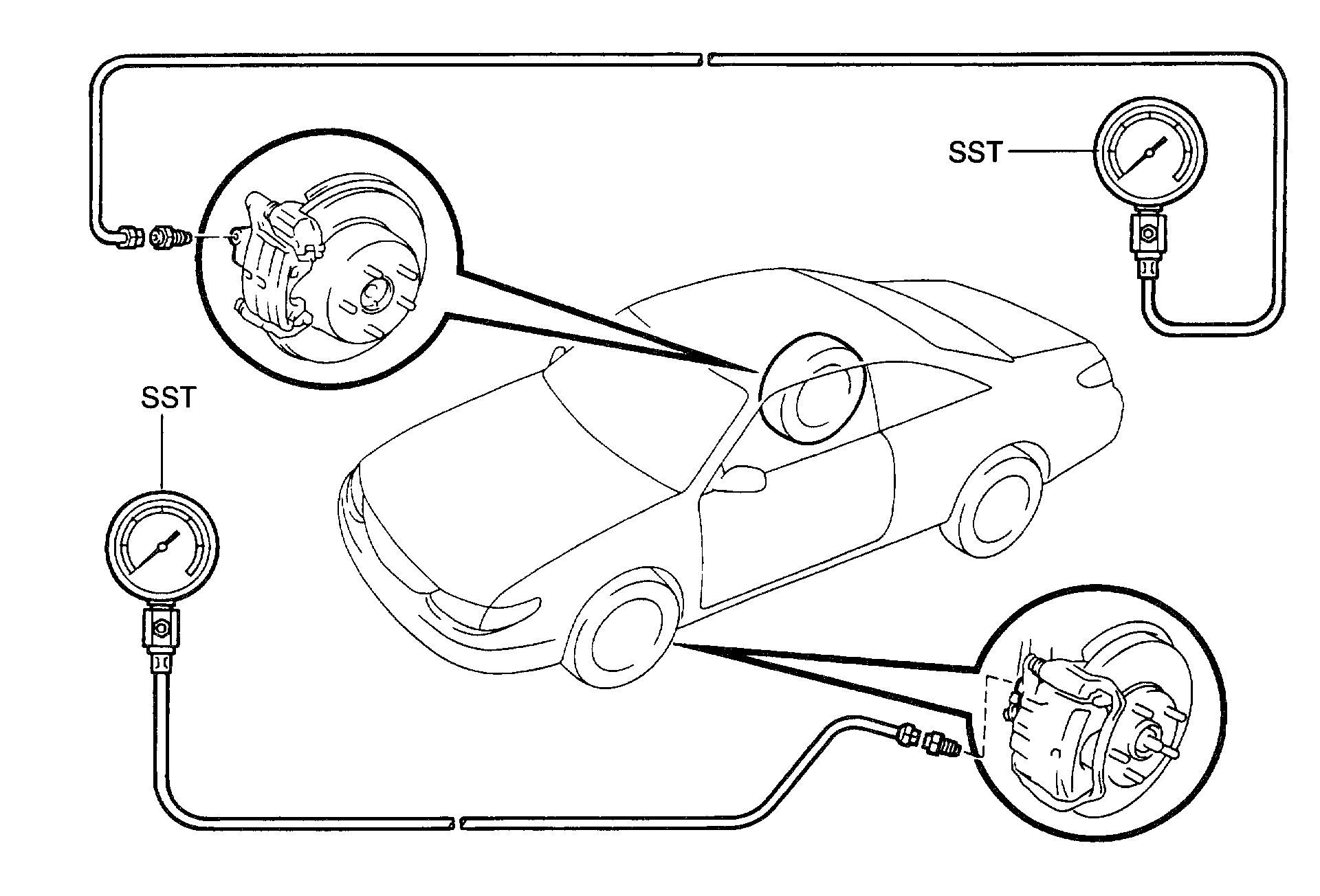

LOAD SENSING PROPORTIONING VALVE AND BY-PASS INSPECTION
pic 5
1. INSTALL LSPV GAUGE (SST)
SST 09709-29018
2. BLEED AIR FROM LSPV GAUGE (SST)
pic 6
3. RAISE MASTER CYLINDER PRESSURE AND CHECK REAR WHEEL CYLINDER OR CALIPER PRESSURE
If the rear brake cylinder pressure is incorrect, replace the P valve assembly.
4. REMOVE LSPV GAUGE (SST) AND BLEED BRAKE SYSTEM
5. CHECK FOR LEAKS

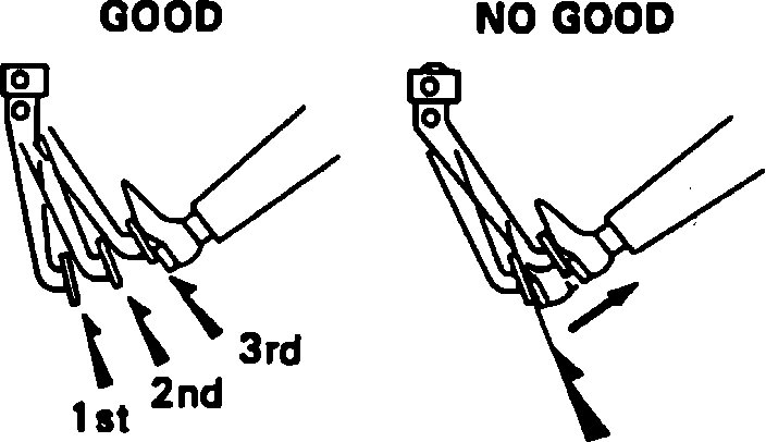

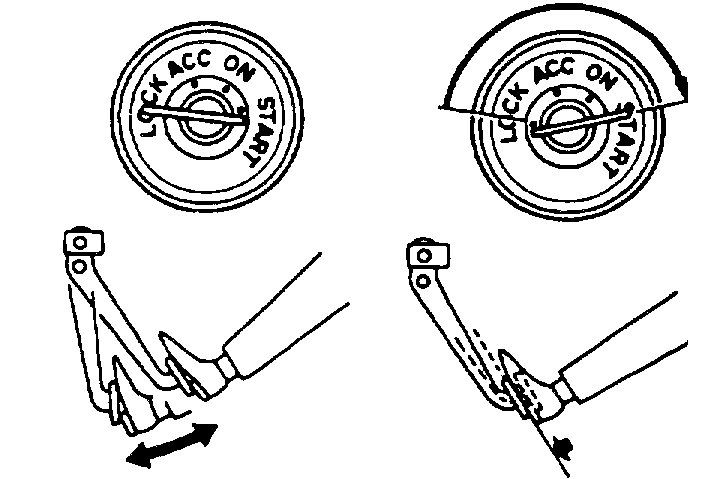

Here are directions for testing if there is an issue with the booster.
AIR TIGHTNESS CHECK
Pics 7 & 8
(a)Start the engine and stop it after 1 or 2 minutes. Depress the brake pedal several times slowly.
If the pedal goes down farthest the 1st time, but gradually rises after the 2nd or 3rd time, the booster is air tight.
(b)Depress the brake pedal while the engine is running, and stop the engine with the pedal depressed.
If there is no change in the pedal reserve travel after holding the pedal for 30 seconds, the booster is air tight.
__________________________________________
If there are no leaks, the booster is good, there is no air left in the system, and the pressure at the proportioning valve is good, I suspect you got a bad MC. Was the original one doing the same thing?
