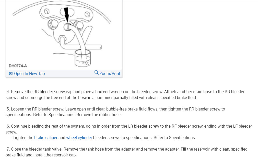

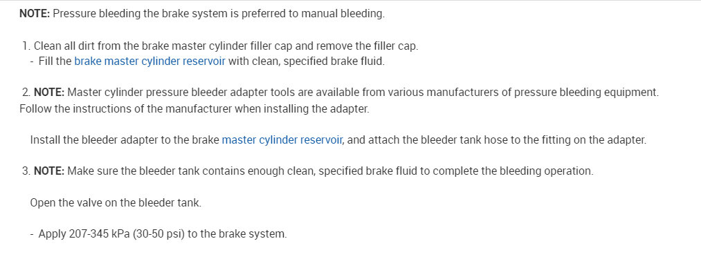

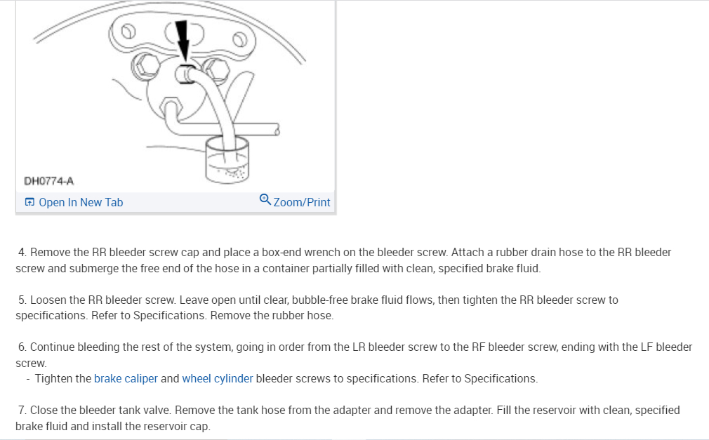

It sounds like you still have air in the system. On these vehicles, I have found that you need to use a brake bleeder at the master cylinder to pressure bleed the system.
I attached the directions below. Try this and let me know if it takes care of the issue.
See pics below.
