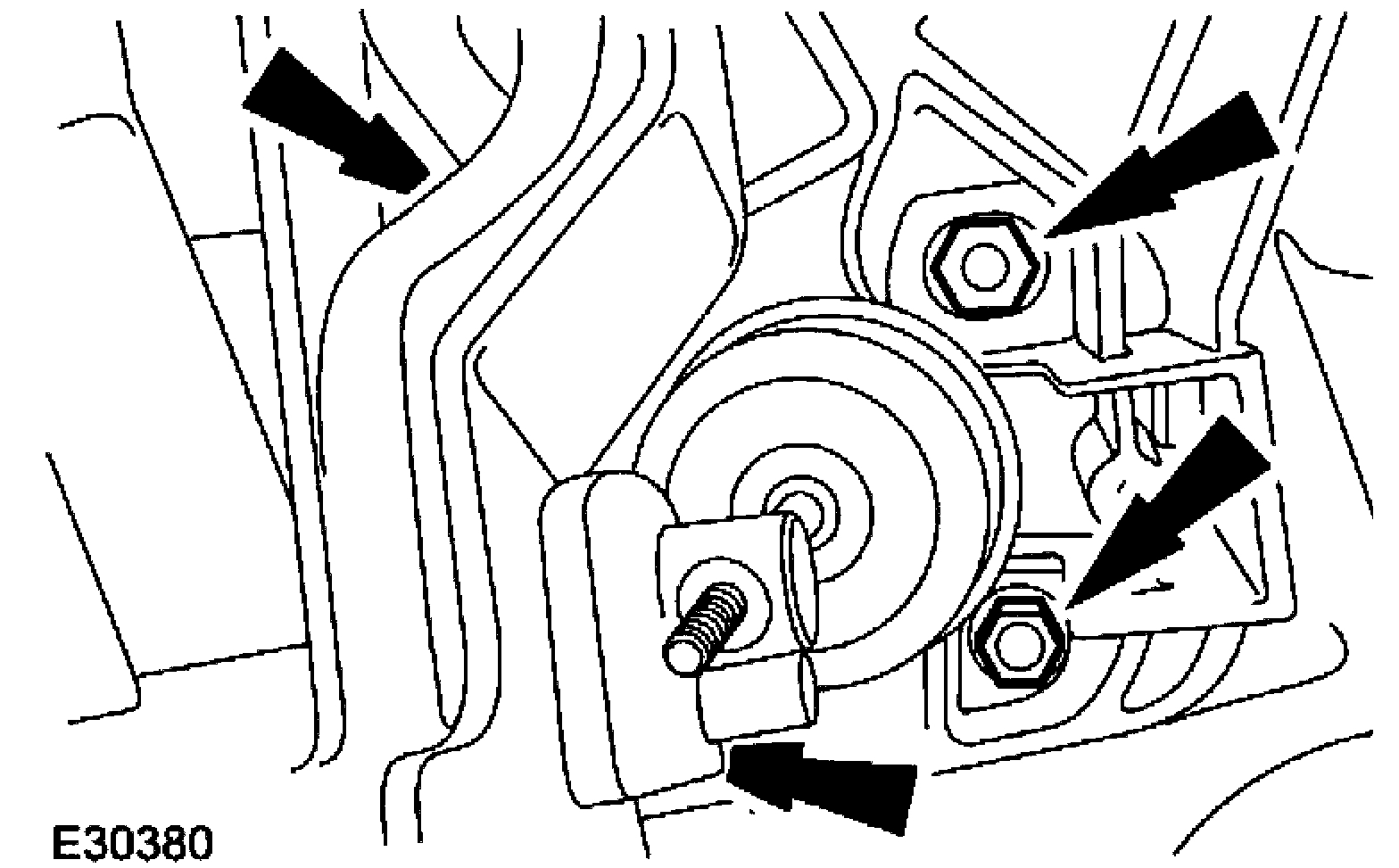

If you determine the brake booster is bad, here are the directions for replacement. The attached pictures correlate with these directions,
Brake Booster
Removal
1. Remove the brake master cylinder.
See Picture 1

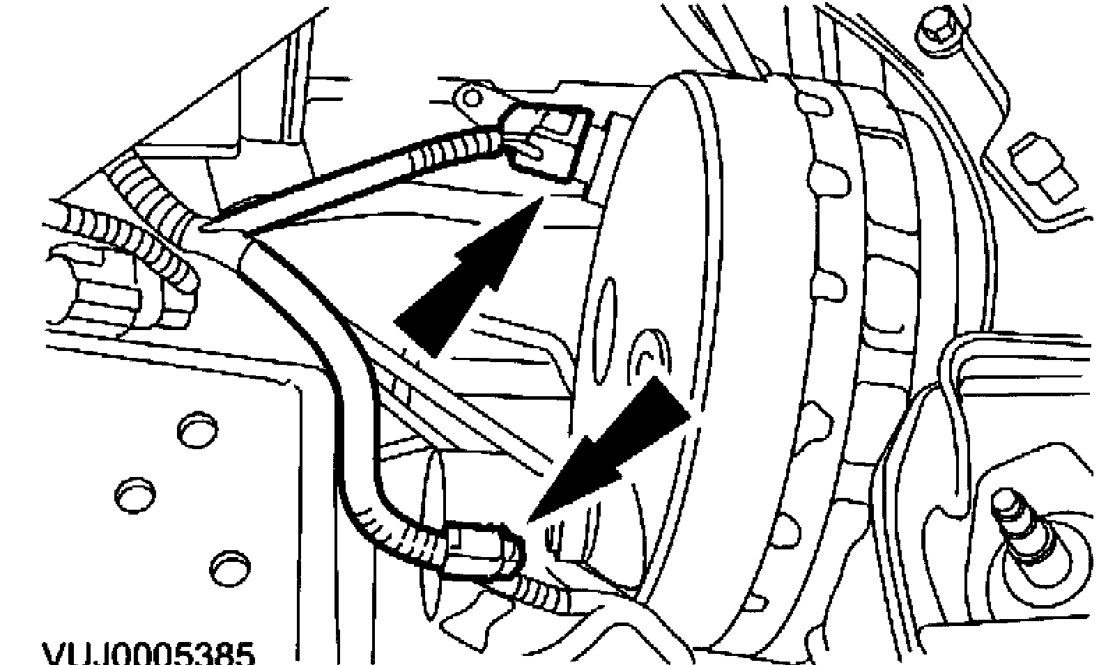

2. Disconnect the brake booster pedal travel sensor and brake booster solenoid electrical connectors.
See Picture 2

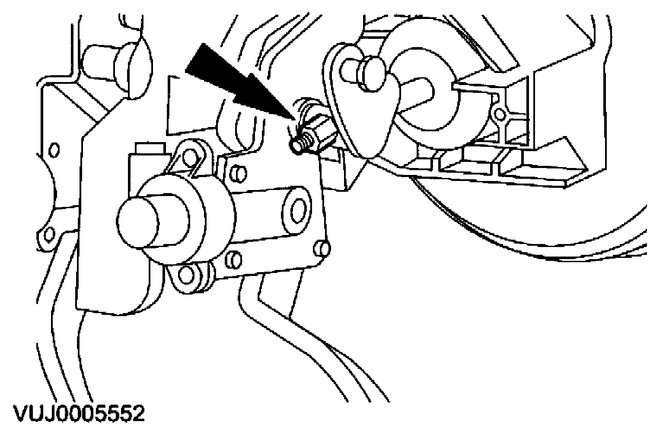

3. Remove the brake booster retaining nut.
See Picture 3
4. NOTE: The non-return valve and vacuum pipe assembly should be removed with the brake booster.

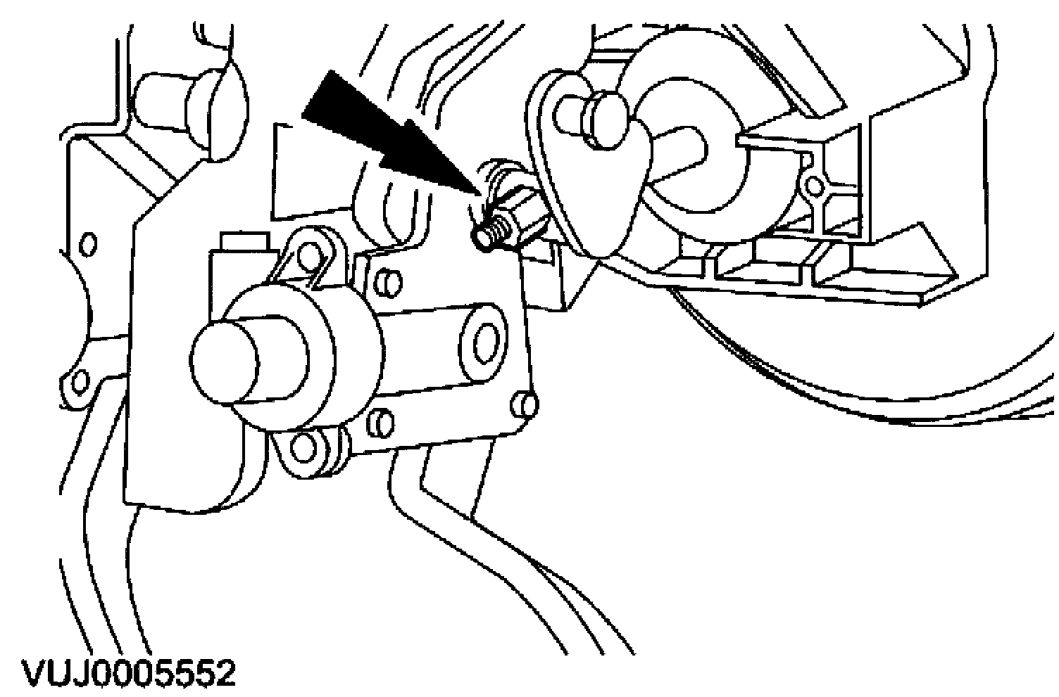

Installation
See Picture 4
1. NOTE: When renewing the brake booster, the non-return valve and vacuum pipe assembly should be installed prior to the brake booster installation.
NOTE: Replace the brake booster/pedal box gasket.
To install, reverse the removal procedure.
^ Tighten to 25 Nm.
