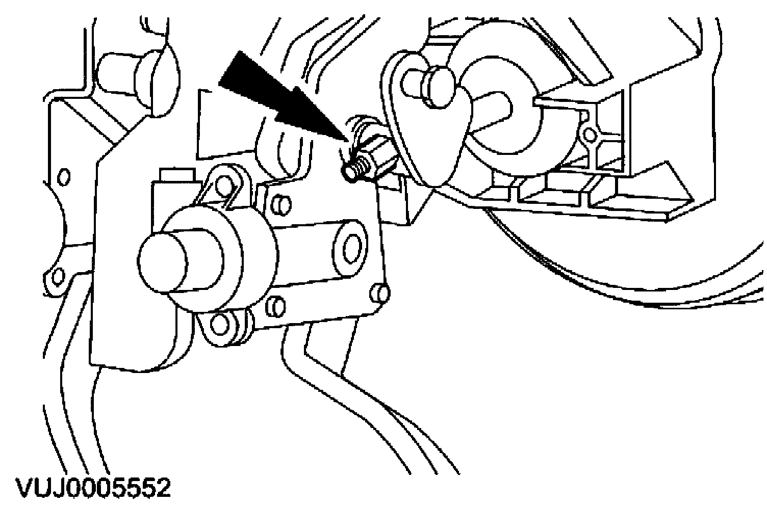

1. Remove the brake master cylinder.
pic 1

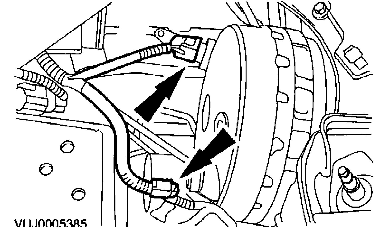

2. Disconnect the brake booster pedal travel sensor and brake booster solenoid electrical connectors.
pic 2

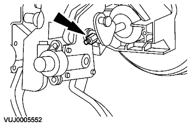

3. Remove the brake booster retaining nut.
pic 3

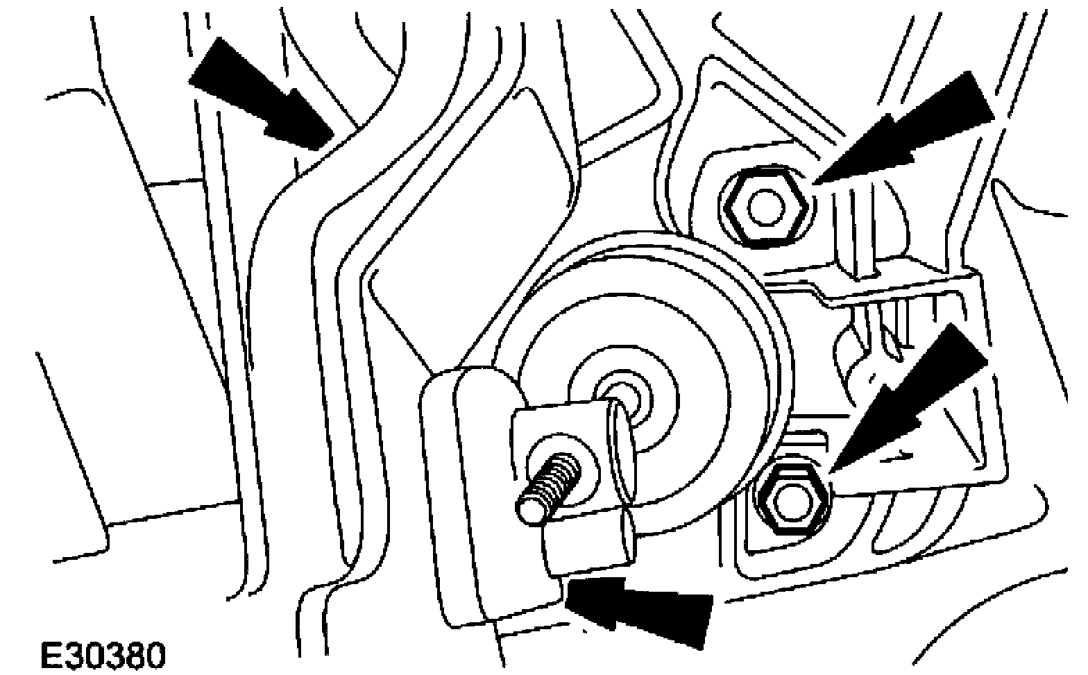

4. NOTE: The non-return valve and vacuum pipe assembly should be removed with the brake booster.
Installation
pic 4
1. NOTE: When renewing the brake booster, the non-return valve and vacuum pipe assembly should be installed prior to the brake booster installation.
NOTE: Replace the brake booster/pedal box gasket.
To install, reverse the removal procedure.
^ Tighten to 25 Nm.
