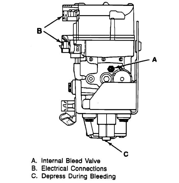

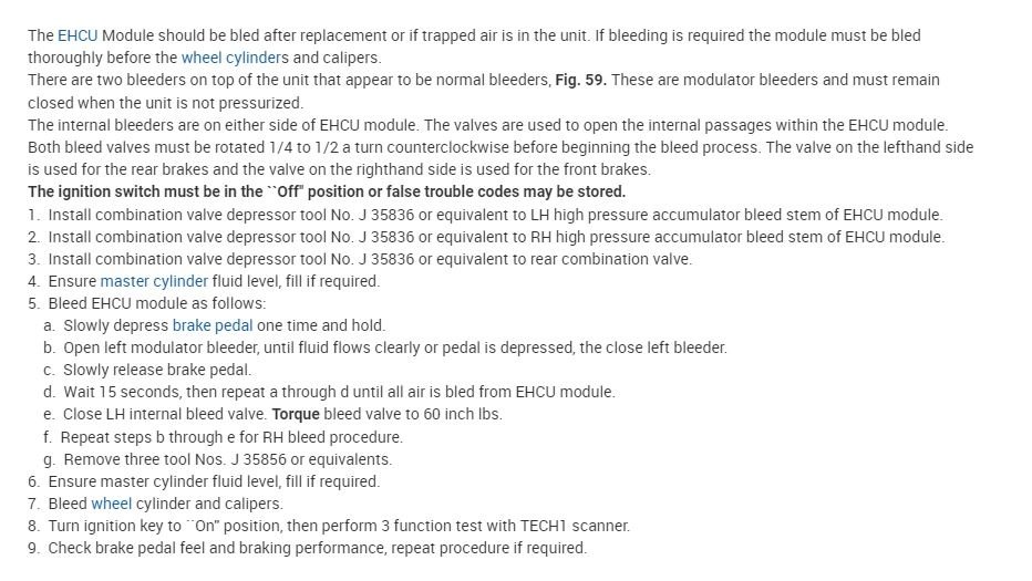

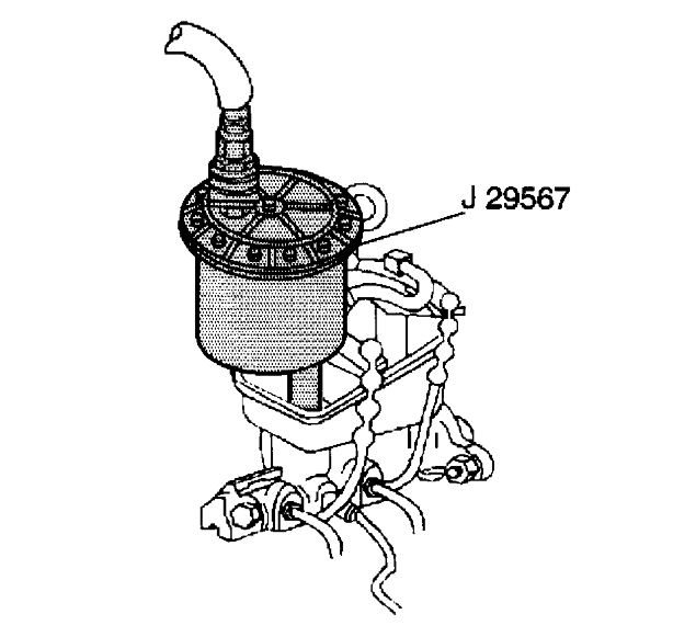

Good evening,
Convention bleeding on a truck rarely works. There is not enough pedal push to get the air out.
you need to power bleed the system. That is where you attach a cover to the top of the master cylinder and the air is applied to the master. Then you open the bleeders in sequence until the air is gone.
a side note. If you have ABS, you will need to do the other procedure I attached as well. Convention and pressure bleeding does not get the air out of the ABS unit.

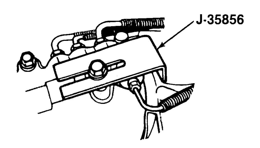

Pressure Bleeding
Note: The pressure bleeding equipment must be of the diaphragm type. It must have a rubber diaphragm between the air supply and the brake fluid to prevent air; moisture, oil, and other contaminants from entering the hydraulic system. Also adapters are needed. depending on the type of master cylinder used.
Tools Required:
J-29567 Brake Bleeder Adapter (Plastic Reservoir)
J-35856 Combination Valve Depressor
Note: It is very important that the correct master cylinder bleeder adapter be used to avoid possible damage to the master cylinder reservoir.
1. Fill the pressure tank at least 1/3 full of brake fluid. The bleeder must be re-bled each time fluid is added.
a. Charge the bleeder to 140 - 170 kPa (20 to 25 psi).
2. Use J-35856 to depress and hold the valve stem on the combination valve during the bleeding operation.
a. Install the bleeder adapter so the leg with the release valve is towards the cowl.
3. Bleed each wheel in the following sequence.
a. Right rear
b. Left rear
c. Right front
d. Left front
4. Connect the hose from the bleeder to the adapter at the master cylinder.
a. Open the tank valve.
5. Attach a hose to a brake bleeder screw.
a. Immerse the opposite end of the hose into a container partially filled with clean brake fluid.
6. Open the bleeder screw at least 3/4 of a turn and allow the fluid to flow until no air is seen in the fluid.
a. Close the bleeder screw.
7. Repeat step six at all the wheels.
8. Open the bleeder screw on the Isolation/Dump Valve (vehicles with power brakes only).
a. Allow the fluid to flow until no air is seen in the fluid.
b. Close the bleeder screw.
9. Check the brake pedal for "sponginess", repeat the entire bleeding procedure if this condition is found.
10.Remove J-35856.
a. Disconnect the line from the bleeder adapter.
b. Remove bleeder adapter.
11.Fill the master cylinder to the proper level with brake fluid.
Feb 22, 2021 at 5:33 PM (Merged)
