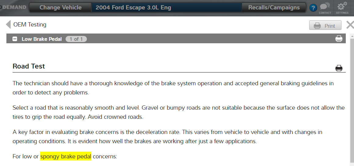

The best suspect is the master cylinder was damaged in the same way we never push the brake pedal more than half-way to the floor when pedal-bleeding with a helper. Given the age of the vehicle, there will be crud and corrosion built up in the lower halves of the bores in the master cylinder where the pistons don't normally travel. Running the pistons over that crud can rip the rubber lip seals resulting in a slowly-sinking brake pedal that often takes two or three days to show up. When the primary seal on just one piston is ripped, the brake fluid behind the good seal has to move the second piston as well as move its fluid out to the wheels. The pedal will be low, but that's why there is still some stopping power.
It isn't real common for this damage to occur when the brake fluid is under high pressure, but it can happen. This damage occurs much more commonly during pedal-bleeding where there is no real pressure in front of the primary seals.

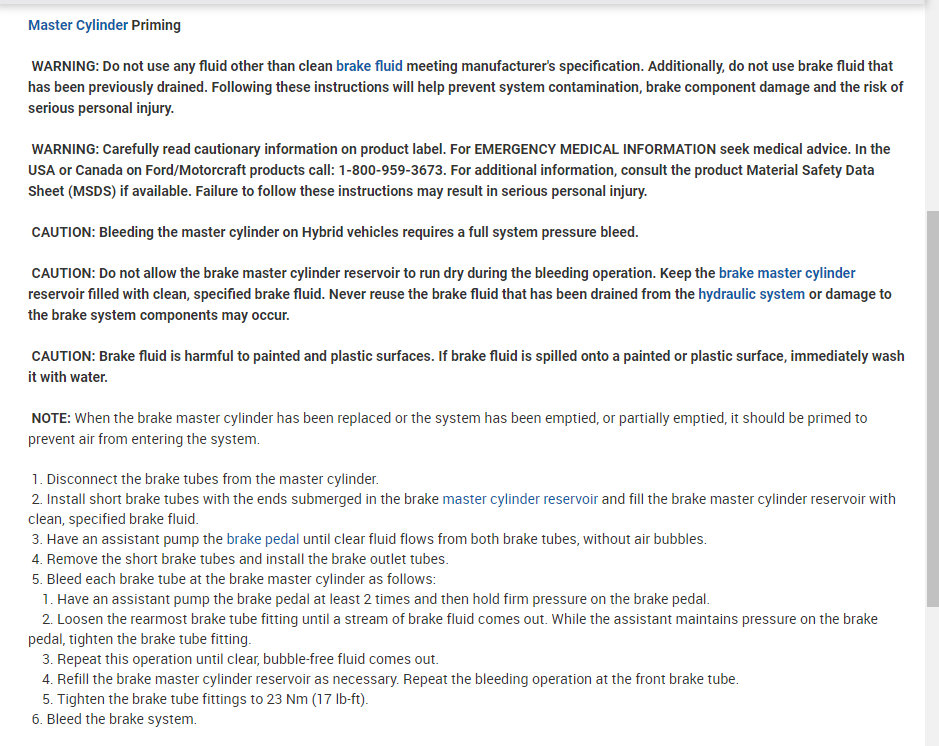

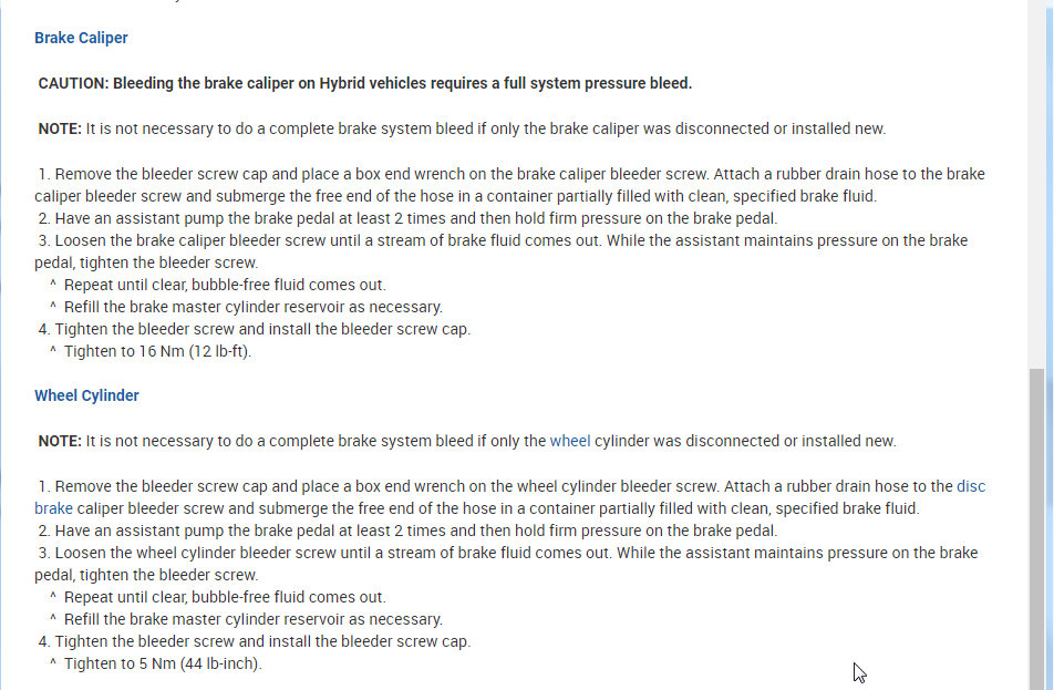

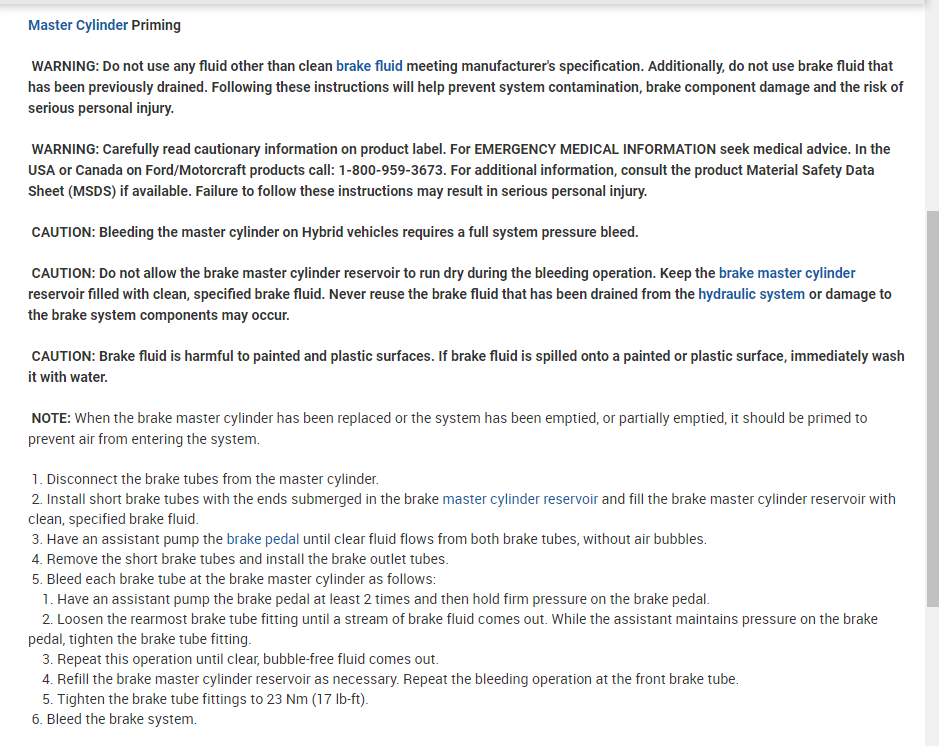

Most people bleed at the wheels when replacing the master cylinder, but that is not necessary, and it can add another chapter of frustration to the story. Any air sent down the lines will become trapped in the ABS hydraulic controller. You'll need a scanner to bleed that air out. It commands the computer to open two valves so those chambers can be bled. On brands other than Ford, loosen the soft steel line nuts at the master cylinder, unbolt the master cylinder and slide it forward, away from the power booster, then use it as a handle to bend the lines upward a little. That prevents brake fluid from running out of them. Remove the master cylinder. Once the new master cylinder is bench-bled, install the lines, then push it down to bend the lines back to normal. Bolt the master cylinder to the power booster.
Ford products often have four steel lines coming out of the master cylinder. That makes it impossible to bend all of them upward, but the rest of the procedure still works. With the new master cylinder installed, loosen one of the line nuts about half a turn, then have a helper slowly push the brake pedal no more than half way to the floor. The new master cylinder won't be damaged by pushing the pedal too far because no corrosion has built up in it yet, but it's a good practice to have your helper get used to. Snug the line nut, then holler to your helper to quickly release the pedal. Loosen the nut again, then have him push the pedal slowly again. It should take about 15 seconds to push the pedal half way to the floor. If you still see any air bubbles sneaking out, do that a third time. Repeat the procedure for each of the other lines.
By pushing the pedal slowly, fluid gets pushed down the lines, but the air has time to float back up. When releasing the pedal quickly, the fluid rushing back up to the reservoir washes any remaining air bubbles up there with it.
On a few occasions I've had a brake pedal that was a little low at first, but by just driving the vehicle and sitting at red lights with the brakes applied, it never took more than a few miles for the last few air bubbles to work their way out to the reservoir. There's no way air can make its way down to the wheels, so there's no need to bleed at them.
