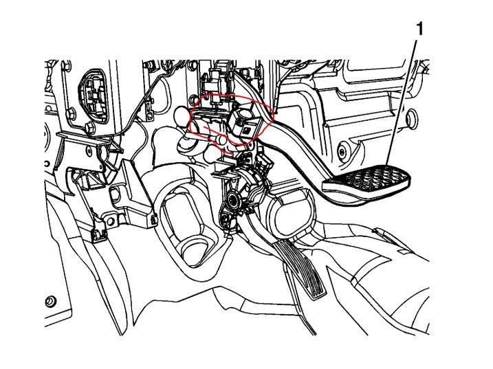

Pedal
Brake and Accelerator Pedal Assembly Replacement
Removal Procedure
1. Remove the instrument panel tie bar. Refer to Instrument Panel Tie Bar Replacement See: Dashboard / Instrument Panel > Removal and Replacement > Instrument Panel Tie Bar Replacement
2. Disconnect the accelerator pedal position sensor electrical connector.
3. Remove the brake pedal position sensor. Refer to Brake Pedal Position Sensor Replacement See: Pedal Positioning Sensor > Removal and Replacement > Brake Pedal Position Sensor Replacement
4. Pull the brake pedal (1) rearward to release the power vacuum brake booster pushrod retainer.
Note:
Do not reuse the power vacuum brake booster pushrod retainer.
5. Remove and discard the power vacuum brake booster pushrod retainer.
6. Remove the power vacuum brake booster. Refer to Power Vacuum Brake Booster Replacement See: Vacuum Brake Booster > Removal and Replacement > Power Vacuum Brake Booster Replacement

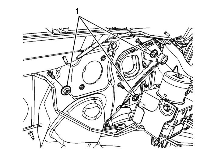

7. Remove the brake pedal assembly nuts (1).
8. Remove the brake pedal assembly.

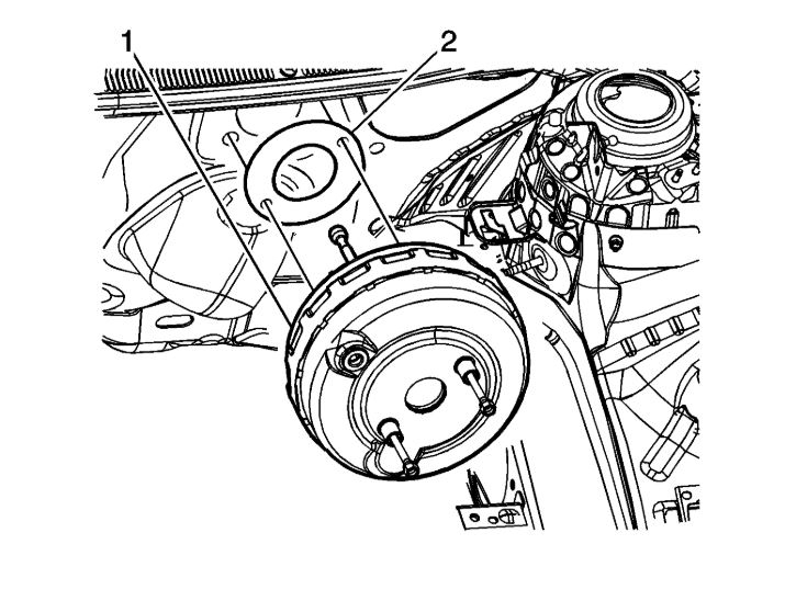

Booster
Removal Procedure
1. With the engine OFF, apply and release the brake pedal several times until the pedal becomes firm to deplete the power vacuum brake booster vacuum reserve.
2. Without draining the coolant and without disconnecting the hoses, remove and position aside the radiator surge tank. Refer to Radiator Surge Tank Replacement See: Coolant Reservoir > Removal and Replacement > Radiator Surge Tank Replacement.
3. Disconnect the brake pedal position sensor electrical connector. Refer to Brake Pedal Position Sensor Replacement See: Pedal Positioning Sensor > Removal and Replacement > Brake Pedal Position Sensor Replacement.
4. Release the brake pedal (1) from the power vacuum brake booster pushrod by lifting the pedal upward.
Note: Do not reuse the brake pedal retainer.
5. Remove and discard the brake pedal retainer.

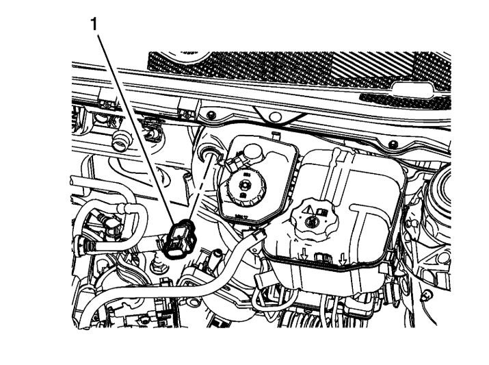

6. Disconnect the power vacuum brake booster vacuum sensor electrical connector.

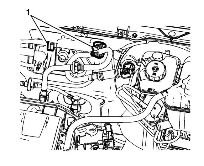

7. Release the power brake booster vacuum inlet pipe from the retainers (1) on the dash panel.
8. Remove the power brake booster vacuum sensor (1) from the power vacuum brake booster and position aside.
9. Disconnect the brake fluid level indicator switch electrical connector.
10. Remove the electronic brake and traction control module (EBTCM). Refer to Electronic Brake and Traction Control Module with Brake Pressure Modulator Valve Replacement See: Electronic Brake Control Module > Removal and Replacement > Electronic Brake and Traction Control Module with Brake Pressure Modulator Valve Replacement.

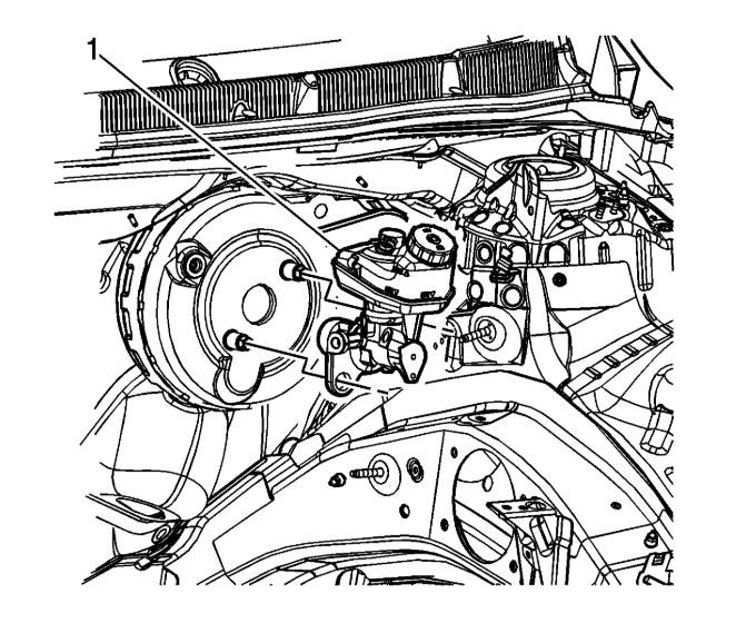

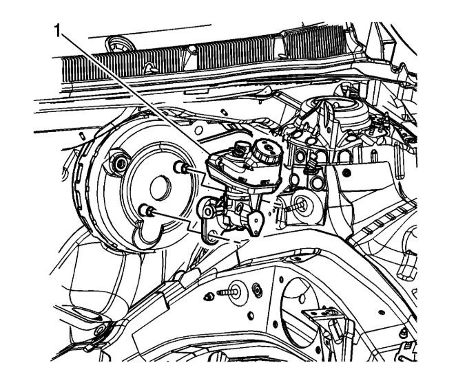

11. Remove the master cylinder nuts (1).
12. Remove the master cylinder (1).
13. Inspect the master cylinder O-ring seal for damage and replace, if necessary.

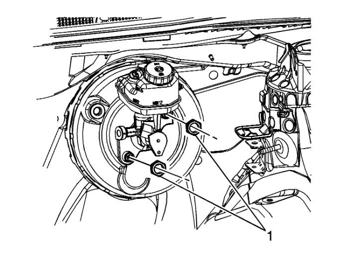

14. Completely loosen the power vacuum brake booster bolts (1).
15. Remove the power vacuum brake booster (1).
16. Inspect the power vacuum brake booster gasket (2) for damage and replace, if necessary.
