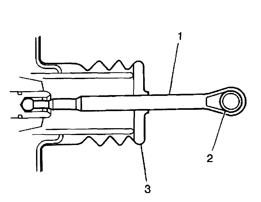

The accident report stated that a cable that connects to the brake pedal was disconnected. Is that possible?
Apr 23, 2019 at 4:33 PM
Welcome back:
There is a cable to the parking brake pedal, but to the brake pedal there is a steel rod. Yes, it can come disconnected, but that is really unlikely. If you look at the picture I attached, it shows the push rod that I mentioned. The end that has the number 2 pointing to it is the part that is in the vehicle that attaches to the pedal.
Let me know if that helps.
Apr 23, 2019 at 7:46 PM
