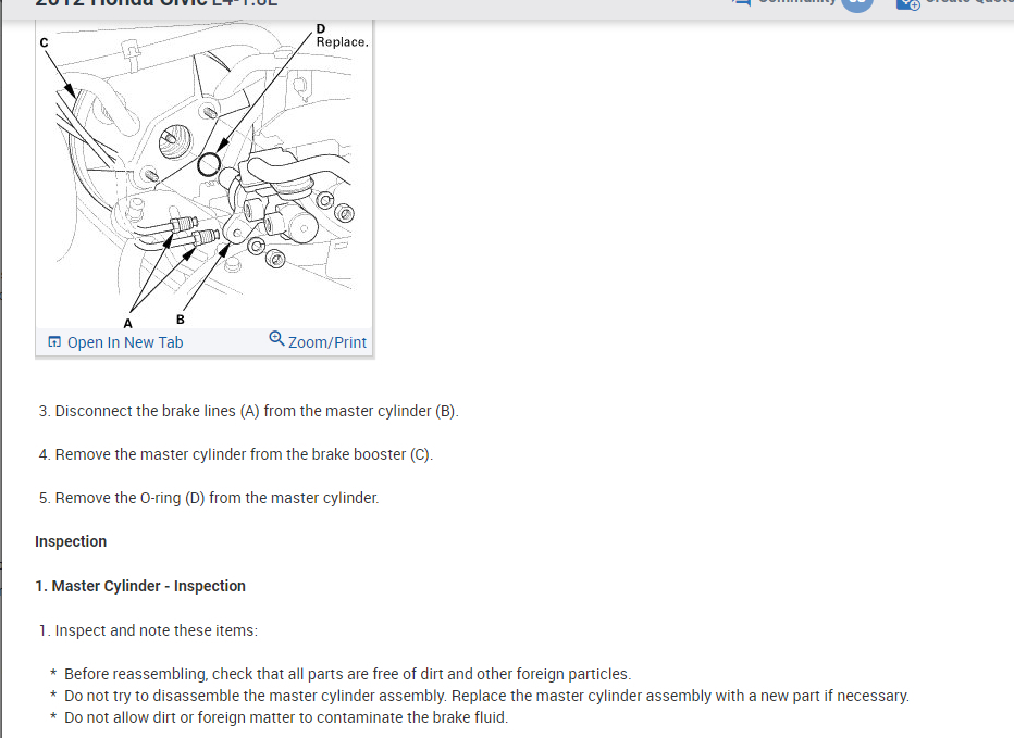

Based on what you have done, you most likely have a master cylinder issue. If you want to confirm this, disconnect the lines off the master and cap the ports. This will eliminate everything but the master so if the pedal goes to the floor the it is the issue.

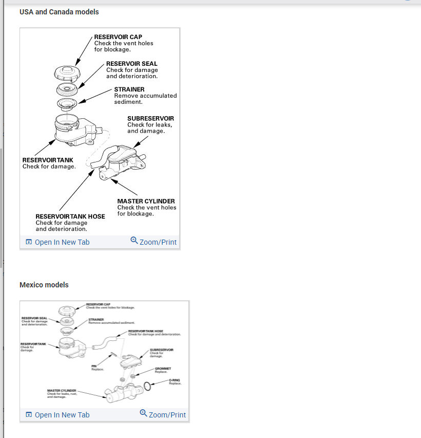

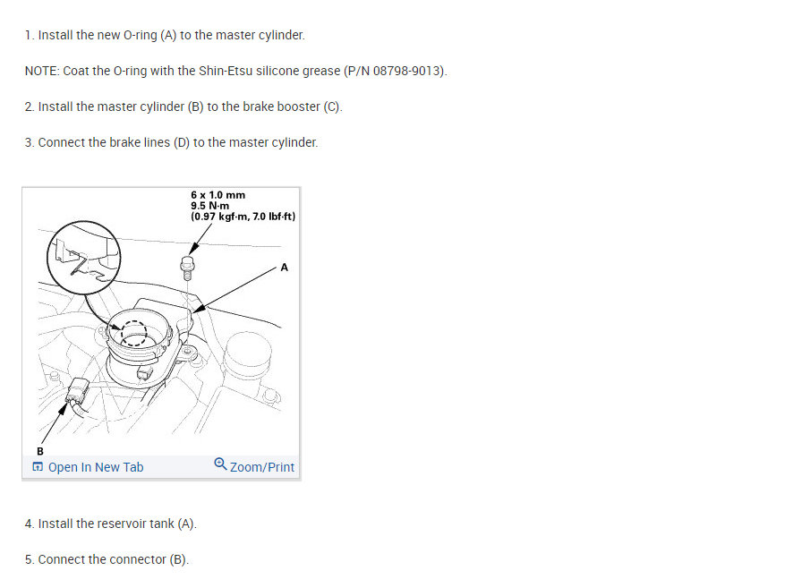

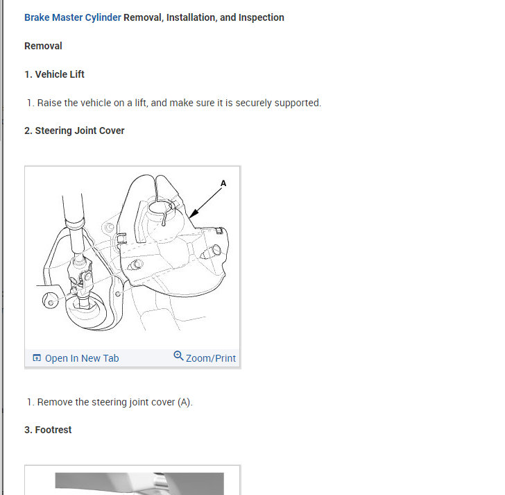

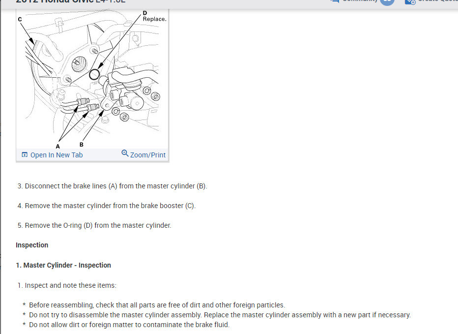

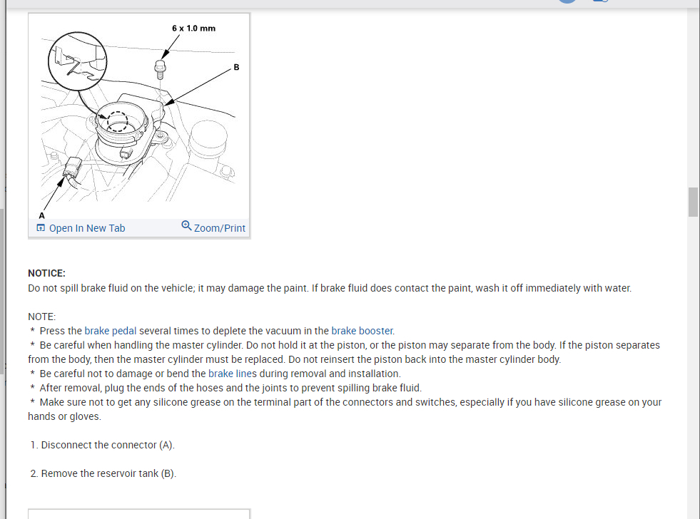

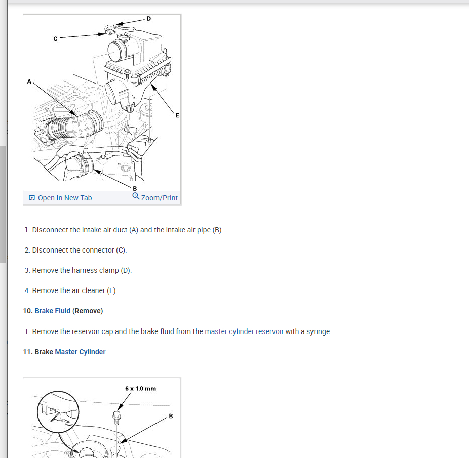

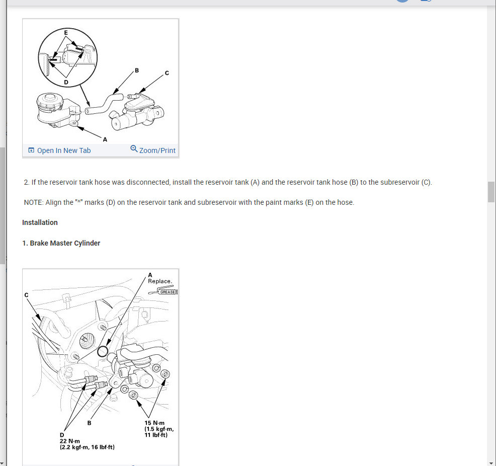

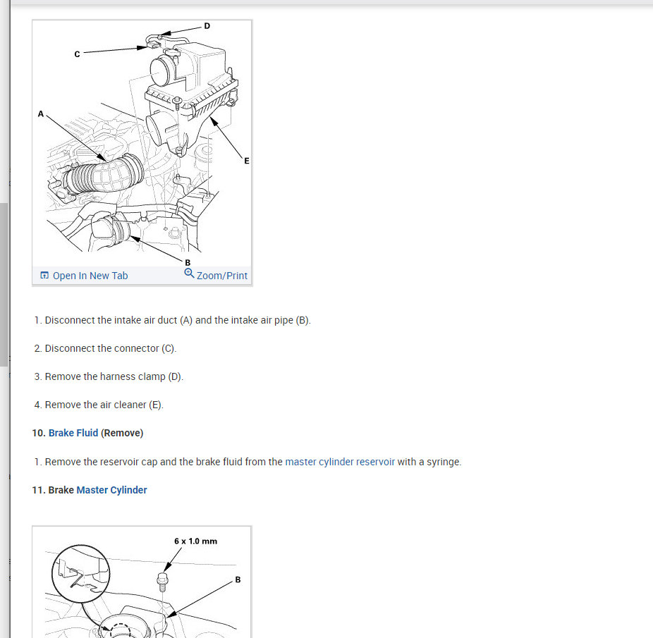

Here is a guide that will help with replacing the master cylinder as I suspect this is the issue.
https://www.2carpros.com/articles/how-to-replace-a-brake-master-cylinder

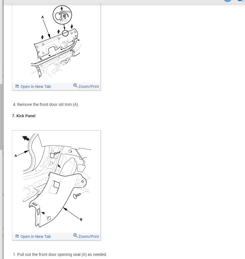

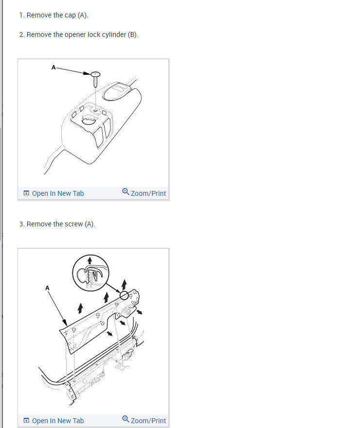

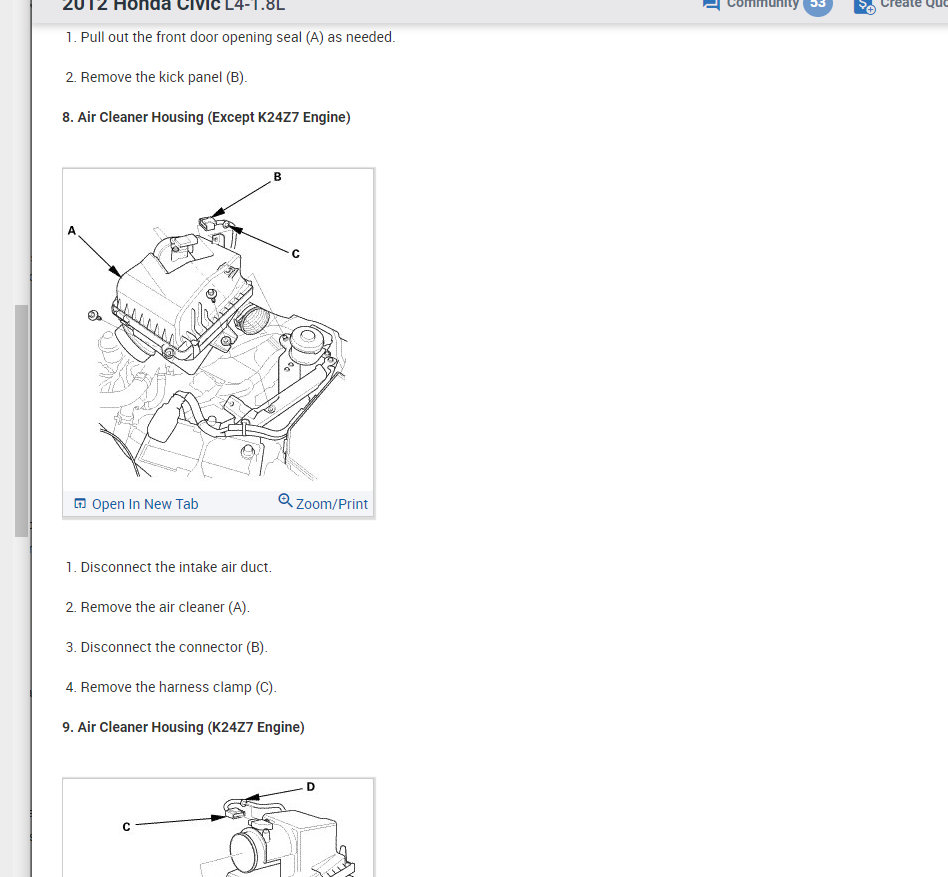

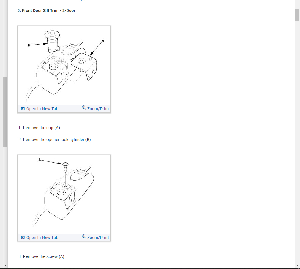

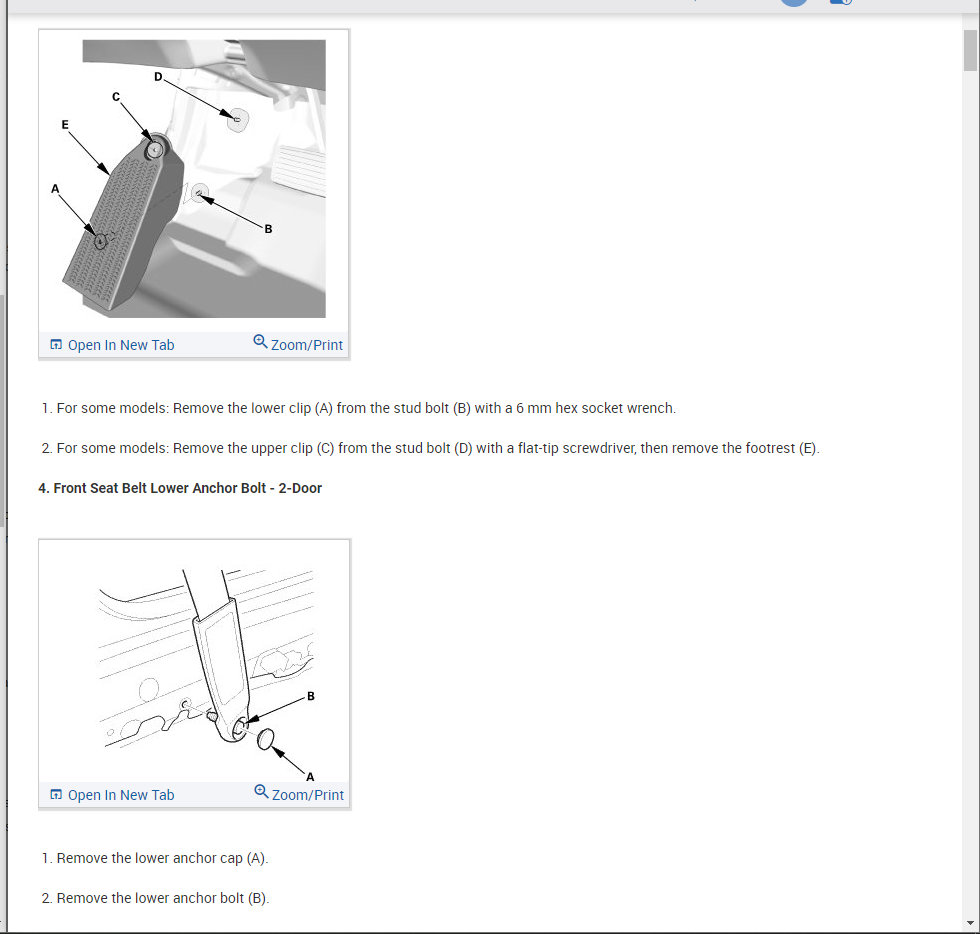

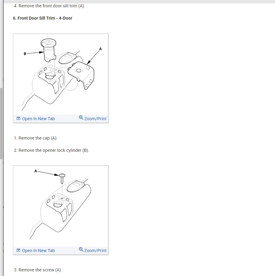

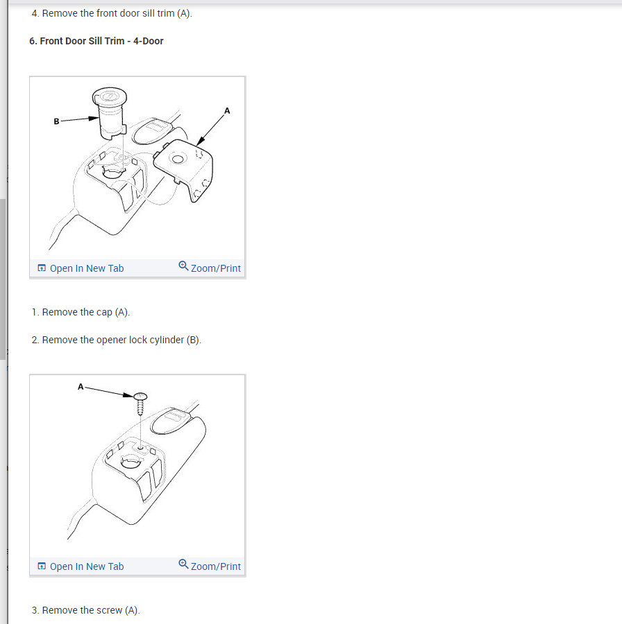

Below is the process from the manual on this. Please let us know if you have other questions. Thanks
