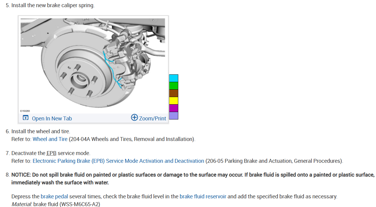

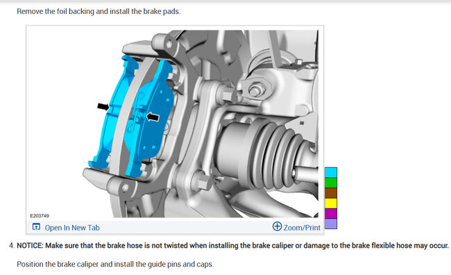

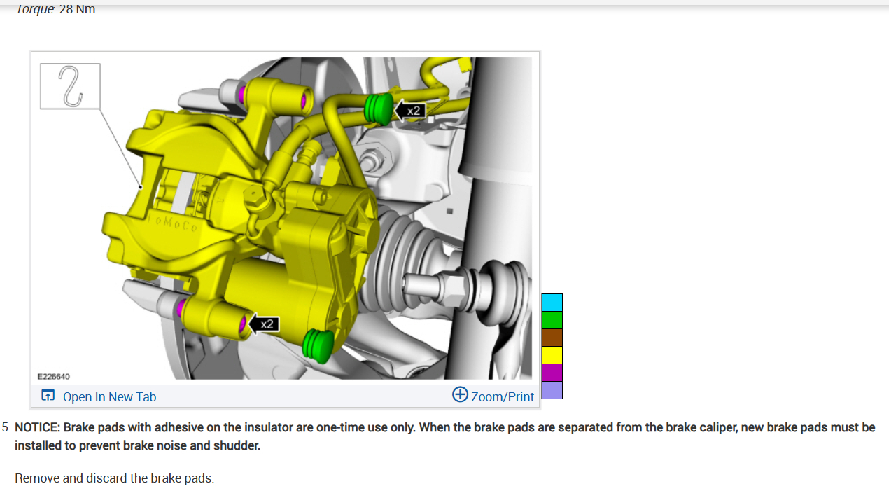

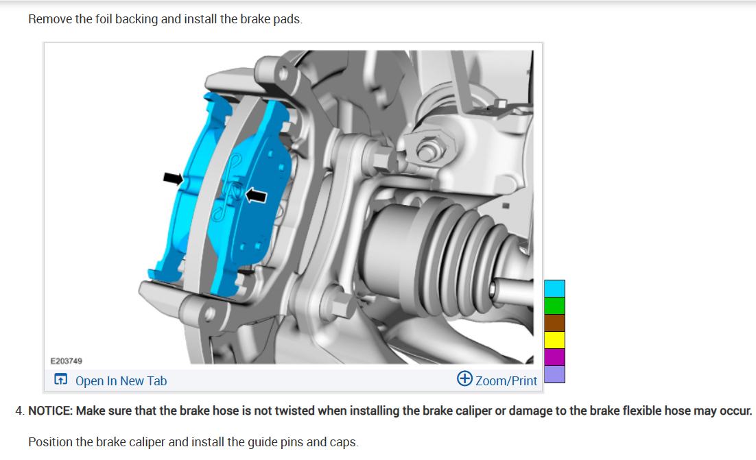

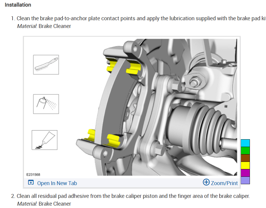

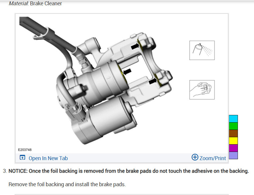

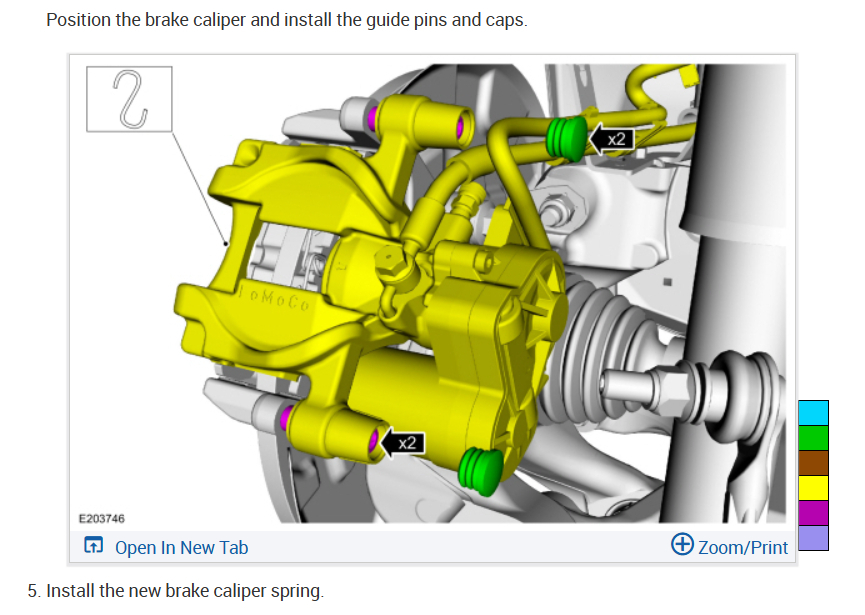

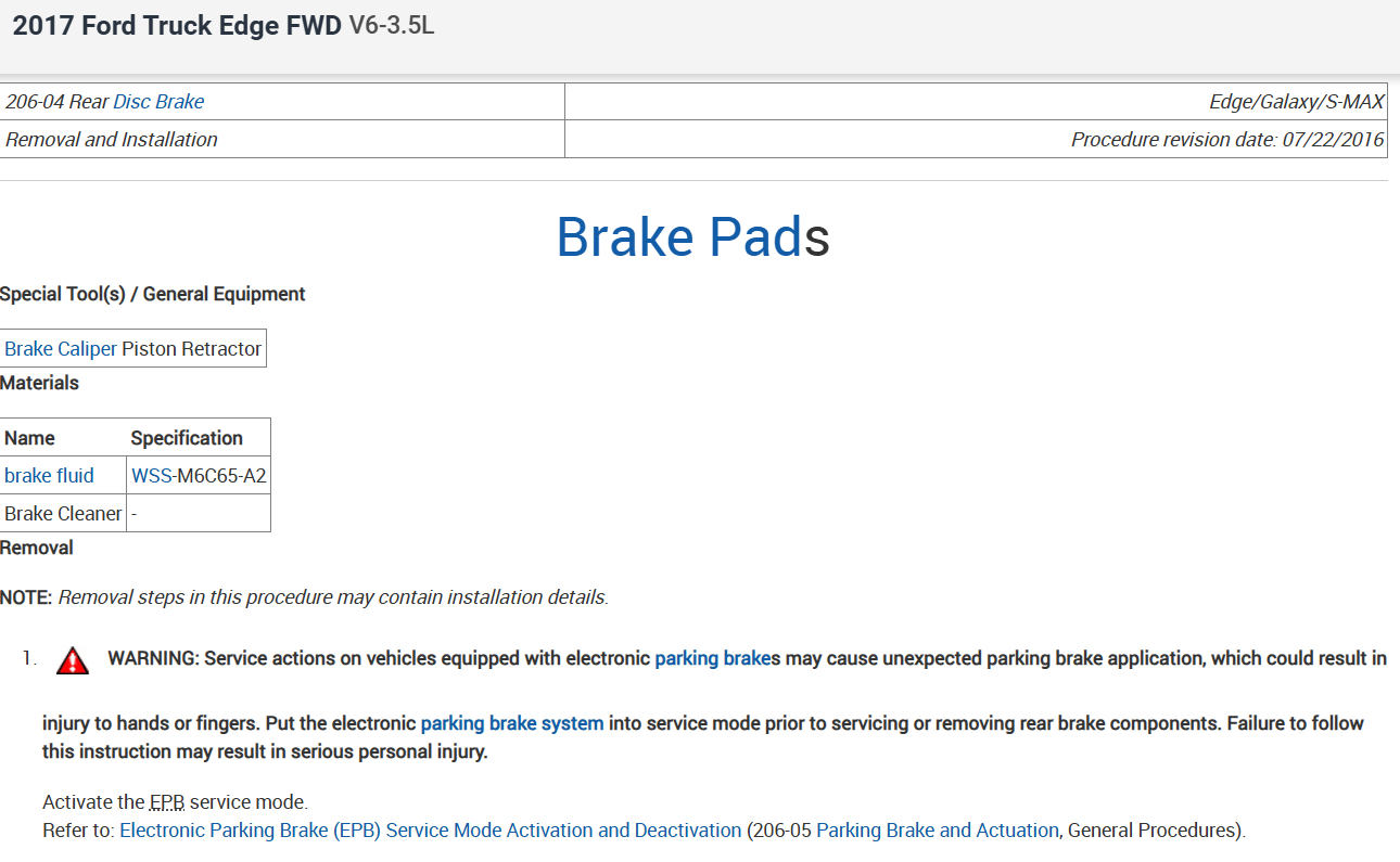

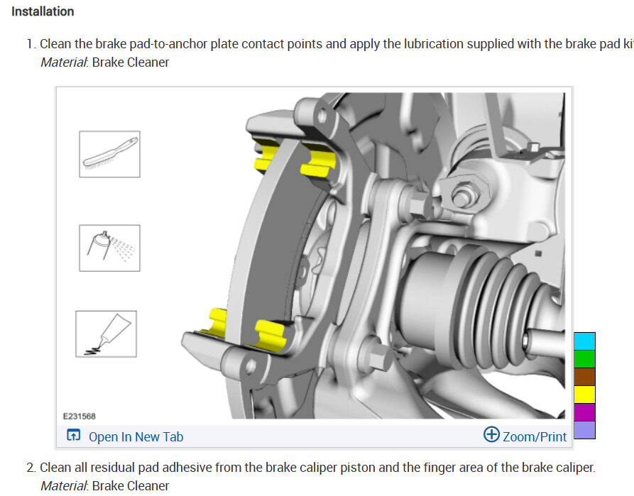

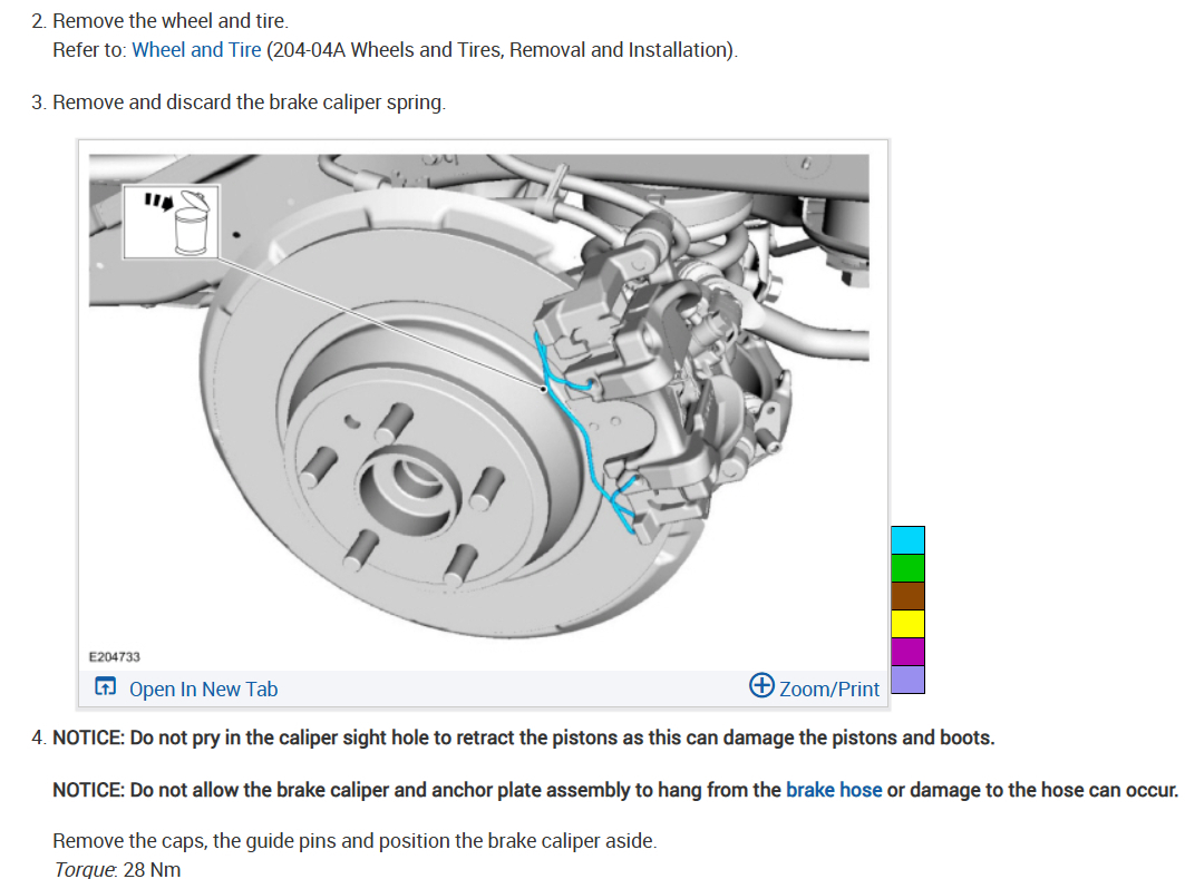

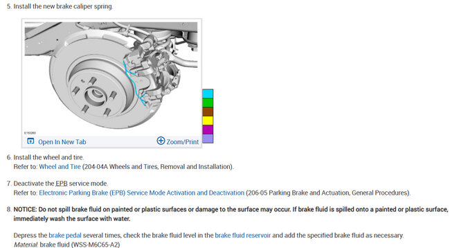

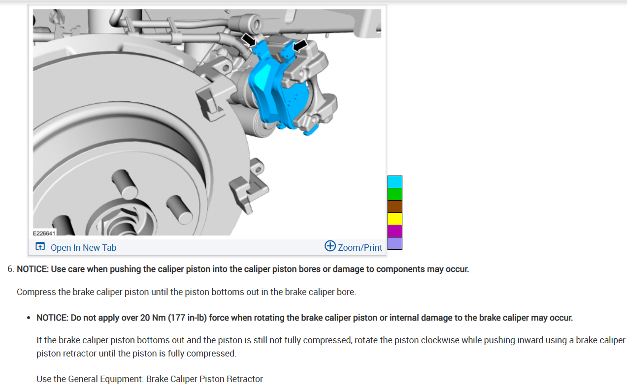

I would like to find a description of the torque measurements I need to replace the rear brake.
Nov 18, 2024 at 12:22 PM

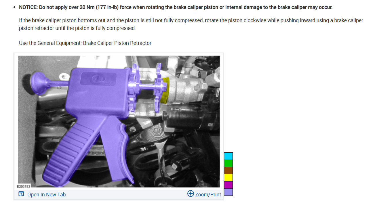

Here are the instructions on how to replace the rear brake pads with torque specs and I have a video of the job being done as well.
https://www.youtube.com/watch?v=CDe5xvG31HU&t
