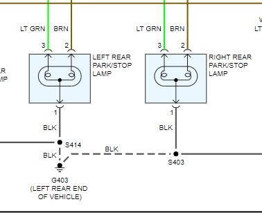

First, make sure there is power both to the switch and out of the switch when you depress the brake pedal. If there is, I need you to check ground. I attached a schematic of the brake lights. Note that both sides have the same ground. However, the third brake light has a different one. If the third brake light works and the tail lights don't, I suspect the ground.
Here are a few links that you may find helpful:
Also, check for power in the fuse box.
Take a look at this and let me know about the ground. Additionally, you mentioned that the signals are not flashing fast. Do the rear ones work?
