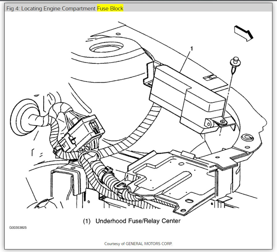

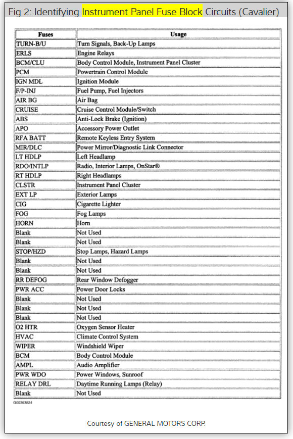

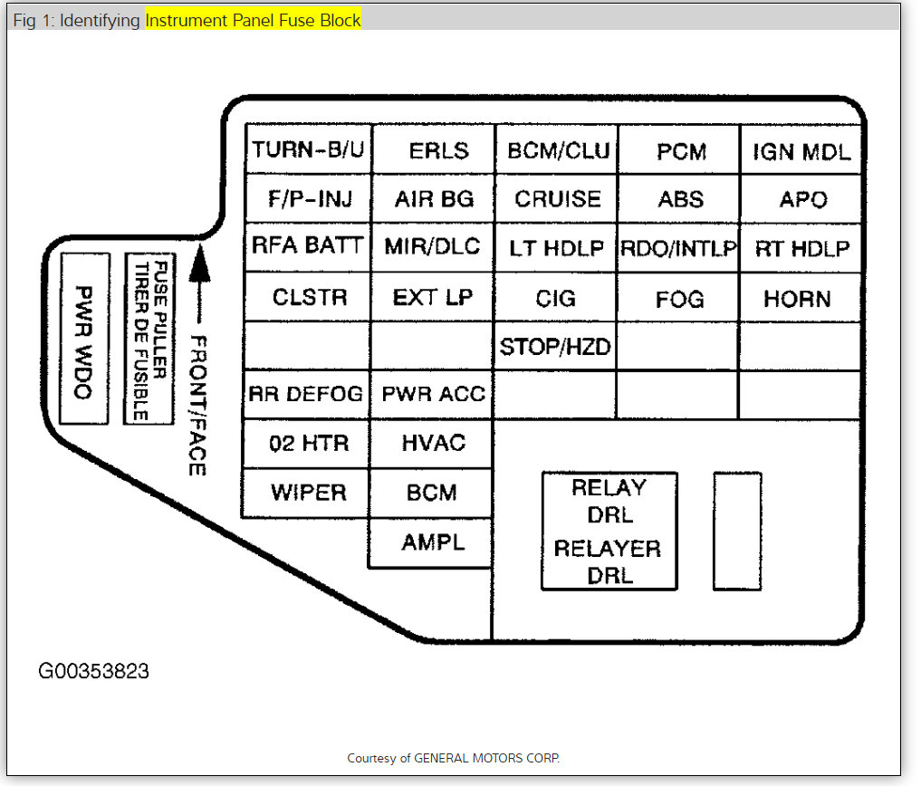

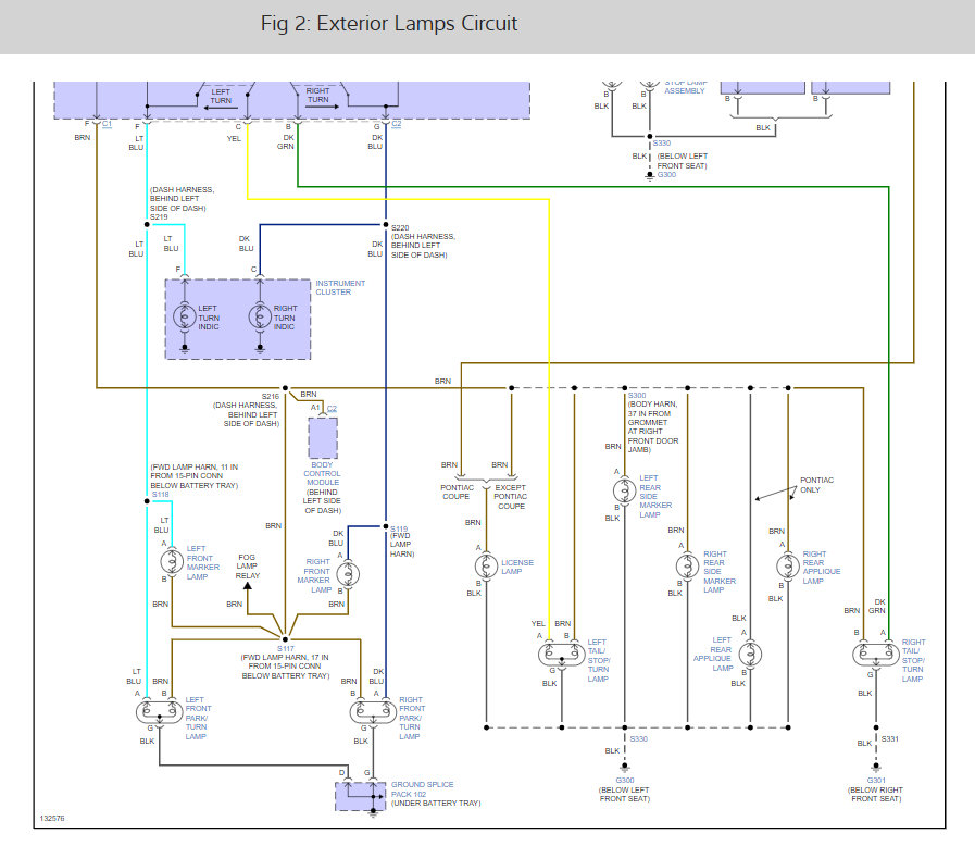

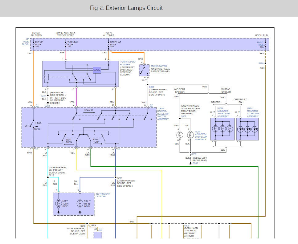

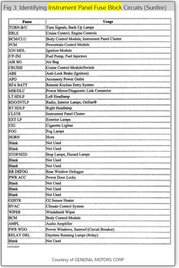

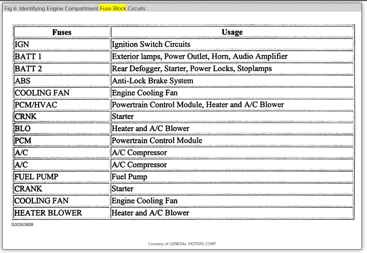

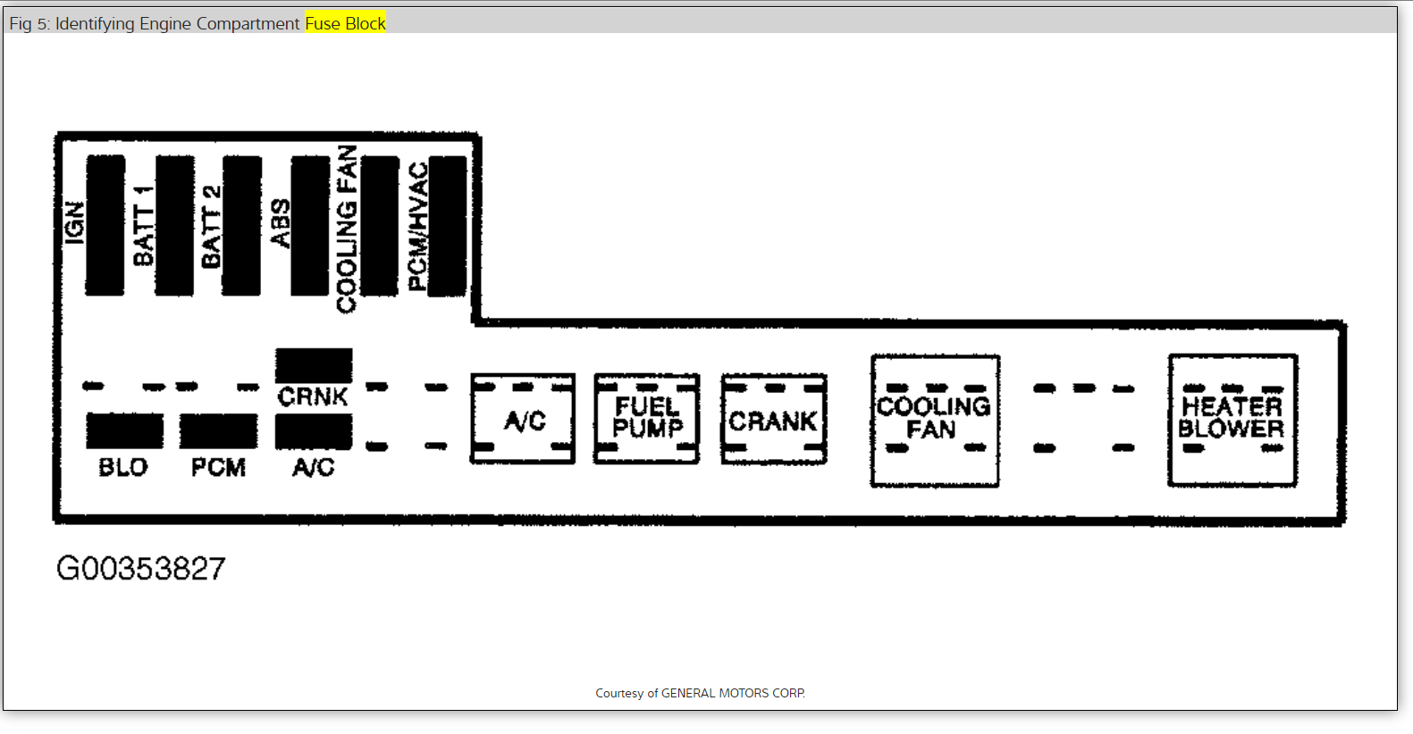

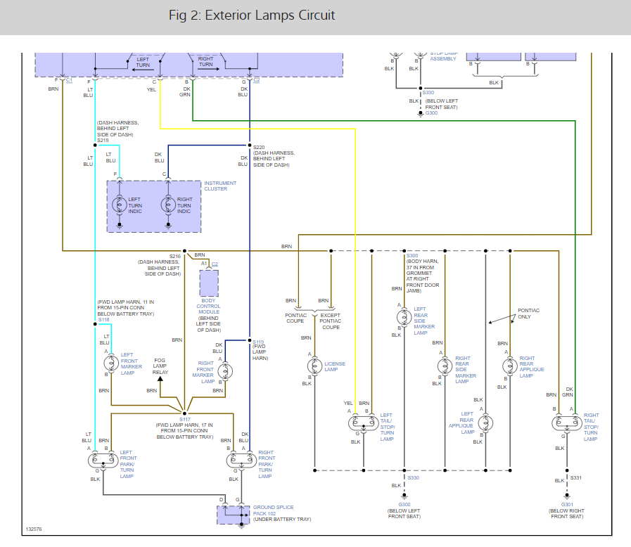

The first thing we need to do is check the fuses. here is a wiring diagram so you can see which fuses to check, and I have included a guide on how to check the fuses and the locations are in the diagrams below as well.
