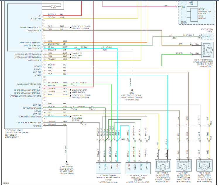

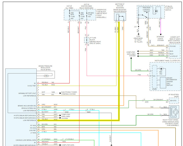

Since the brake lights are staying on it will definitely register a fault in the stabilitrac system.Brake light switches are not programmable.You will have to use a GM Tech 2 or equivalent scan tool to retrieve data/faults. I've attached below the brake system wiring diagrams if you want to inspect wiring for shorts/looseness/corrosion.I split the page in 2 pictures to appear larger.Hope this helps and thanks again for using 2CarPros.
