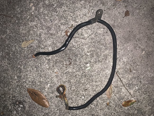

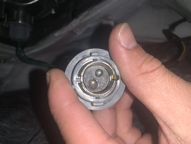

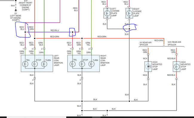

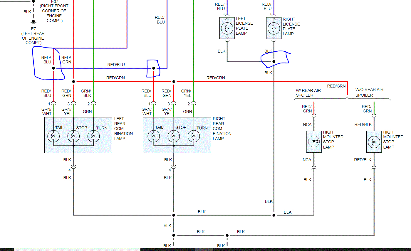

A couple of days ago I notice the top brake light staying on while not pressing the brakes only with the headlights on. when they off all the brake lights work fine. also the two bottom brake lights go off when I hit the brakes. I replaced the battery ground cable that was broken and a few months ago and the brake switch. before I notice the top brake light staying on and acting like one of the bottom ones I already had one on the bottom brake lights going off when hitting the brakes while headlights are on. Please help. I have also check all the fuses, I have follow all the wiring from the trunk to the fuse box and everything seems fine.
