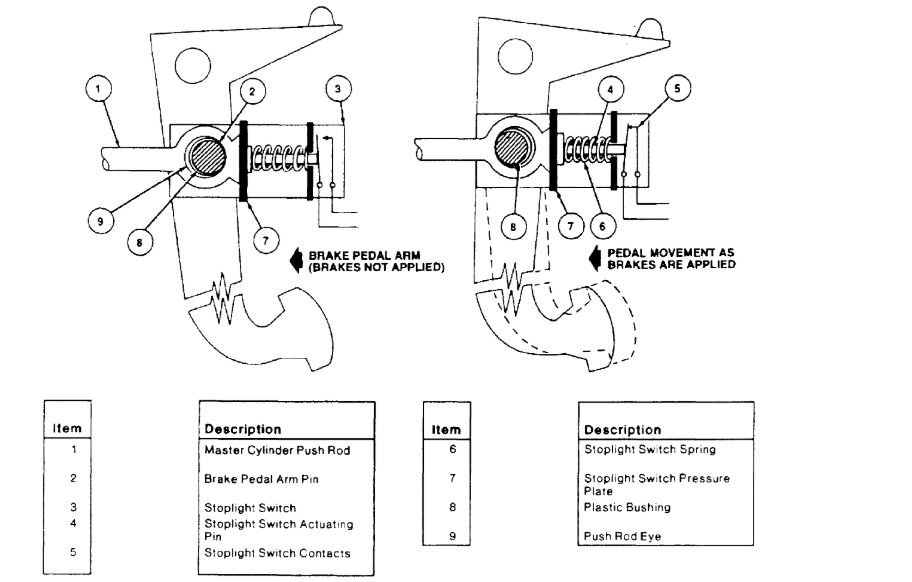

It could be the brake light switch. That switch also controls the interlock solenoid. It is not working, it will not allow shifting out of park.
Check the switch under the dash. It is right at the brake pedal and has an electrical connector. Make sure it is tight and clean and that the switch is free to move.
NOTE: Perform this test only when brake application will not disconnect speed control system.
1. Check stop lamp operation by applying approximately 6 lb of pressure to brake pedal. If more than 6 lb of pressure is required, check brake pedal actuation and stop lamp switch.
2. If stop lamps do not function properly, check stop lamp switch, circuit fuse or bulbs.
3. If stop lamps function properly, check for battery voltage on circuit 296 at amplifier six pin connector.
4. Depress brake pedal until stop lamps are lit.
5. Check voltage on light green lead (circuit 511) at amplifier 6 pin connector. Difference between this and voltage reading in step 3, must not exceed 1.5 volts.
6. If voltage difference is greater than 1.5 volts, a high resistance in circuit exists which must be found and corrected.
7. Perform Vacuum Dump Valve Test. See: Cruise Control > Component Tests and General Diagnostics > Vacuum Dump Valve Test
replacement procedure
1. Disconnect wires at connector.
Fig. 3 Stop light switch replacement
2. Remove hairpin retainer, then slide switch, pushrod and nylon washers and bushing away from pedal and remove switch.
3. Position switch so U-shaped side is nearest brake pedal and directly over/under pin.
4. Slide switch up/down, trapping master cylinder push rod and blade bushing between switch side plates.
5. Push switch and push rod assembly firmly toward brake pedal arm, then assemble outside white plastic washer to pin and install hairpin retainer to trap whole assembly.
6. Assemble wire harness connector to switch and install wires in retaining clip.
NOTE: Switch wire harness must have sufficient length to travel with switch during full stroke of brake pedal. If wire length is insufficient, reroute harness or service as required.
7. Check switch for proper operation.
