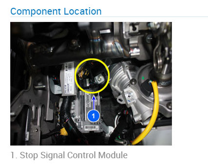

It's the stop signal relay assembly.
May 19, 2020 at 4:24 PM
Is that the issue or was the what you had a DTC for? Clearly that makes sense but I am just confirming you repaired it with that part or need more info. Thanks

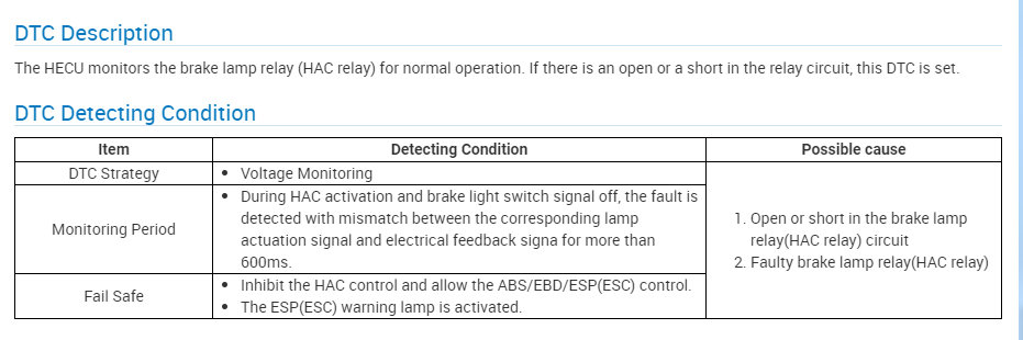

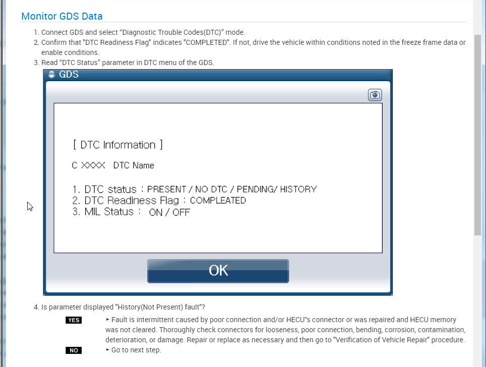

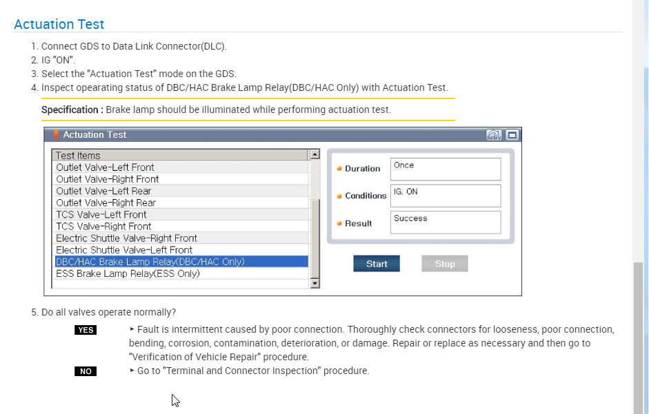

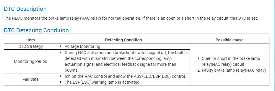

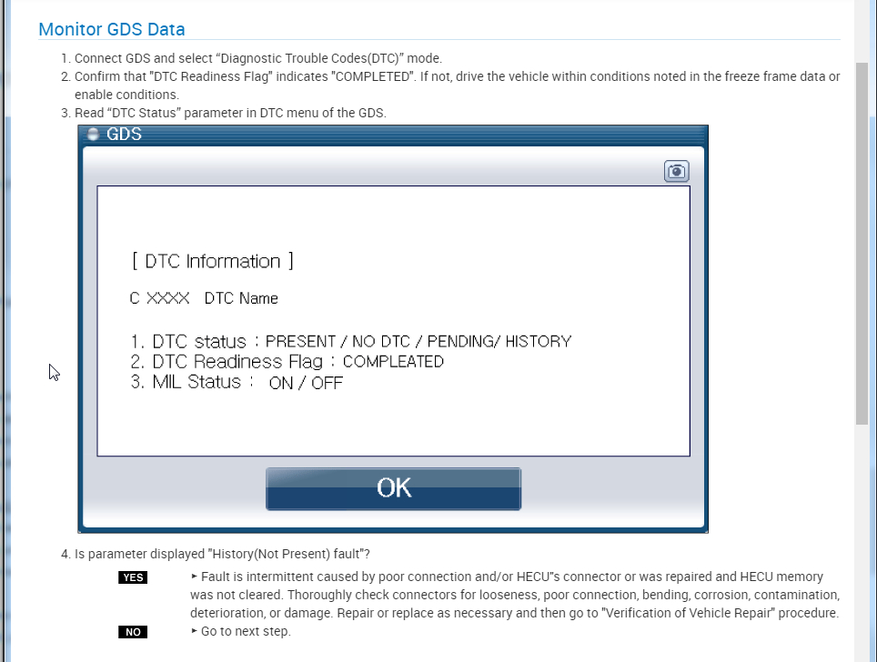

C2130 .
May 20, 2020 at 8:33 PM
Here is the info for this code. I just want to clarify if this was replaced and it fixed the vehicle or it hasn't been done yet? Thanks for the updates so far.
