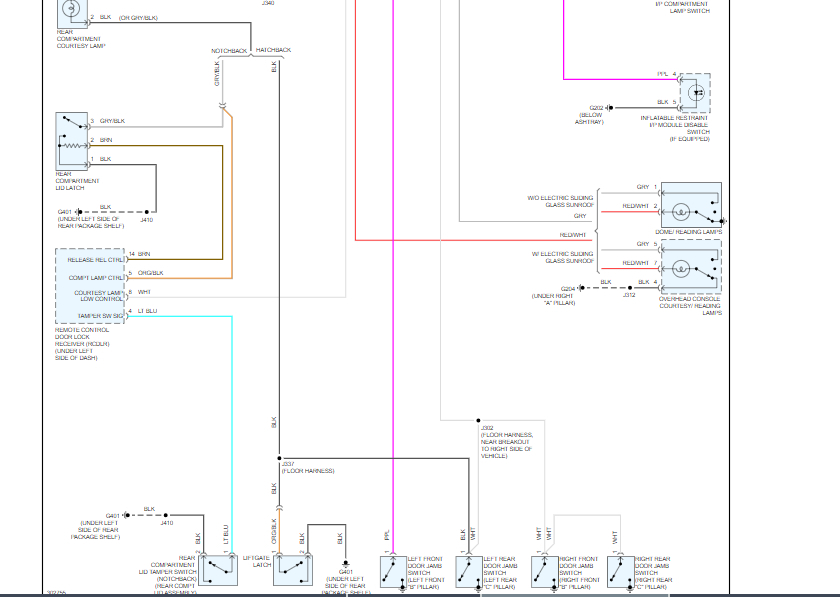

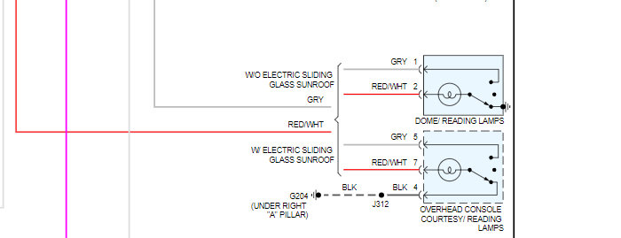

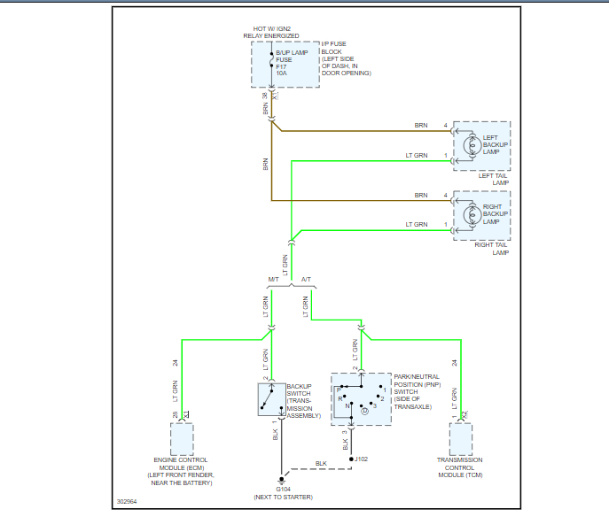

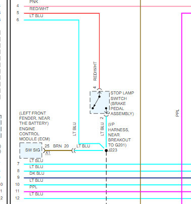

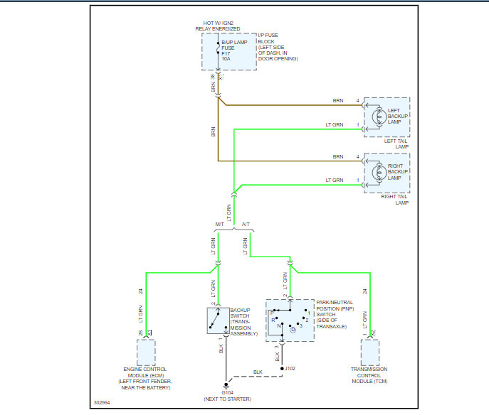

I attached wiring diagrams for you to view and when you get something to test with, we can continue to find the failure.
