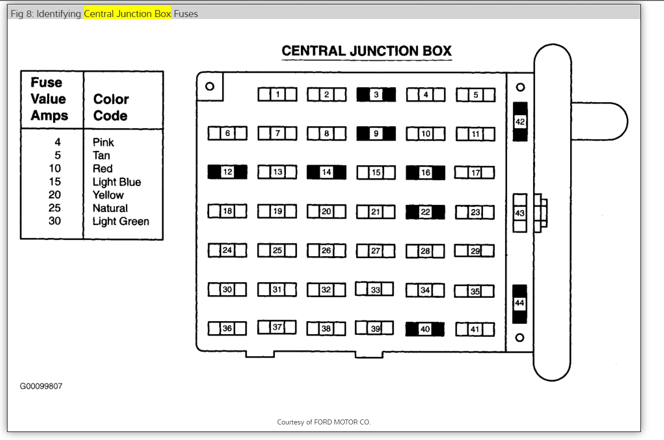

It does sounds like the light at the pedal but to be sure lets use a test light to find out for sure.

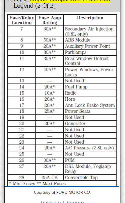

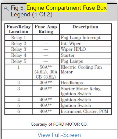

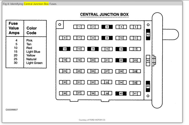

I would check for a loose fuse as well.

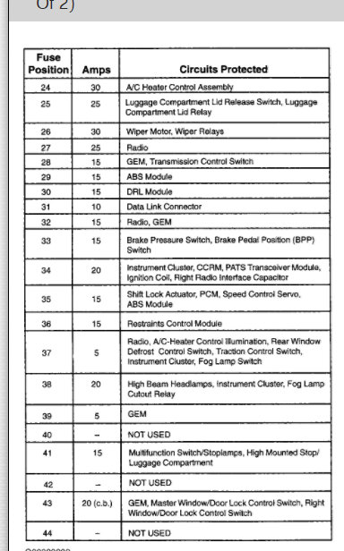

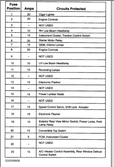

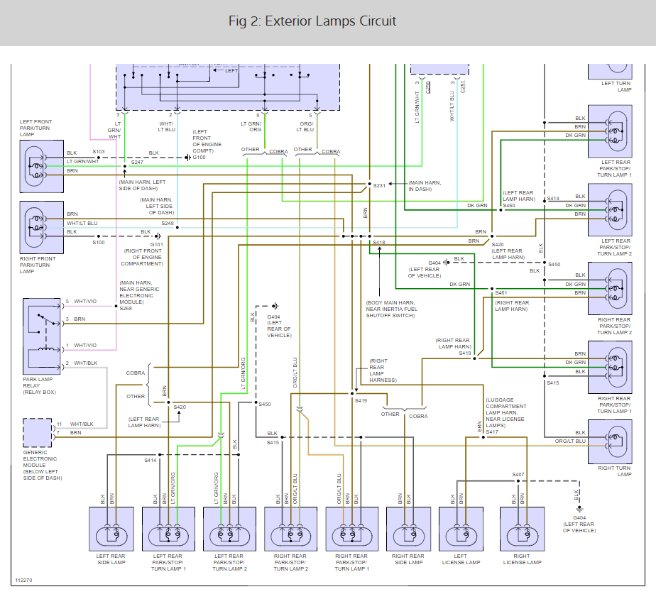

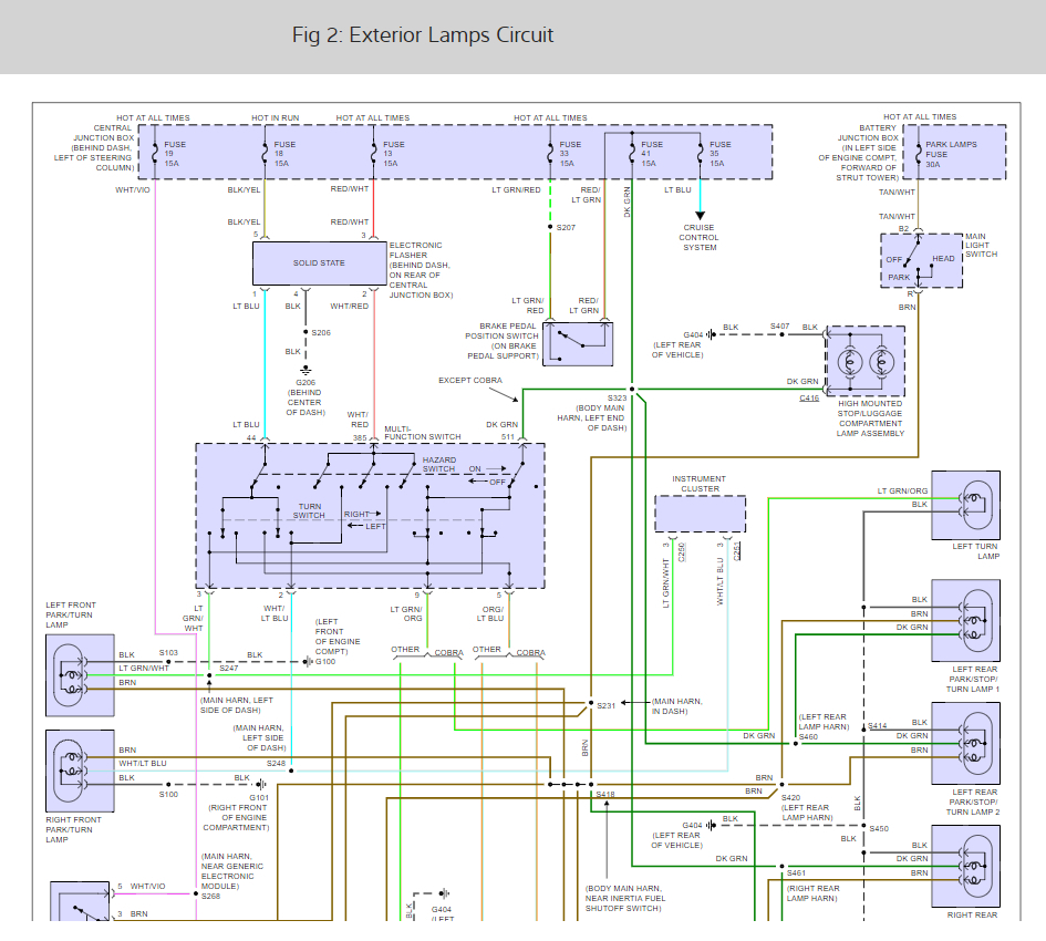

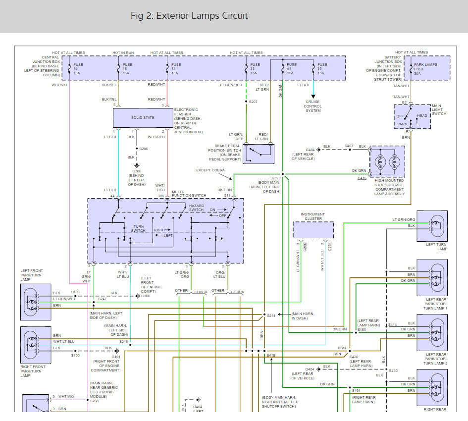

Here is a wiring diagram so we can see if the power is slow somewhere else besides the switch.
Check out the diagrams (below).

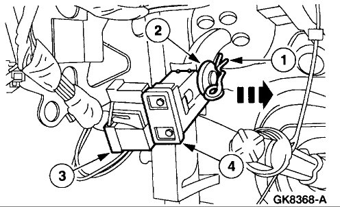

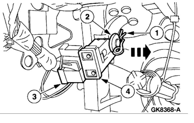

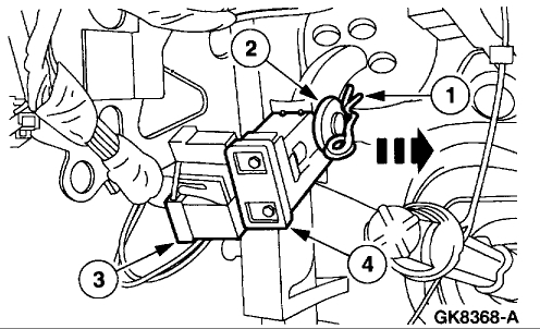

As they do light up but seem to need more pedal motion, I would look at the actual switch on the pedal first. It should not take much motion to turn on the lights.
Remove the clip number one, remove the retainer number two and remove the switch. Disconnect it and plug in the new one, put it back in place and install the retainer and clip.
