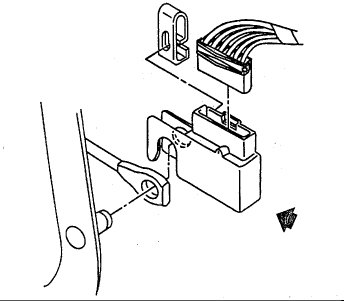

Since the upper center light does not work either would that indicate the brake switch on the pedal?
If so, how does that clip come off to remove the switch?

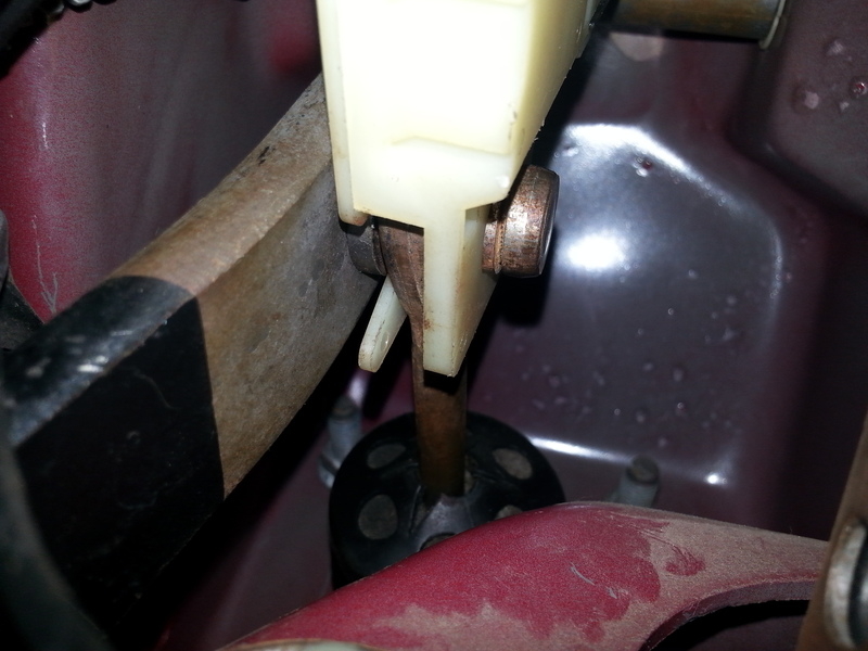

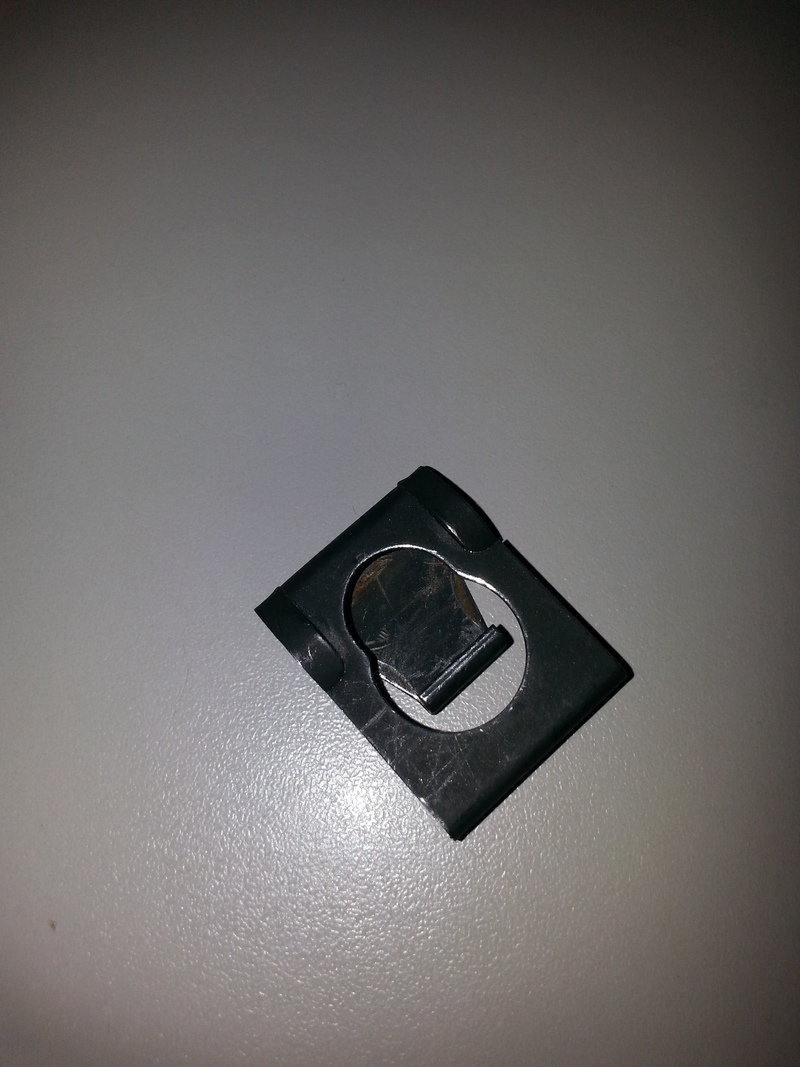

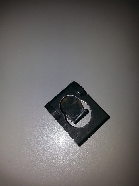

Yes, that would probably indicate a problem with the brake light switch. As for how to take that clip off, just stick a decent sized flat head screwdriver in the "U" end of the clip and turn it a bit to spread the "U" and then, while still keeping the screwdriver turned, slide the clip off. It may take a few tries, and is unnecessarily annoying, but it will come off. The images below decently illustrate what you are dealing with.
