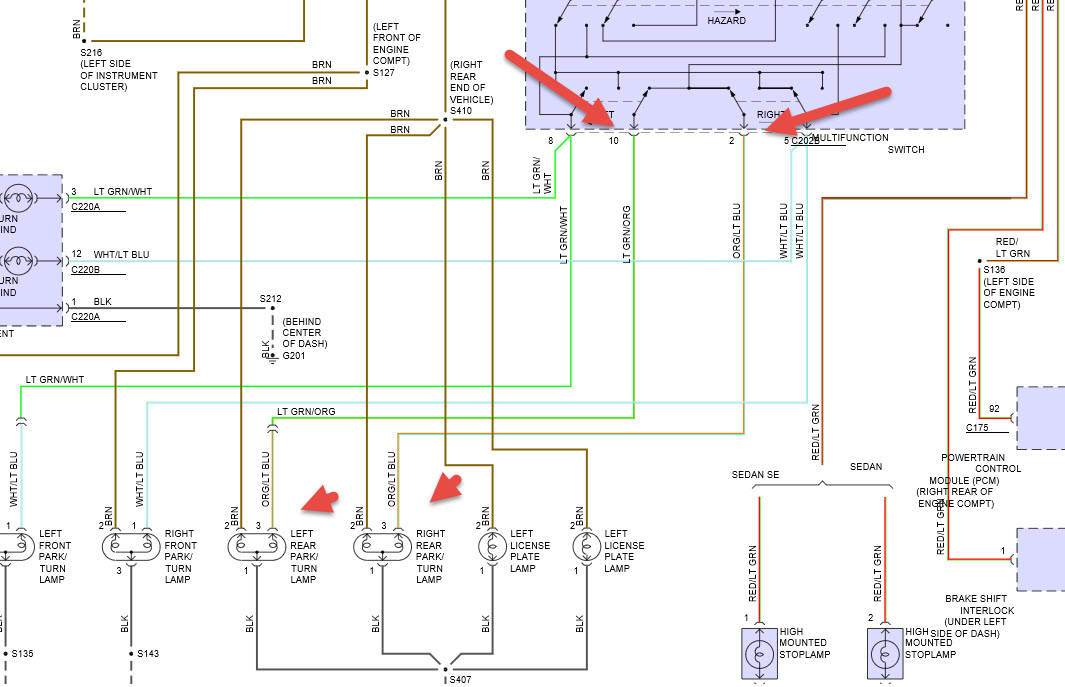

No bottom back brake lights, no turn signals or flashers. Replaced multifunction switch and brake pedal switch, check all fuses and they are good also replaced bulbs. Don't know what else to do.

check to see if power is coming from multi function switch in pic then if coming to lights. if goes out switch and not to lights then it's a broken wire if not going into switch which is re/lt grn then it may be a problem there . finally check ground wire connection right rear of trunk.

also check electronic flasher module in central junction box.
