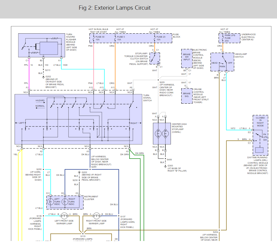

My brake lights do not work and my turn signal also do not work. All lights are fine all fuses are good, flashers do work.
Aug 24, 2018 at 8:31 PM
CERTIFIED EXPERT
53,854 POSTS

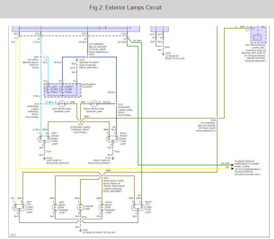

We are losing power somewhere which I think is the turn signal switch. Here is a guide to help you test for power and the wiring diagrams to help see how the system works:
