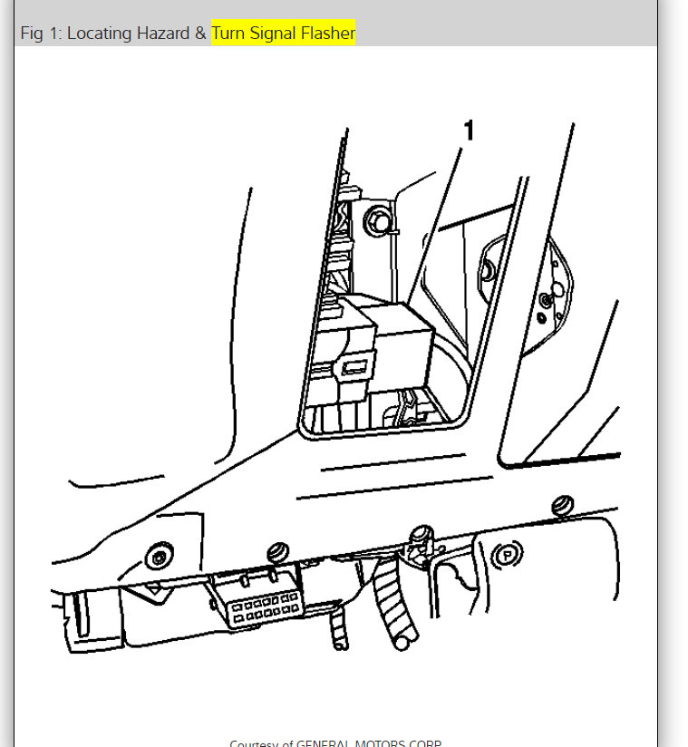

This is common when the flasher module goes out which is located on the drivers side. Check out the diagrams (below). Please let us know if you need anything else to get the problem fixed.
