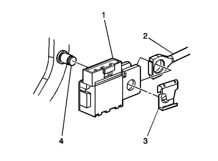

I would suspect the stop light switch as it controls the brake lights as well as the cruise control.
1. Remove the left sound insulator.
2. Remove the pushrod retainer (3) from the brake pedal pin (4).
3. Remove the stop lamp switch (1) and the pushrod (2) from the brake pedal pin (4).
4. Disconnect the stop lamp switch (1) electrical connector.
5. Remove the stop lamp switch from the vehicle.
