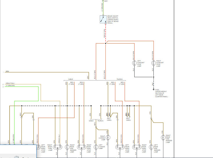

no brake lights but the third light does light up. replaced the combination/turn signal switch. tested the brake switch has power going in and when depressed power coming out, tested stop light fuse and bulbs all ok
Jan 27, 2019 at 11:30 AM
Good afternoon
The diagram I attached will show the wires from the brake light switch to the rear lights.
I would inspect the wiring from the switch to the rear of the car. Check for power at the rear sockets with the pedal pushed. If you have power, it could be either the socket, bulb or ground wire.
If you have no power, then you need to trace the wiring.
