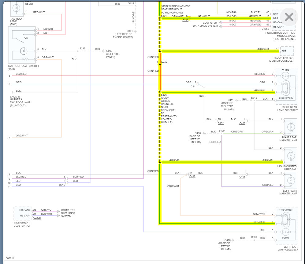

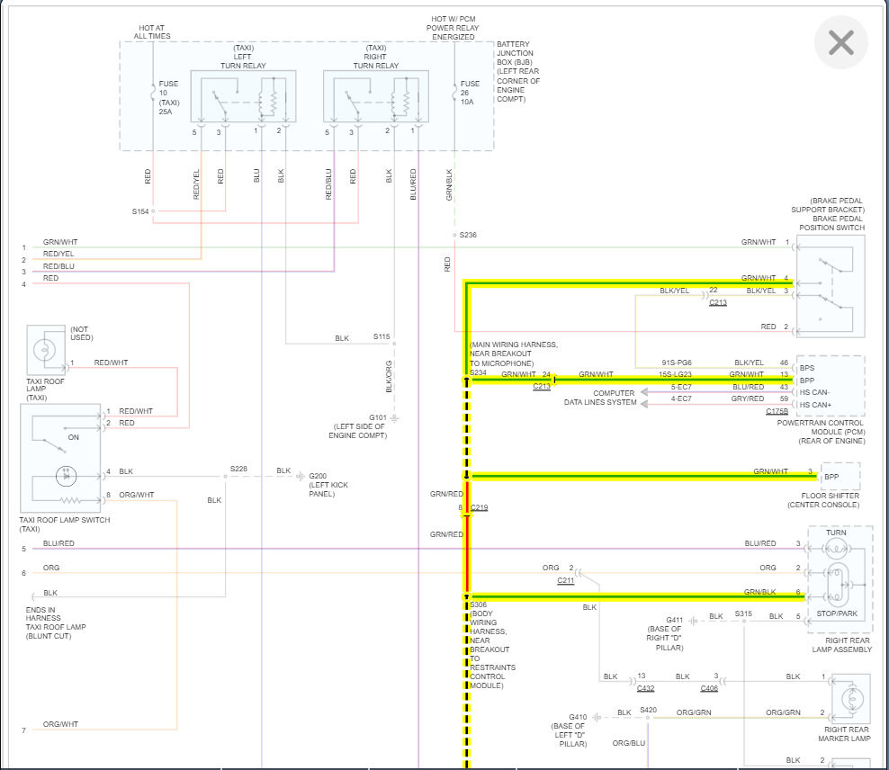

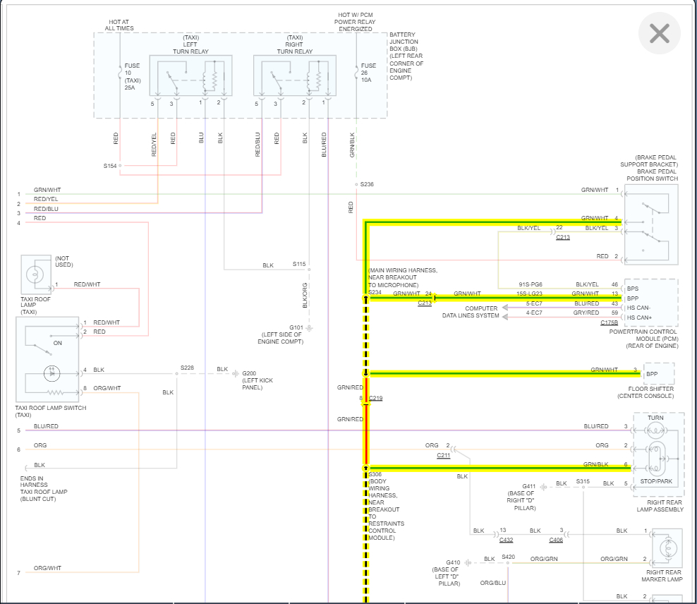

This could be a couple things, so we need to start with checking for power leaving the relay for this circuit.
Here is a guide that will help with testing this:
I attached the wiring diagram as well below.
Another question I have is I want to confirm you have a floor shift vehicle. If you do then is there any chance you spilled any drinks on the center console?
If so, then we need to check the connector on the console shifter because it could be shorted.
Please run through this info and let me know what questions you have on this.
