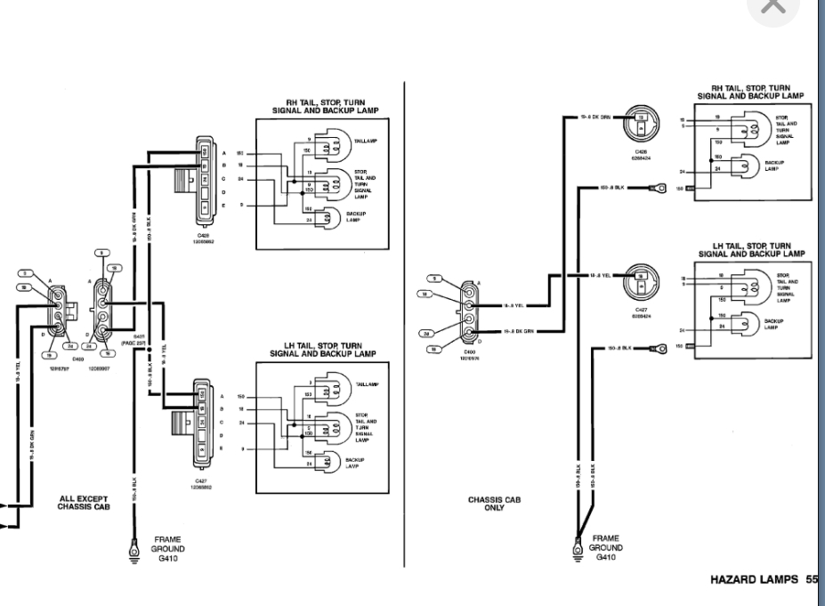

Below is the wiring diagram. We need to test the ground as well using this diagram and make sure it is clean and tight.
Let me know what questions you have. Thanks
