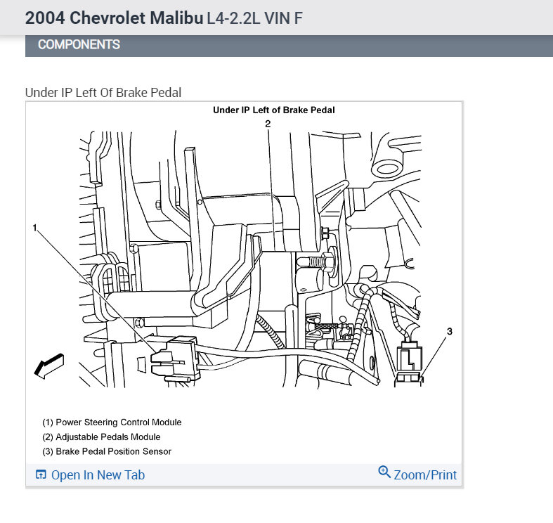

Sometimes my car won't come out of park after starting it. I shut it off and wait about 15 minutes then it will come out of park. They tell me it's the brake light switch. A diagram showing me where it is at would be helpful. Not just saying top of brake pedal. Thank you for your time.

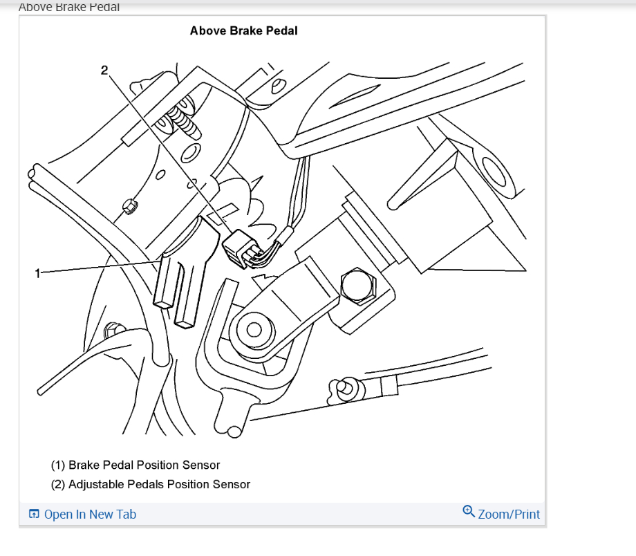

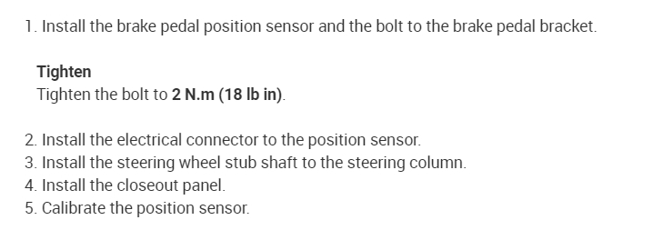

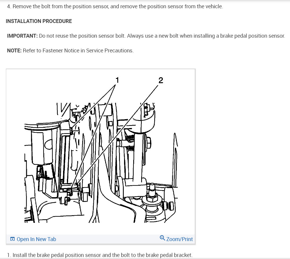

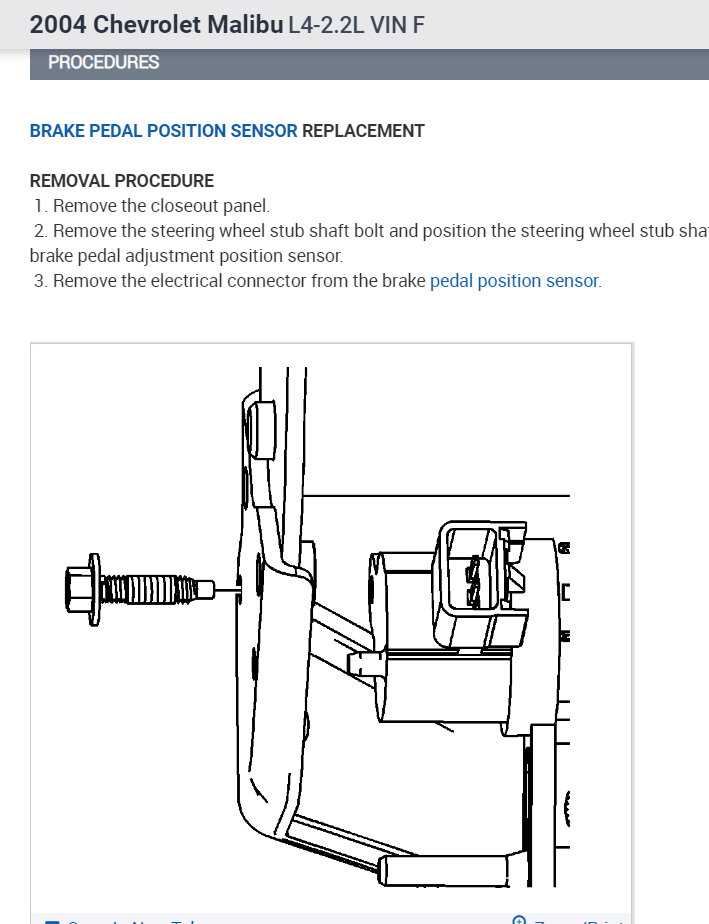

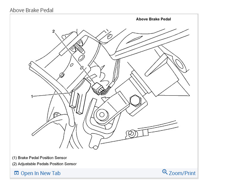

That does help, here is the location of the switch and how to change it out in the images below.

CALIBRATION PROCEDURE
- Install a scan tool.
- Turn ON the ignition, with the engine OFF.
- Select Diagnostics.
- Select the vehicle.
- Select Body and Accessories.
- Select Lighting Systems.
- Select Special Functions.
- Select BCM.
- Select the BPPS sensor calibration procedure and follow the directions displayed on the screen.
