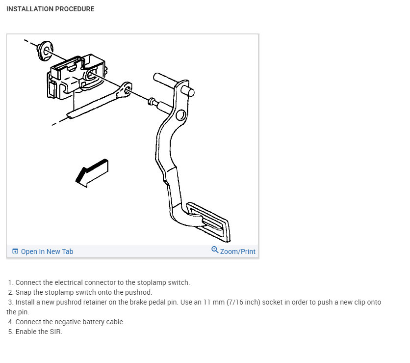

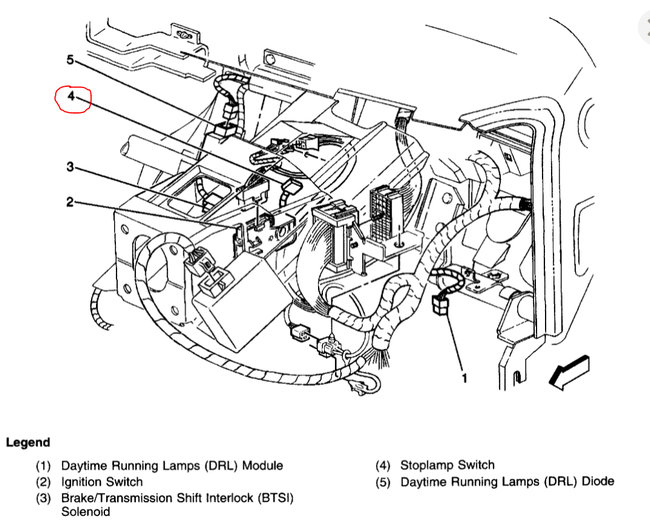

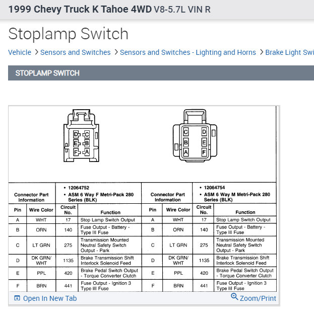

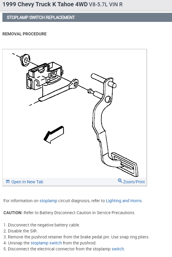

So, are you having hard time finding the actual pigtail that connects to the brake light switch or the harness is ripped out and cannot locate where it will go?
I have attached some diagrams showing the harness location.
Let me know if this is what you are looking for.
Thank you.
