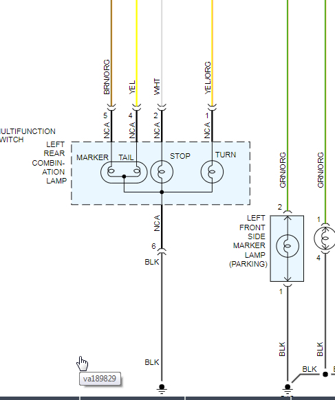

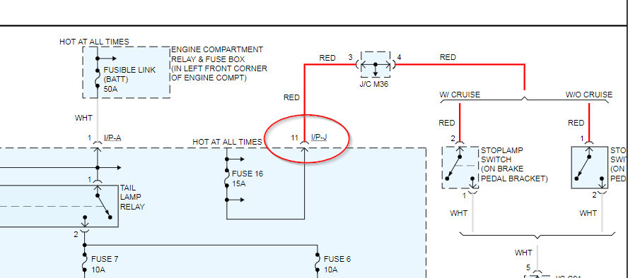

Greetings and well wishes.
Recently purchase the car listed above used (no cruise control).
Brake lights work properly when the running lights or headlights are off.
Brake lights illuminate brightly when the running lights or headlights are on as if the pedal is being pressed. There is no change in the brightness when the pedal is pressed while the lights are on.
Because I had recently bought the car, I checked all blade fuses.
I replaced both of the 1157's in the brake light socket.
I replaced the brake light switch up behind the pedal.
Short of removing the trunk liner, I see no evidence of a trailer harness. Nothing hanging or tucked away.
I have yet to replace an amber running light that's out on the front quarter panel and the '3rd' brake light bulb..
I have some experience, changing brakes, oil and such. I can follow detailed instructions.
So, where to next, the turn signal/headlight switch on the column? Something else?
Thank you, ahead of time.
~Rob V
