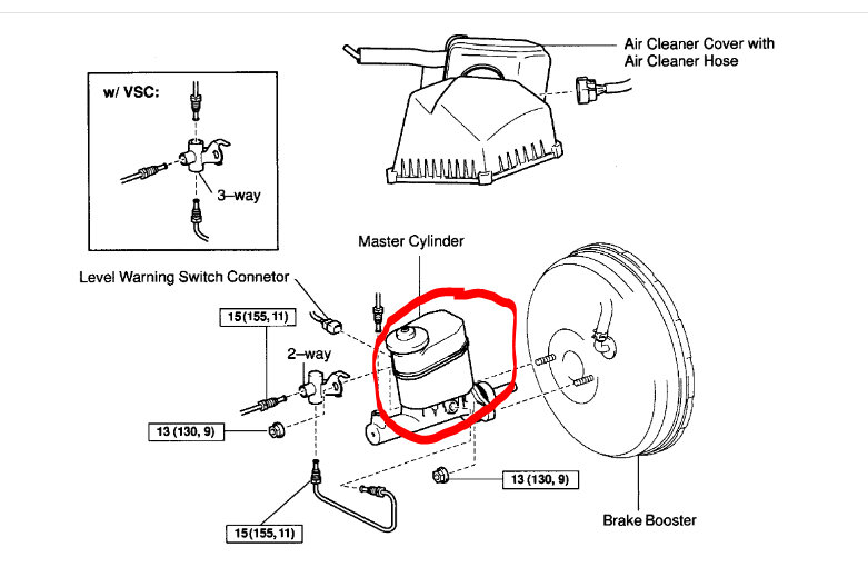

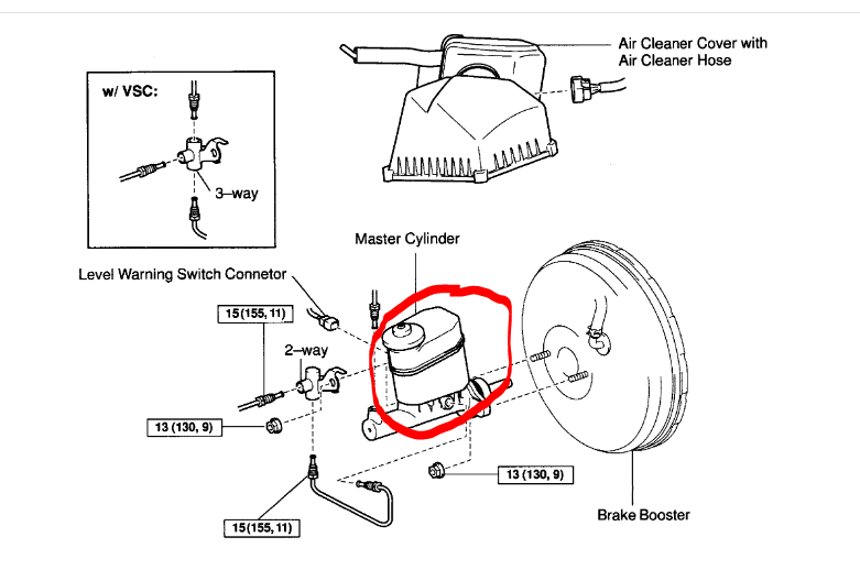

If it is only the brake light and not the ABS, first, check to make sure the brake fluid in the master cylinder is full.
When you open the hood, the brake master cylinder is on the driver's side of the firewall. See pic below.
Also, check to make sure the parking brake is fully released.
Check this first and let me know what you find.
See pic below.

Thank you for your response. It was the brake fluid, like you said.
