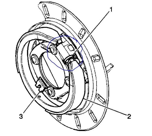

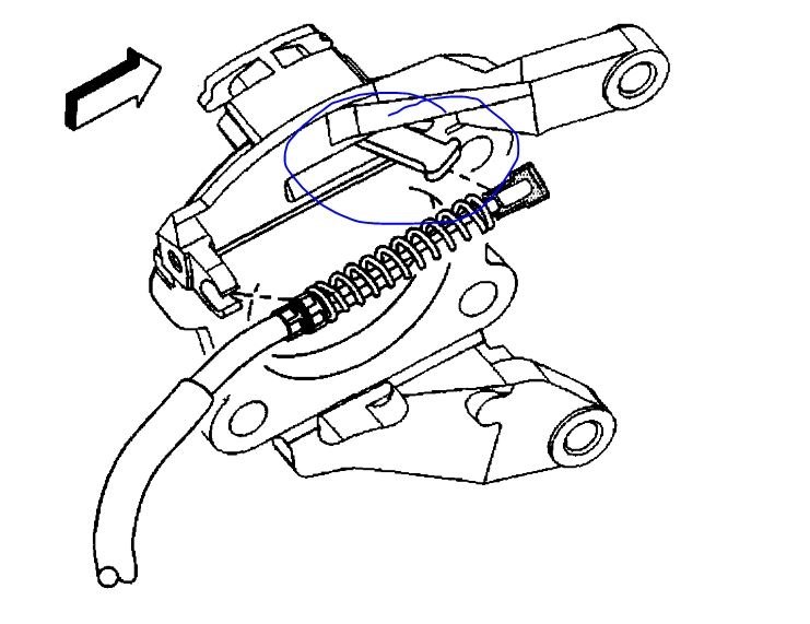

You will need to remove the caliper, rotor again.
Then you will be able to move the lever for the parking brake enough to attach the cable.
I attached a picture for you to view.

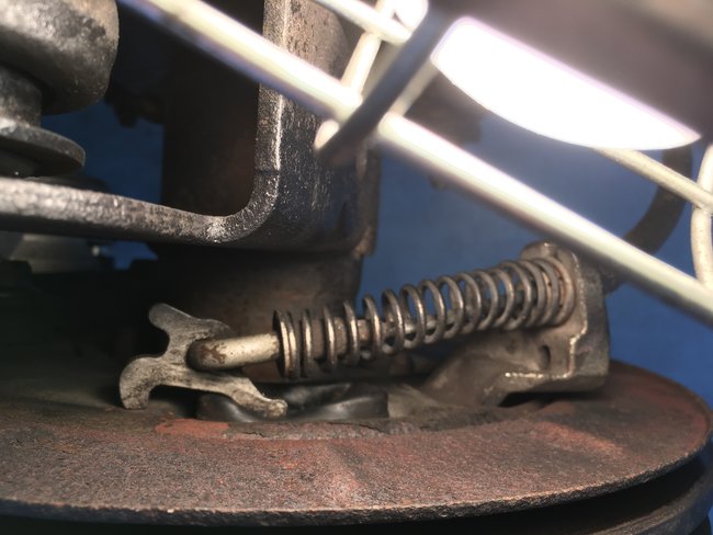

This is mine. Don't know why it popped out or how to put it back together? It is a z71 4wd if that makes any difference. Thanks for your help.
Mar 16, 2021 at 9:59 AM
Yes, that is what I posted. The cable is around the wrong part of the lever. The lever needs to be install again and the cable end attached on the far side of the lever.as I attached.

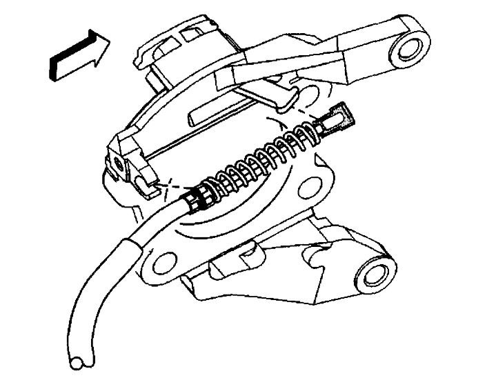

I have attached 2 pictures. One is for the actuator for the hand brake and one is the rear of the actuator where the lever comes out. That lever needs to be set inside the actuator itself and then the cable attached as I described before. If the lever does not attach then the actuator will have to be replaced.
