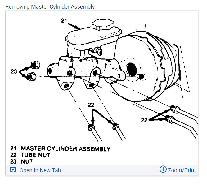

Yes, it does sound like the brake master cylinder has gone bad and is bypassing back into the reservoir. Here is a video to show you how to bench bleed the new master before you install it:
https://youtu.be/WDxvEQrMkBg?si=psOGuskYW_k8QDHU

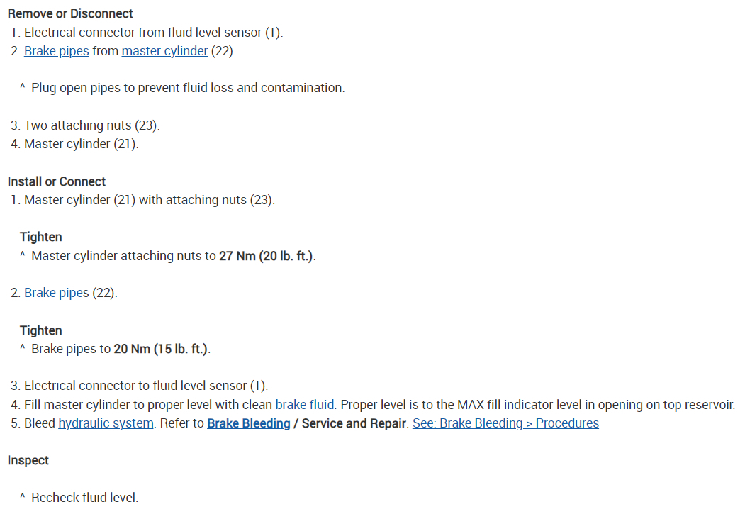

Here is a guide to help walk you through the steps with instruction in the images below to help you with your car:
https://www.2carpros.com/articles/how-to-replace-a-brake-master-cylinder

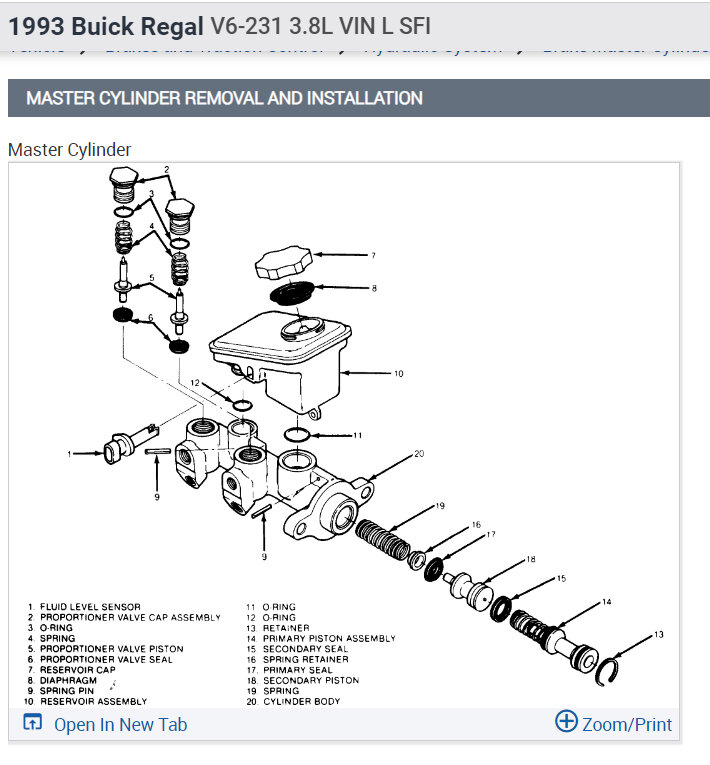

Because this master cylinder has four ports you may need to plug the two lower ports for bleeding or use four bleeder tubes. Check out the images (below). Please let us know what happens.
