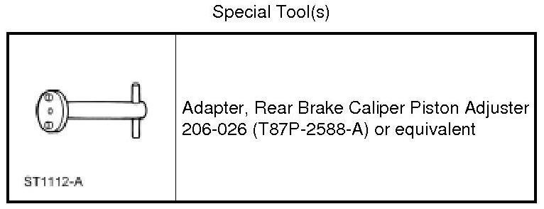

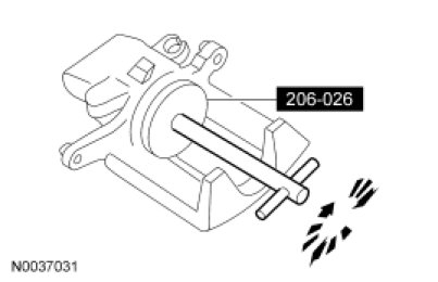

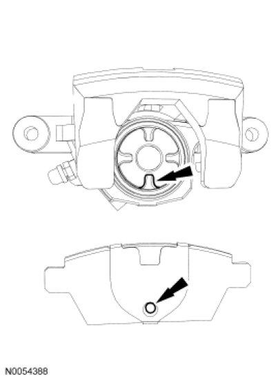

1. Using the Rear Brake Caliper Piston Adjuster Adapter, compress the brake caliper piston into the brake caliper bore.
pic 3

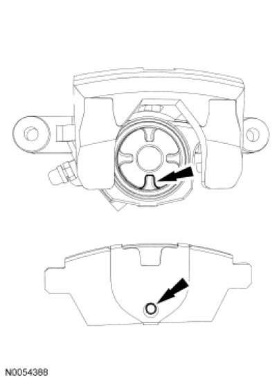

2. Position the notch in the caliper piston up and down to align with the alignment pin on the brake pad.

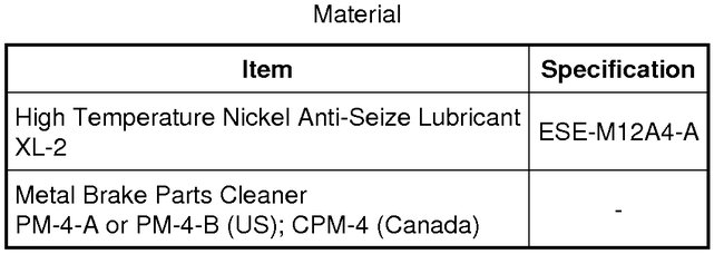

3. NOTICE: Do not allow grease, oil, brake fluid or other contaminants to contact the pad lining material, or damage to components may occur. Do not install contaminated pads.
NOTE: Install all hardware supplied with the pad kit.
Install the 2 new spring clips and the brake pads.
pic 4

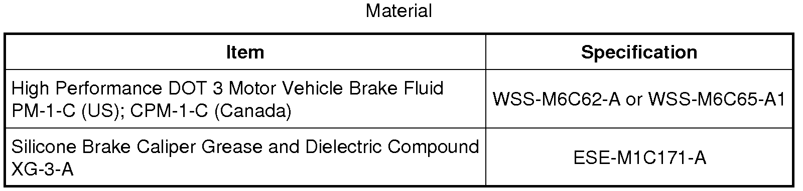

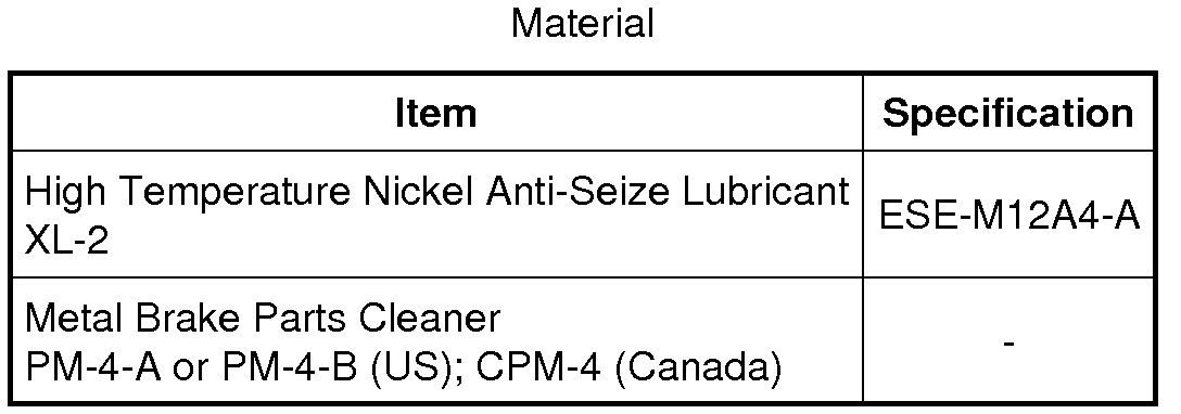

1. Clean any rust or foreign material from the brake disc and the wheel hub.
- Use the specified brake parts cleaner to clean the brake disc and hub surfaces.
2. NOTICE: In order for the brake caliper anchor plate bolts to attain the proper clamp load when installed, the residual threadlock compound must be cleaned out of the bolt threads of the anchor plate.
Clean any residual threadlock compound, and any other foreign material, from the threads of the brake caliper anchor plate.
3. NOTICE: Do not allow the lubricant to make contact with the wheel studs, brake pads or brake disc or damage to components may occur.
Apply a thin coat of the specified anti-seize lubricant to the hub flange.
