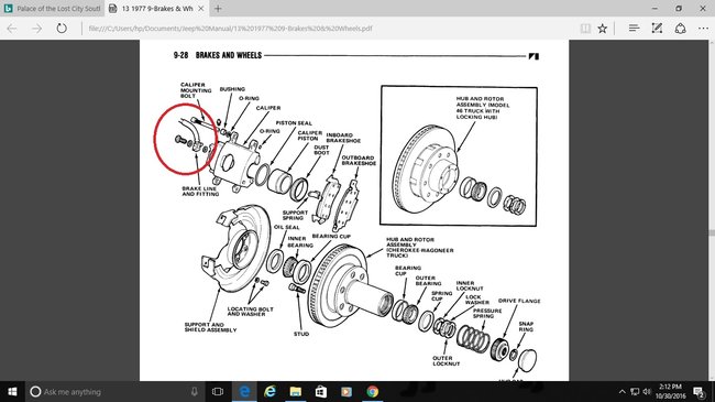

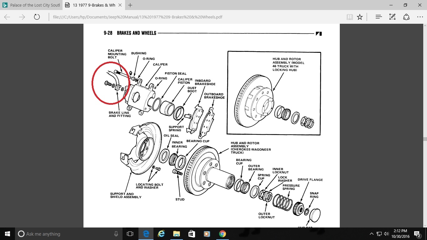

Usually there is a copper washer on both sides of the brake line fitting. They sort of squish-n-seal when the bolt is tightened.
I could ot find a picture for yours, below is a diagram for a Jeep CJ, more than likely the same sort of setup.
Let us know how it goes.

Thank you! The bottom washer must have fallen off when I replaced the caliper. I will get new washers.
Thanks again!

Every now and again you will find new ones in with the new caliper.
