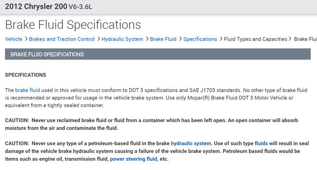

What type do I need dot 3 or 4? Car listed above lx model.

I have included the information that you have requested in the diagrams below. Check out the diagrams (Below). Please let us know if you need anything else to get the problem fixed.
