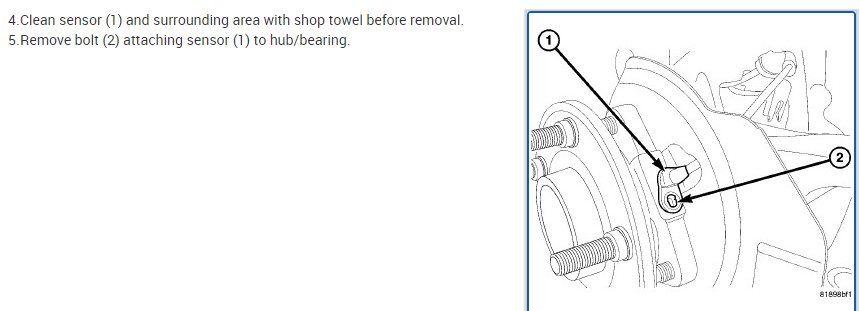

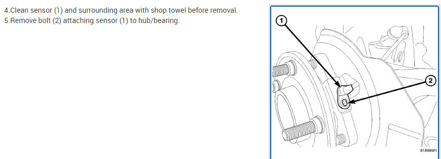

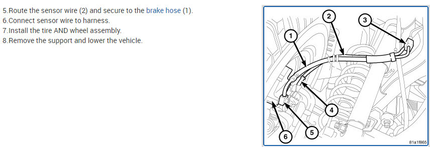

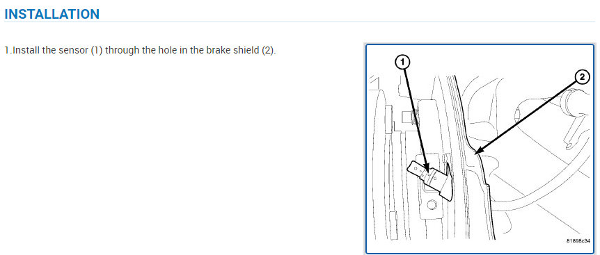

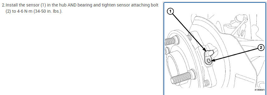

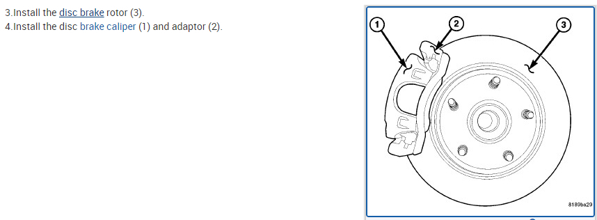

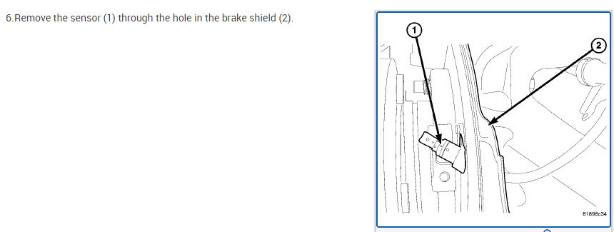

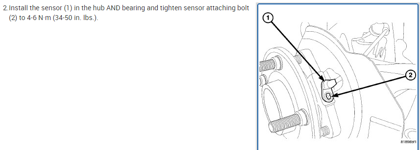

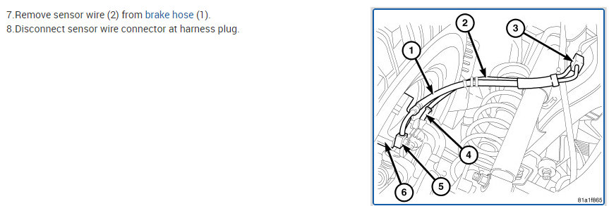

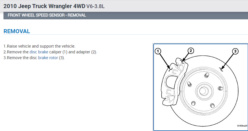

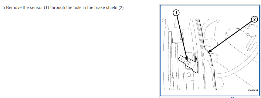

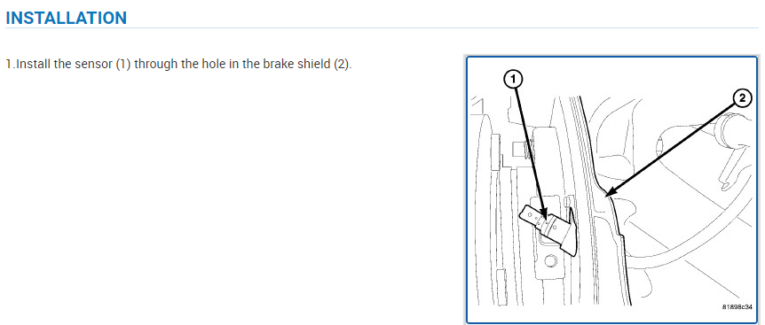

Here is the information you requested. This is a tutorial for you to view on how to replace a wheel speed sensor:
https://www.2carpros.com/articles/how-to-replace-an-abs-wheel-speed-sensor
I've attached picture steps below on how to replace the wheel speed sensor on your vehicle. Hope this helps and thanks for using 2CarPros.
