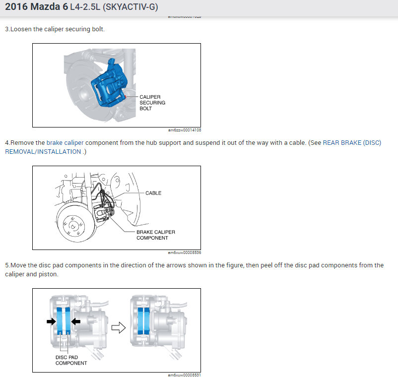

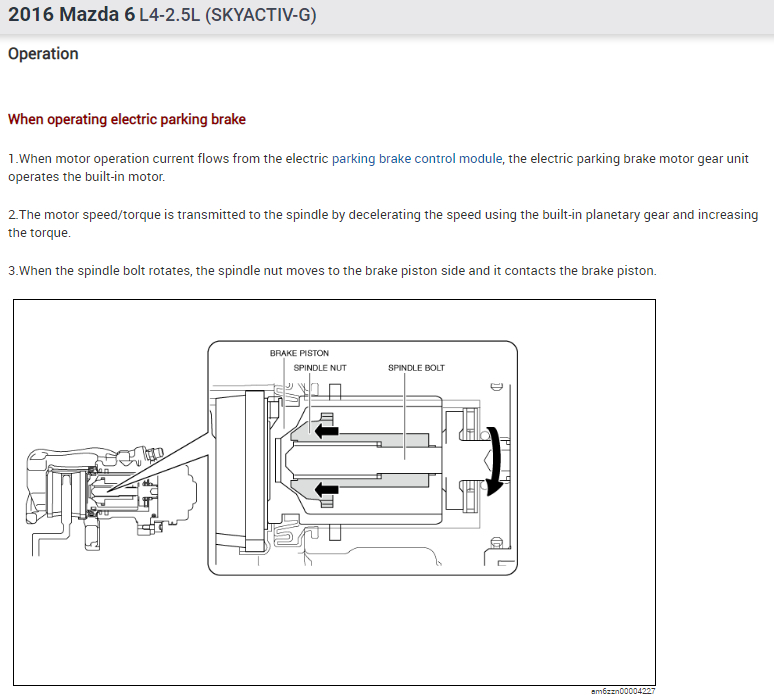

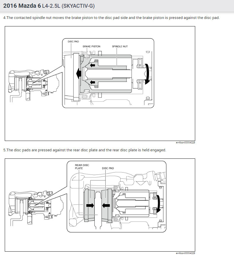

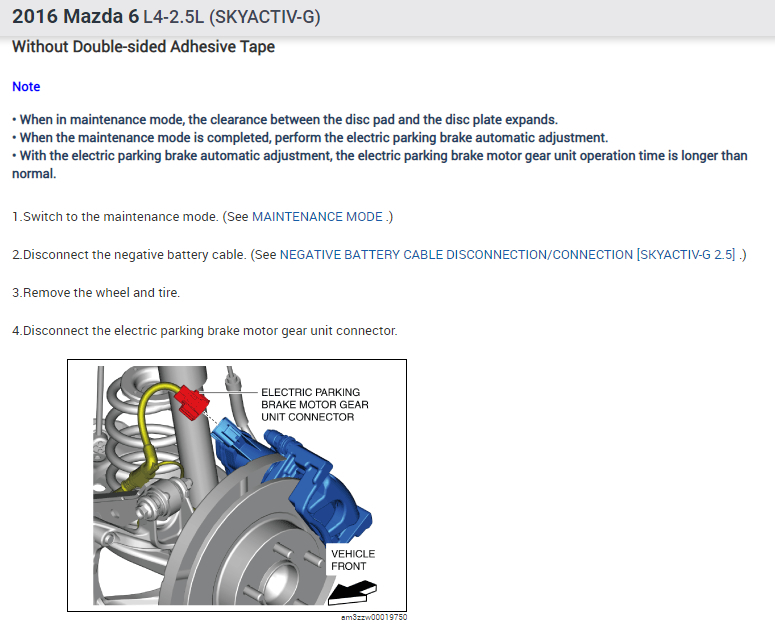

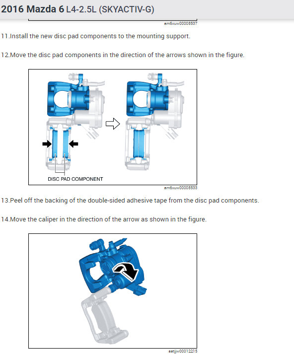

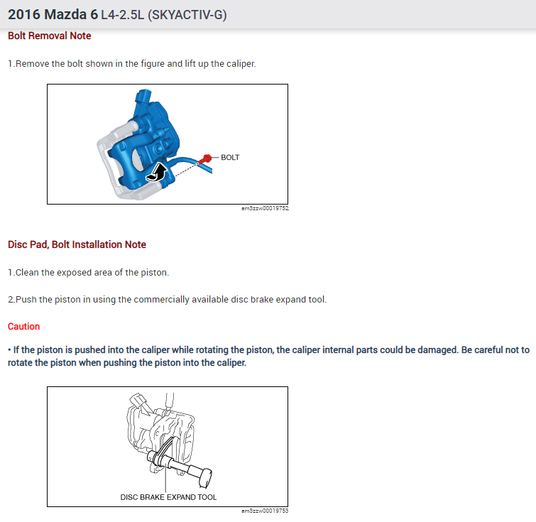

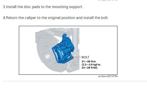

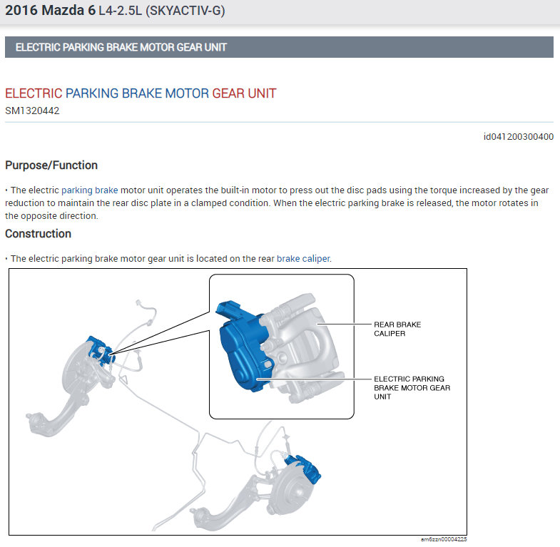

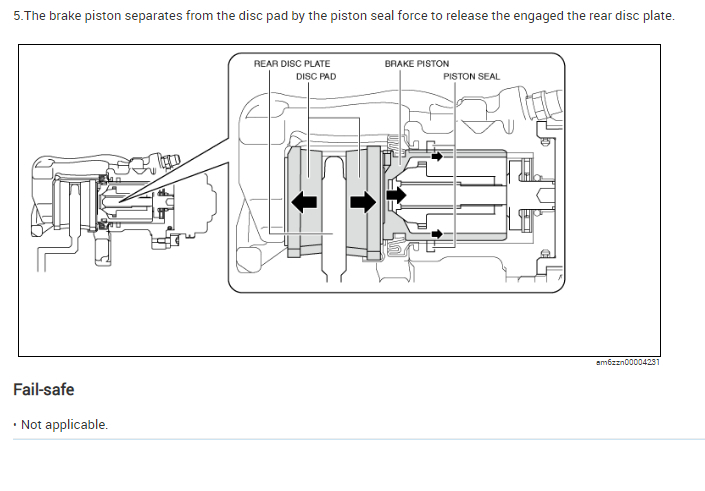

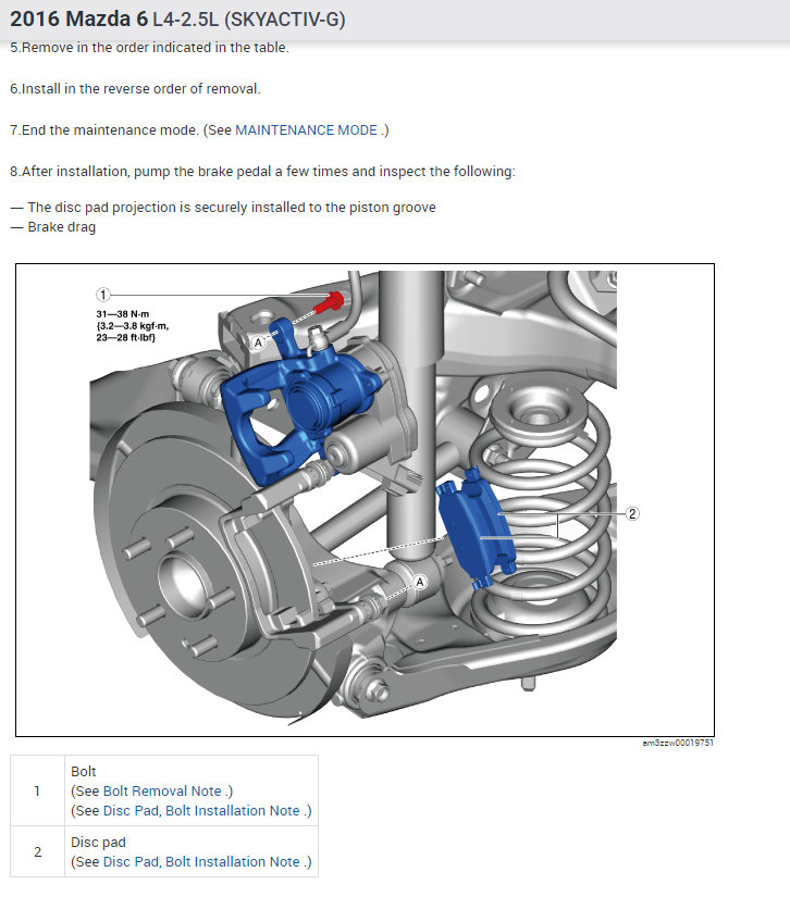

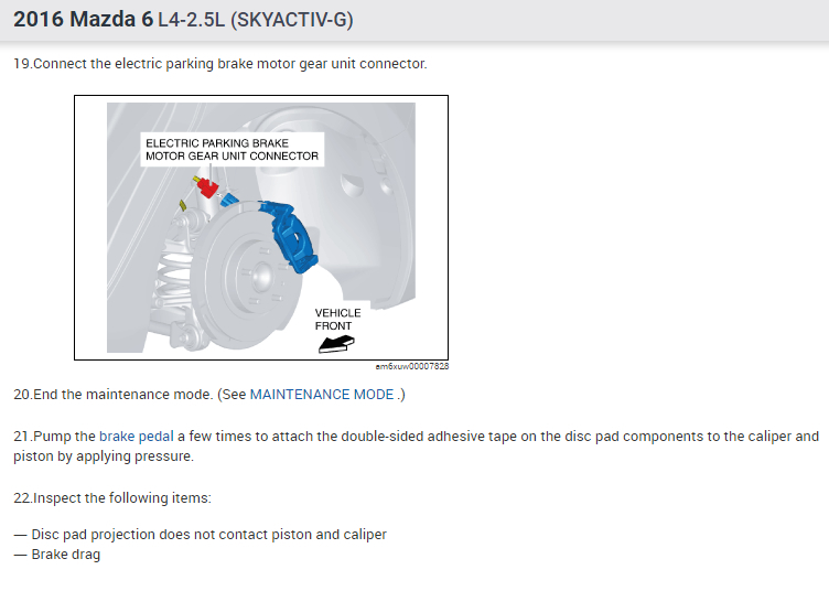

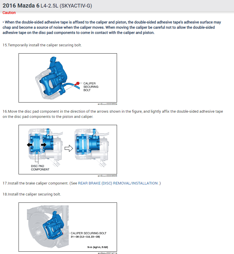

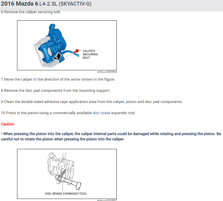

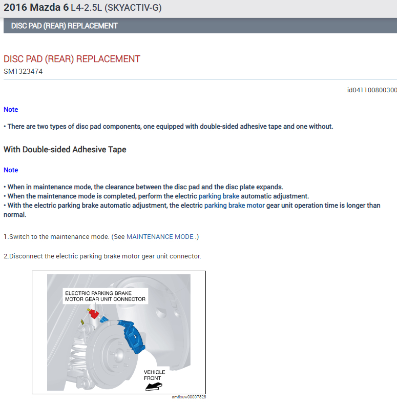

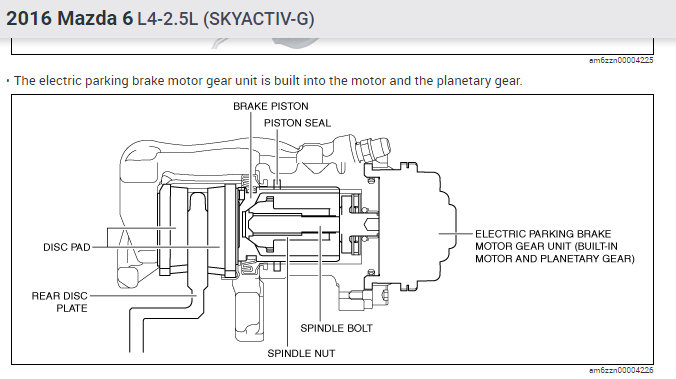

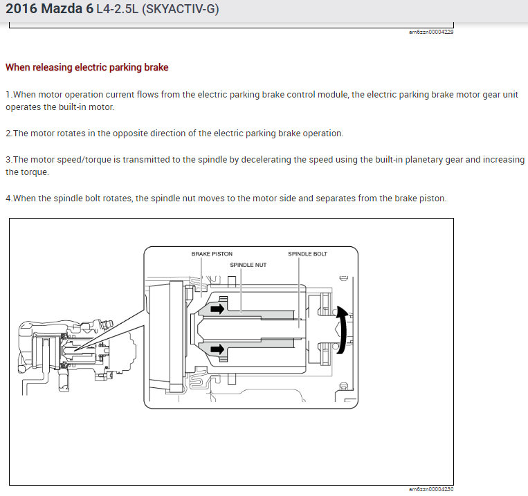

This vehicle does have electronic parking brake. So when you push the lever/switch for the parking brake the motor activates and presses the pads.
While replacing the pads if the motor does not get disconnected, it could get damaged during the install.
https://www.2carpros.com/articles/how-to-replace-rear-brake-pads-and-rotors
I have attached the brake pad replacement procedure including the parking brake function for your reference.
