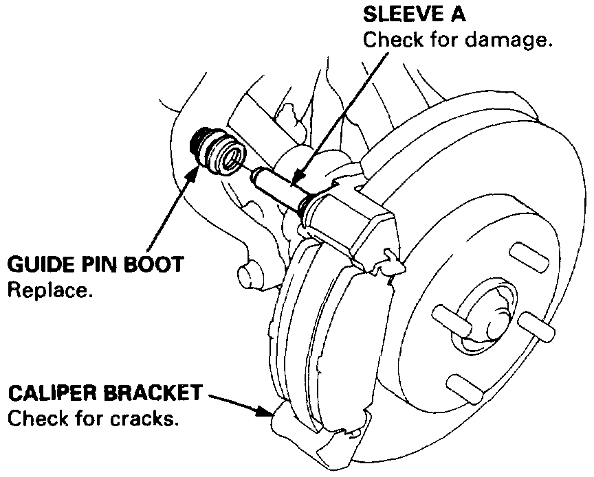

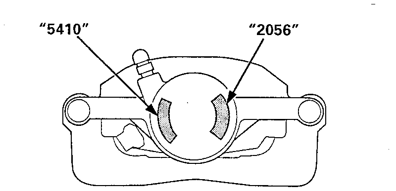

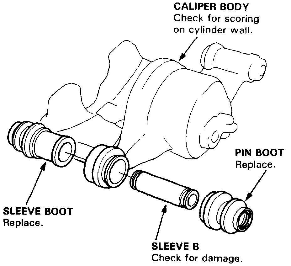

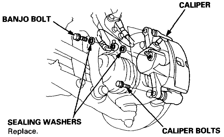

With that in mind, there are two different calipers which could be used on your vehicle. The first picture I attached shows how to identify which one you have. It will either be caliper 2056 or caliper 5410.
_____________________

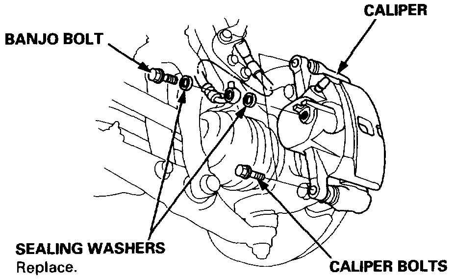

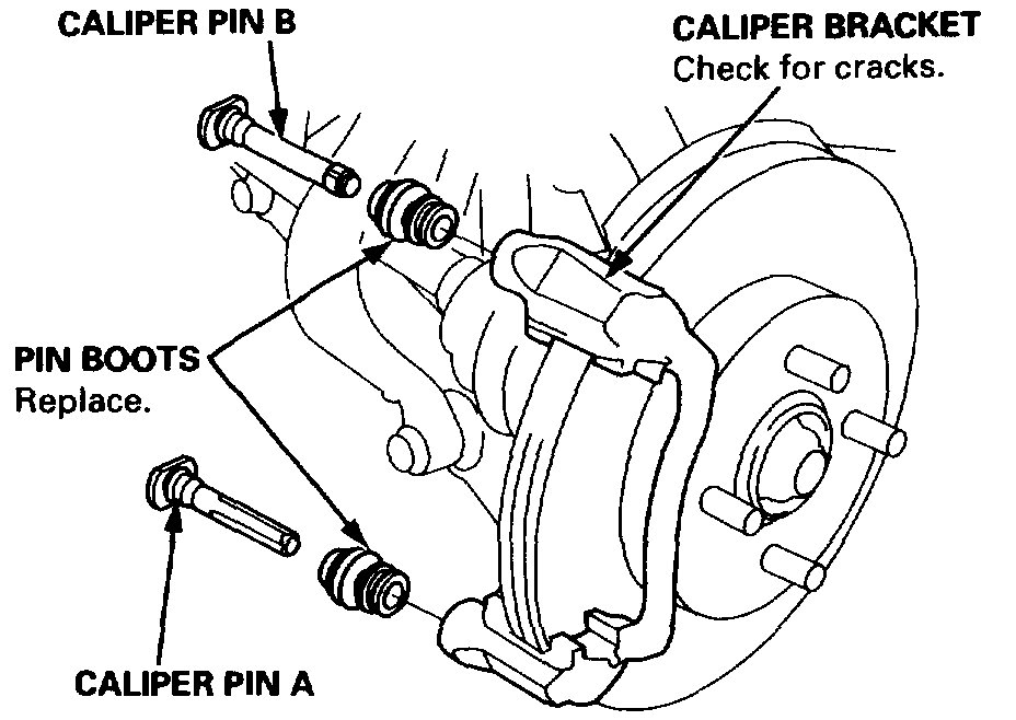

Here are the directions for 2056 (Pictures 2-4)
TYPE 2056
Front Brake Calipers
i
NOTE: There are two types of front brake calipers:
The caliper types can be identified by the "5410" or "2056" stamped on the caliper body as shown. Check the type of the brake caliper before servicing.
WARNING:
- Never use an air hose or dry brush to clean brake assemblies.
- Use an OSHA approved vacuum cleaner to avoid breathing brake dust.
CAUTION:
- Do not spill brake fluid on the vehicle; it may damage the paint; if brake fluid does contact the paint, wash it off immediately with water.
- To prevent spills, cover the hose joints with rags or shop towels.
- Clean all parts in brake fluid and air dry; blow out all passages with compressed air.
1. Remove the banjo bolt, and disconnect the brake hose from the caliber.
2. Remove caliper bolt B. pivot the caliper up out of the way, then remove the caliper from the bracket.
3. Remove the guide pin boot from sleeve A on the caliper bracket.
4. Remove the pin boot, sleeve B and sleeve boot from the caliber body.
Install is reverse of removal.

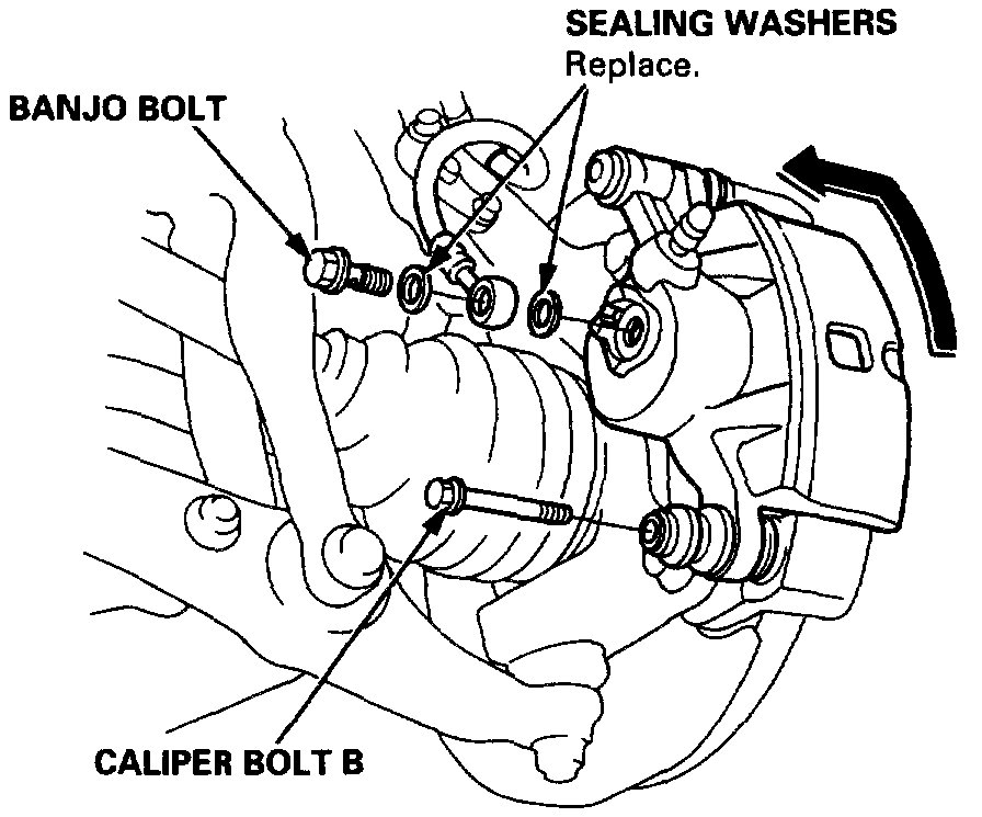

Here are the directions for the 5410 (pictures 5 and 6)
TYPE 5410
WARNING:
CAUTION:
1. Remove the banjo bolt, and disconnect the brake hose from the caliper.
2. Remove the caliper bolts, then remove the caliper from the bracket.
3. Remove the caliper pins and pin boots from the caliper bracket.
Install is reverse or removal

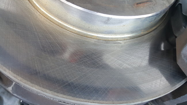

The brakes are making a grinding noise I already replace the brakes and rotors. And the caliper just slides right now. What would the reason that is not any pressure between the caliper and brake pads?

Here is a picture of the rotor:

Did you bleed the caliper? When you apply the brakes, does the vehicle pull to one side?

I have not replace the caliper yet, but when I was driving it yesterday it pulled to one side with a grinding sound coming from that side.
Mar 16, 2021 at 11:04 AM
If it is pulling, I feel confident that one of the calipers is not working. The picture you attached appears to be an unused rotor. If you have driven, it should show some indication of the pads rubbing on it. As far as the noise and the pull to that side, think about it. If that is the only caliper working, the other side continues free wheeling where as the opposite side is braking. It will pull to that side because it is working.
Let me know if this makes sense or if you have other questions. I will be here.
