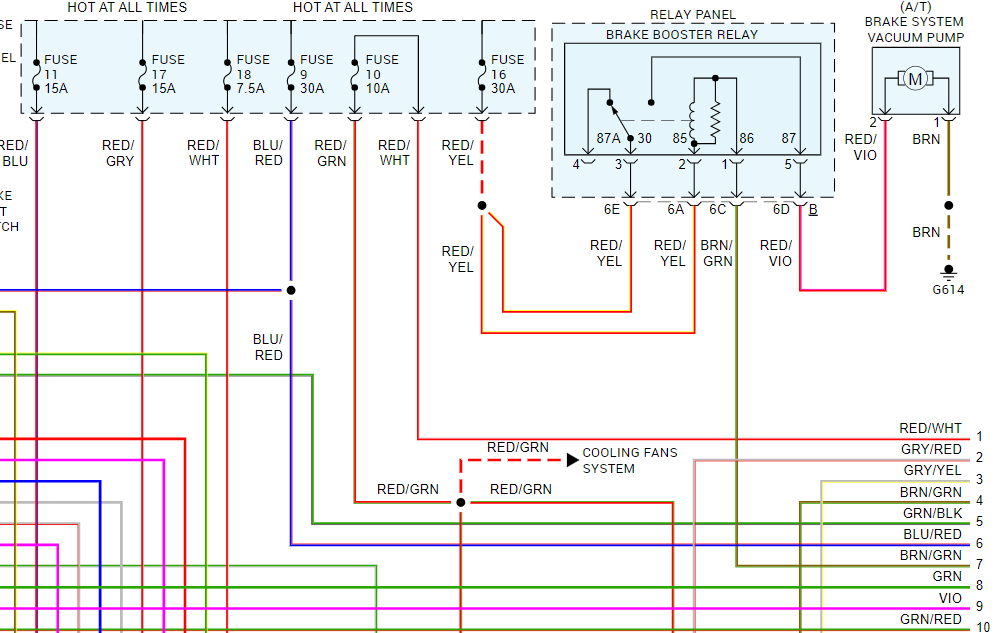

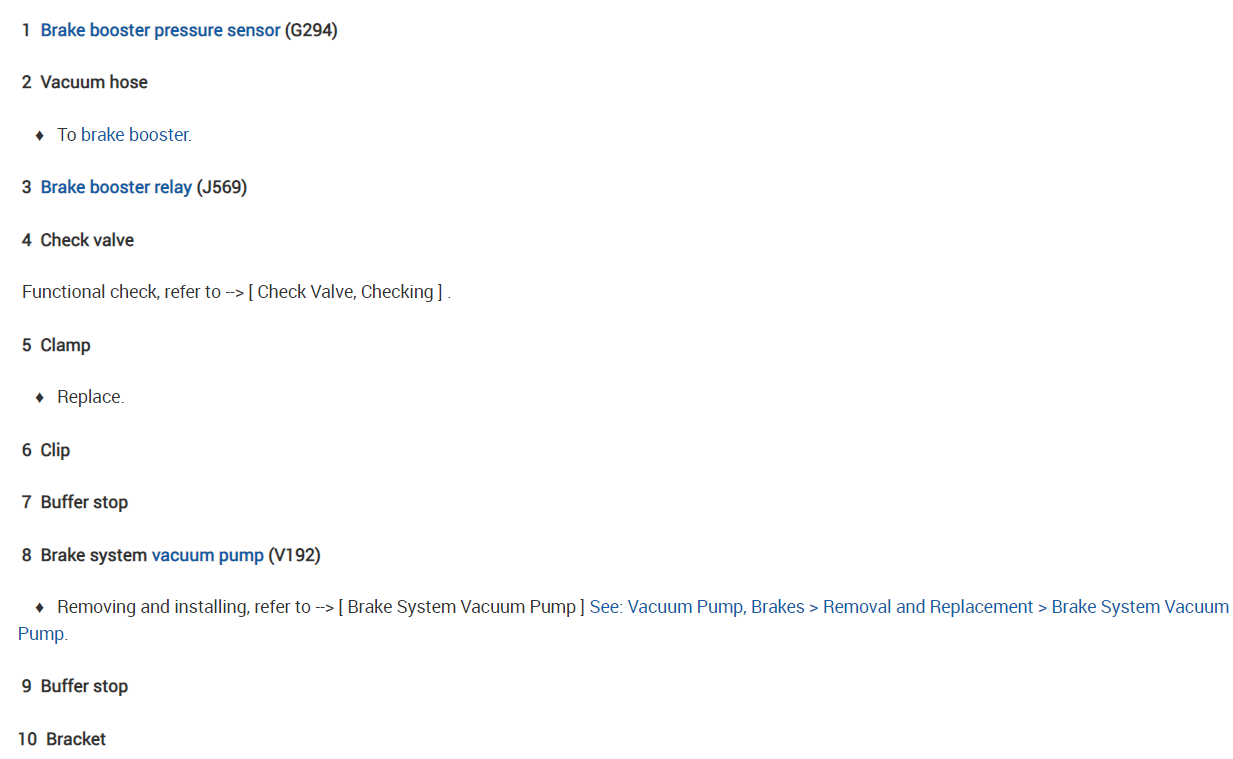

I have a hard brake pedal, and I’m not getting any power to the plug that connects to the vacuum pump! I’ve tested the pump, and it works, also fuses and relays! The only thing I think could be the problem is the brake switch! Just not sure if the switch goes to the pump.
