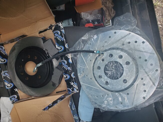

Here's a picture of all the month new parts that the mechanic was supposed to install and never did
Sep 7, 2025 at 7:20 PM
Yep, those look like good parts, did you want to try installing them yourself? We can help walk you thought it, CARADIODOC and myself ;)
