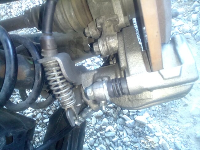

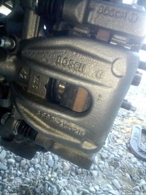

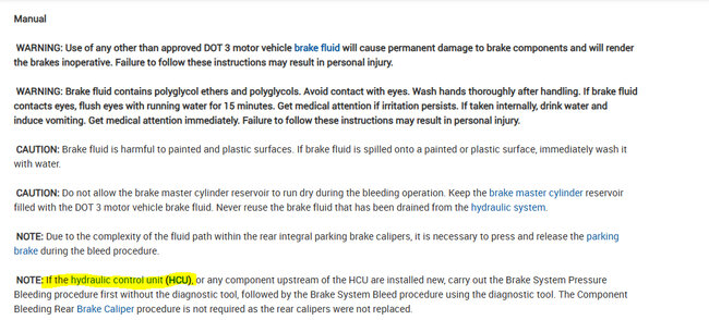

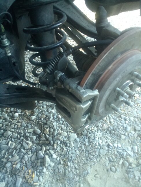

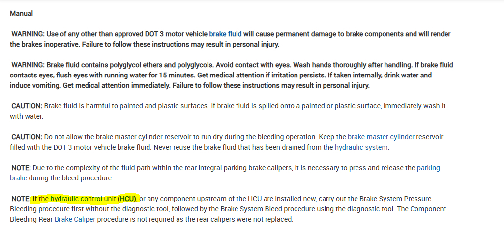

Do me a favor. Send me a pic of the caliper in question. Also, due to the complexity of the fluid path within the rear integral parking brake calipers, it is necessary to press and release the parking brake during the bleed procedure. Once the rear caliper is bled manually and the bleeder tight, it is recommended actuating the parking brake five times.
Dec 17, 2024 at 6:52 PM

However do you have a link for how to bleed the ebrake? I had no clue about that at all. I'll send I pic when I get home tomorrow. What part of the caliper do you want to see?

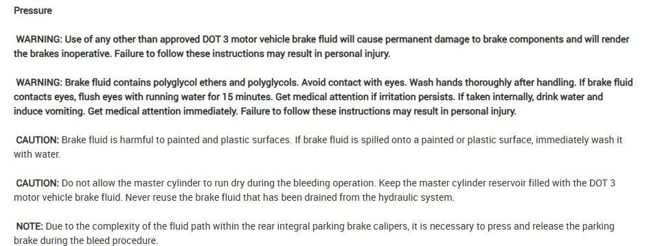

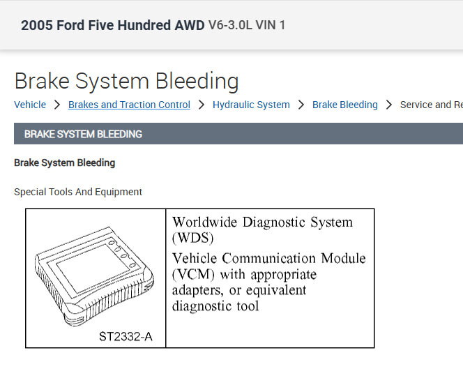

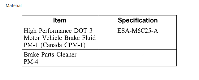

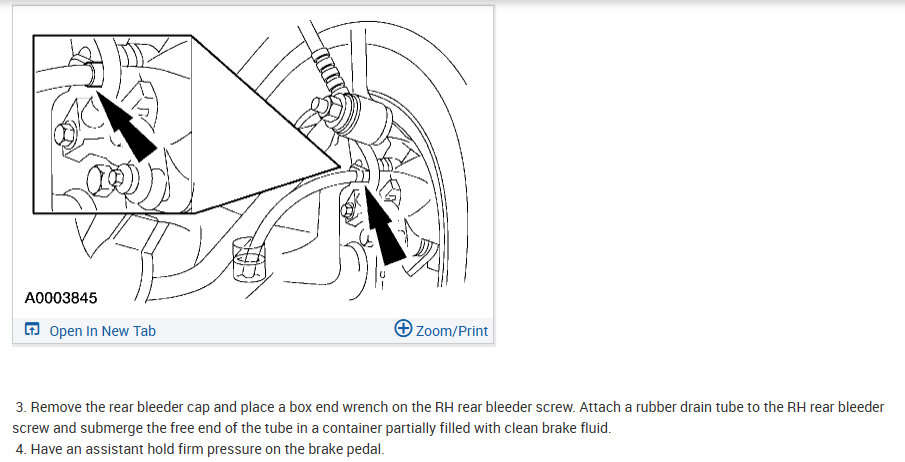

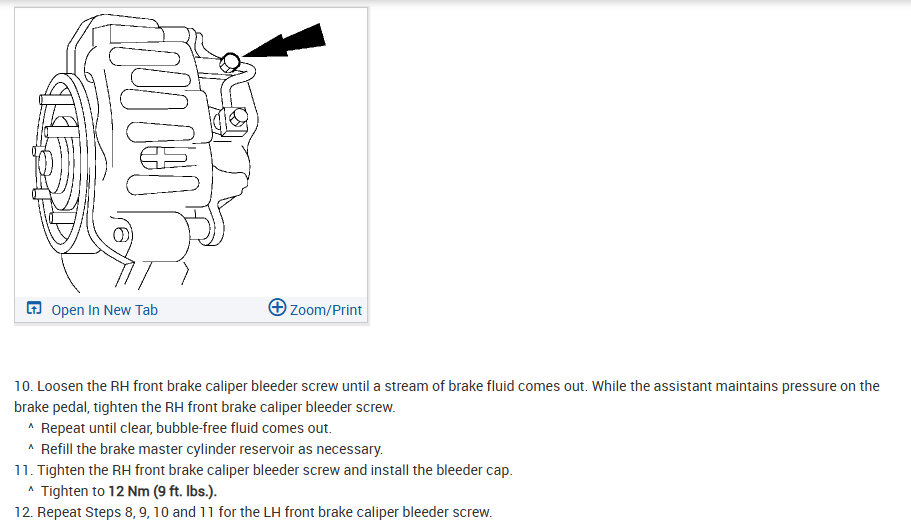

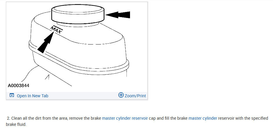

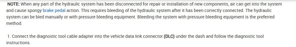

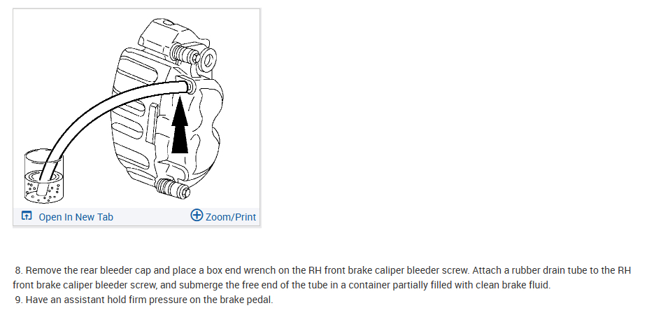

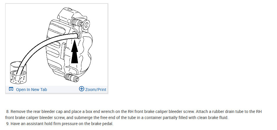

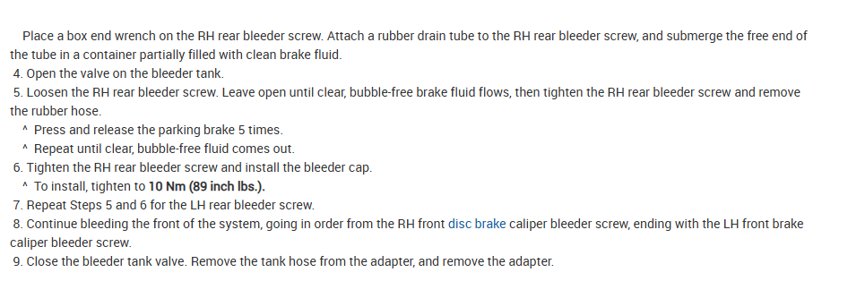

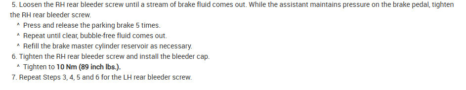

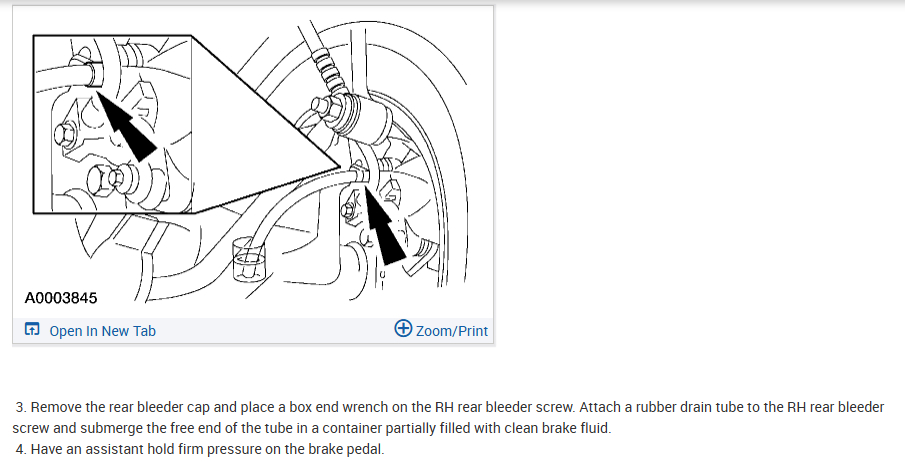

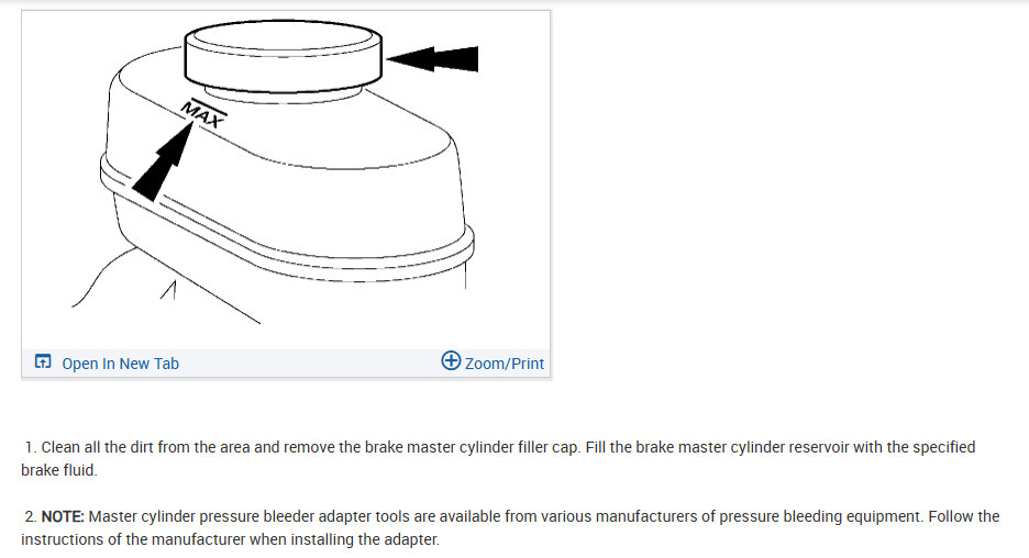

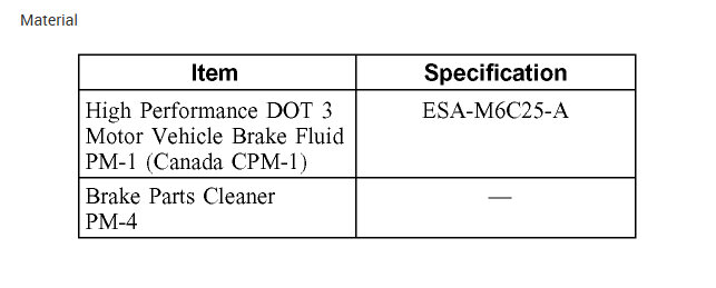

I attached the directions below from my manual. Note that it does indicate using a scan tool, but that is if the HCU was replaced.
I hope this helps. Let me know.
See pics below. Please ignore the next to the last pic. That was accidentally added, and I can't delete it.
Dec 19, 2024 at 5:49 PM

So I need a special tool to be able to do this? Also, some of the directions are repeated. Is it supposed to be done twice on the rear brakes?

Also pic #7 says to close the bleeder valve then pump the parking brake until clear bubble free fluid comes out then close valve again. When do I open valve before I pump ebrake? Am I supposed to bleed as normal close bleeder, then immediately open same bleeder to pump the ebrake? Do I need to close bleeder valve between pumping brake and pumping ebrake if so what's the reason? Or is that just weird wording I'm just making sure I'm doing it properly thanks. Also, caliper does push out and I was able to twist back in with c-clamp and channel locks. Still doesn't release so want to make sure I get this ebrake bled correctly.
Jan 4, 2025 at 12:25 PM
After you bleed from the hydraulics, close the bleeder. Then, follow the park brake directions. Repeat the hydraulic procedure to see if there is air. If not, you're done. If there is, continue that process until no more air is present.
