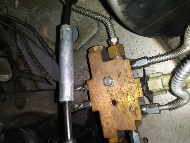

After going through all of that I removed the brake lines and pushed compressed air through them and all are clear but still no fluid to rear passenger side. So the only other thing is the proportion valve. Can that be rebuilt? I have checked everywhere and no one has it or can get it.
Apr 16, 2020 at 10:08 AM
No, it cannot be rebuilt at all.
Did you not have a pedal when you clamped off the lines?
Does this have ABS brake unit?
Apr 16, 2020 at 2:37 PM
TOOSOC
How do I tell if I have a PV2/PV4 porpotion valve?
Apr 19, 2020 at 9:44 AM
It should be stamped on the valve itself.
Clean up the old one and look for the stamping.
Apr 19, 2020 at 9:46 AM
TOOSOC
The only stamp on the part is 628 0108.
Apr 19, 2020 at 9:52 AM
That is a PV4.
