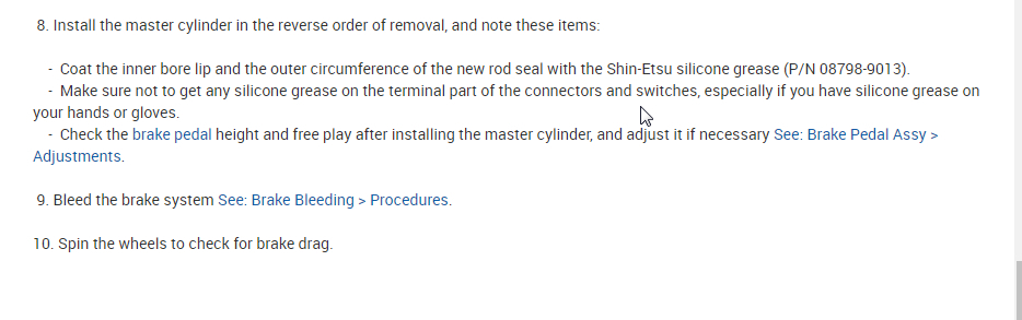

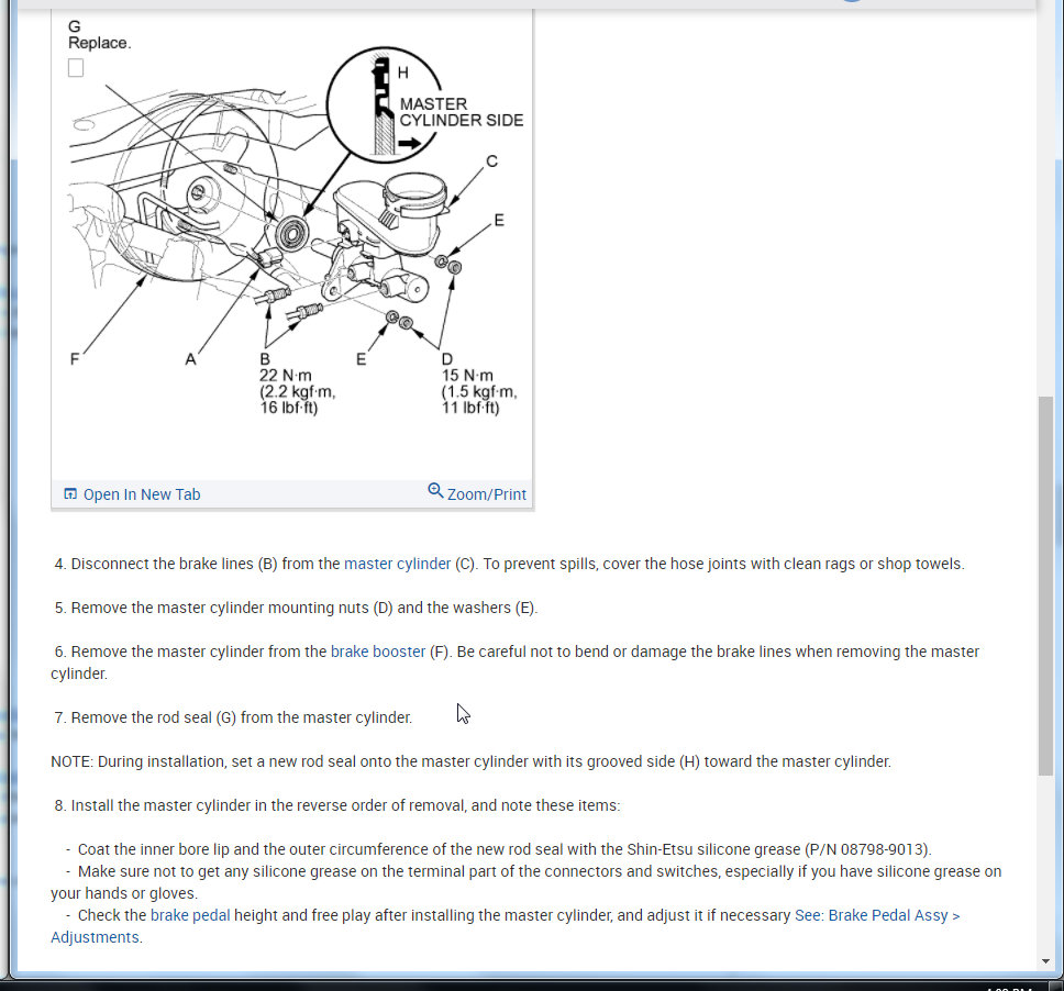

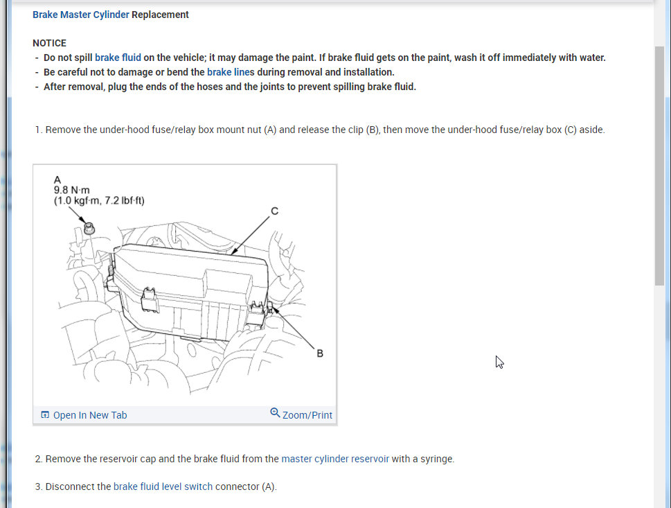

Hi, i have to replace the brake master. will i be able to bleed just this wheel or is a full bleed necessary? I ask because i don't want to mess with old bleeders nor have the money to do all.
May 1, 2019 at 12:47 PM
Here is a guide that will help with this:
https://www.2carpros.com/articles/how-to-replace-a-brake-master-cylinder
I am attaching the process below from the manual on how to replace this. However, you are going to have to bleed the brakes as well, so here is a guide that will help with this:
https://www.2carpros.com/articles/how-to-bleed-or-flush-a-car-brake-system
Let us know if you have questions. Thanks
