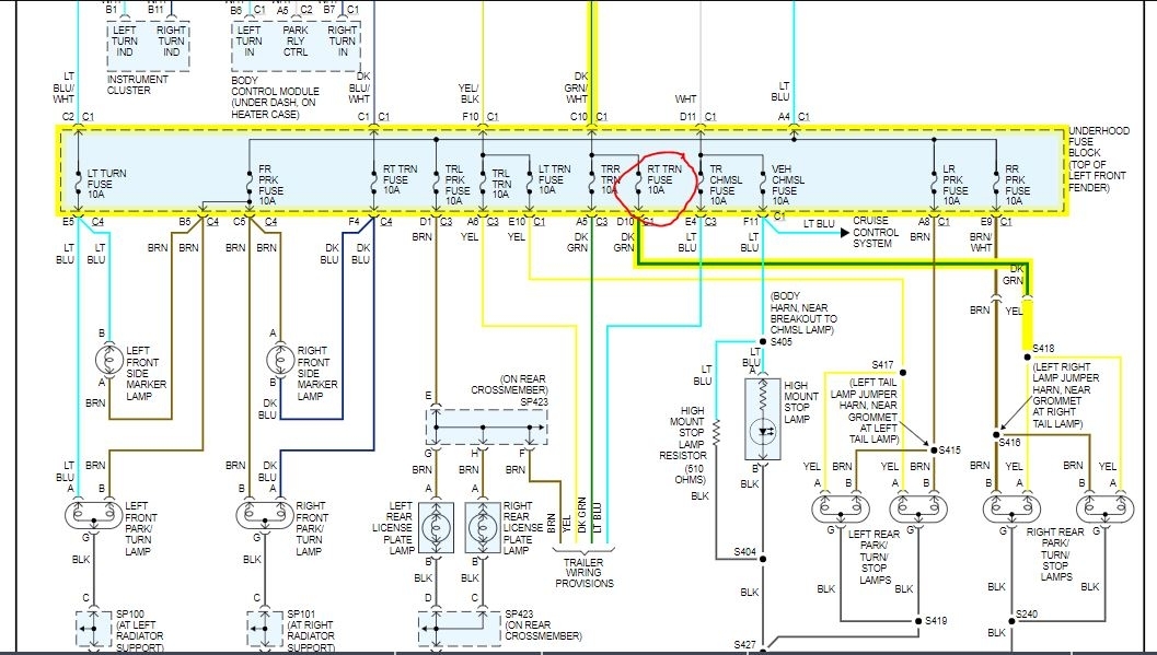

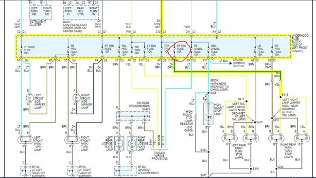

My vehicle's right rear brake light and turn signal does not work. the running light does. all other lights work.
Feb 19, 2020 at 12:31 PM
Good afternoon,
I attached a diagram for you to follow.
The power comes from the turn signal switch to the fuse block and then off to the right rear light.
Test for power to the fuse and make sure the fuse has not failed.

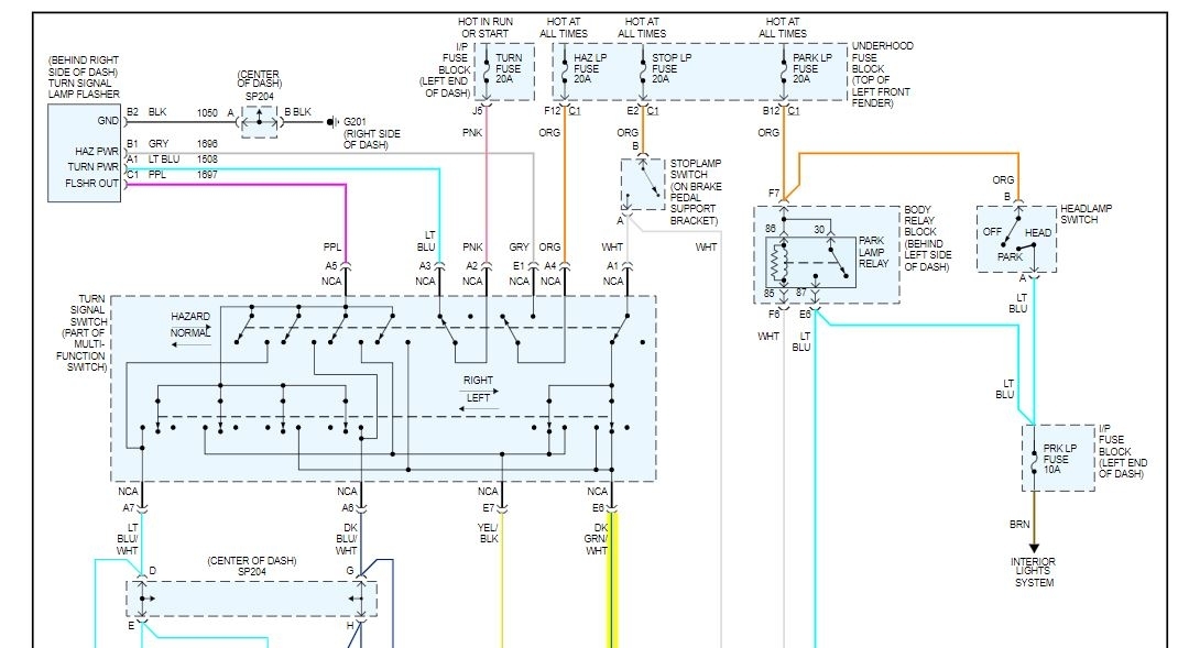

my turn signals stopped blinking by themselves so i manually operated the turn/signal switch to make the lights blink......then suddenly around two the three months later the turn lights are altogether inoperable..tried checking the fuses and all seem ok...no breaks in any of the fuses. also this seemed to happen after replacing one of my front headlights. additionally after replacing that headlight my DRL is not working also.
Jul 28, 2021 at 1:39 PM (Merged)
RACEFAN966
  • 5,029 POSTS
I would first check the turn hazard flasher module behind the left side of the instrument panel. Check the purple wire for power. Let me know what you find.
RONELAKE
the hazard lights are working fine, i should have included that in my question, sorry. Where do i go from here. Could a bad turn signal flasher make the turn signals completely inoperable?
RACEFAN966
  • 5,029 POSTS
Well I would check the turn signal flasher first. Then check the purple wire as discribed previously. Let me know how it goes.
RONELAKE
Yes the flasher was the problem. It was located under the dash behind the cigarette lighter so a lot of disassembly of the lower dash panels was necessary. I have to give it to those guys at General Motors because first they didn't list where the flashers were in the owners manual or that it could even be the problem, and second every screw, bolt nut was a different type than the other making it no so easy for me to replace. And I have worked in the automotive service industry for about 15 years. So it came down to just a three dollar flasher. But i am back on the road now and am a happy camper.
