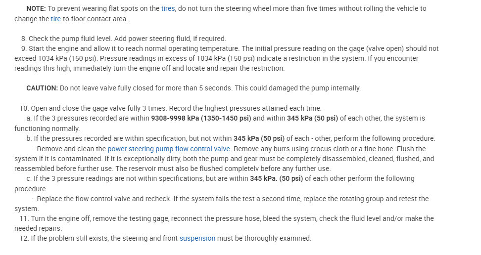

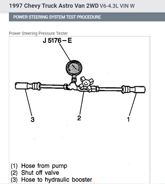

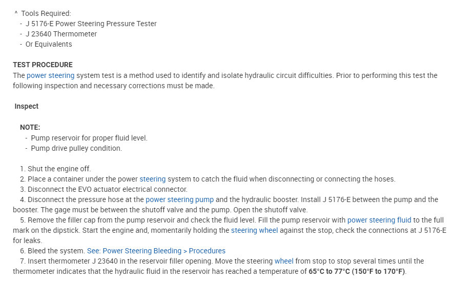

When the power assist comes back intermittently, the van will almost throw itself into the oncoming lane. how do I find out if my power steering pump is bad and needing replaced?
