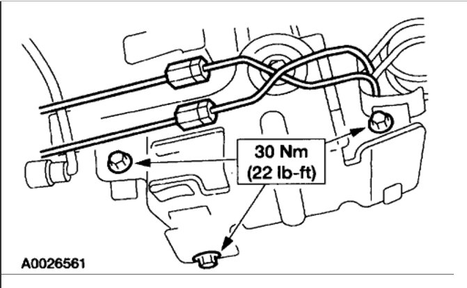

There are two things I can think of one is the level sensor in the master cylinder is bad this will cause both the ABS and brake light to come on. If that checks out it sounds like the ABS module is bad. Here is a guide that will show you what you are in for when changing the unit out:
https://www.2carpros.com/articles/how-to-replace-a-abs-controller

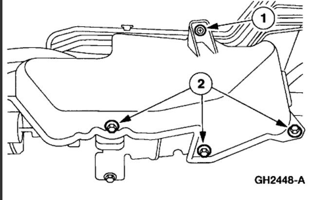

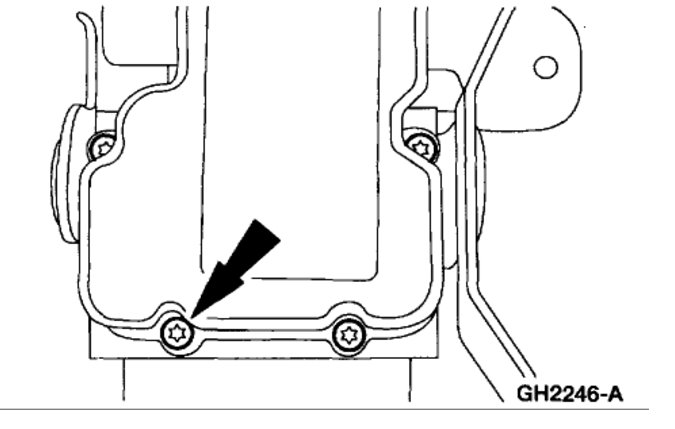

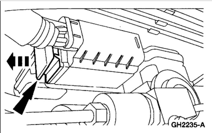

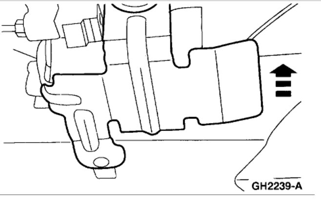

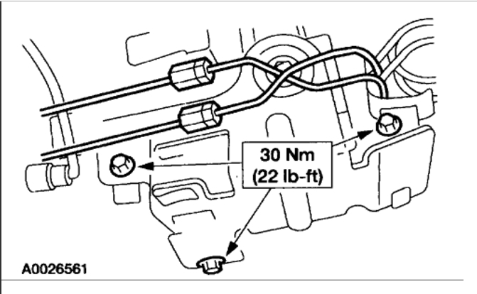

Here are some diagrams for what it will be like on your car.
Please let us know what happens, we are interested to see what it is.
