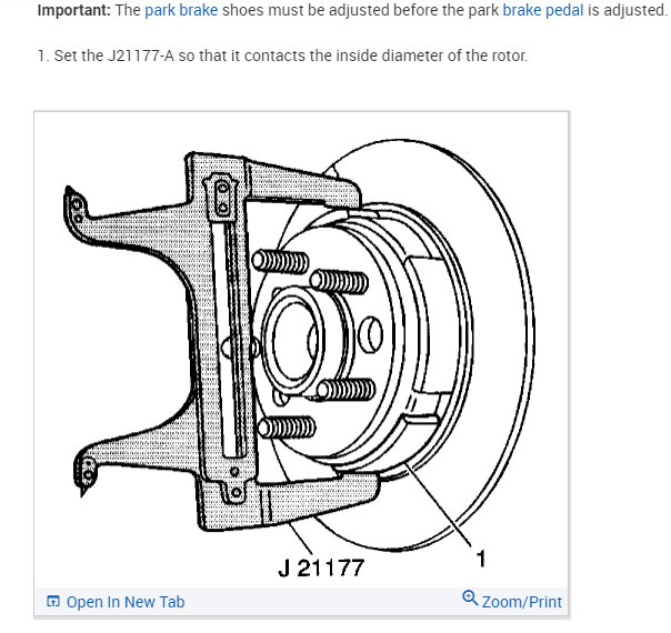

Adjusted both adjusters same. Give little gas and car moves and slowly moves on hill. Lu changed the brake pad in drum. changed the right cable and held a little better. But on hill a little gas and it move. should pedal only go 3/4 way down?
Jun 12, 2023 at 10:37 AM

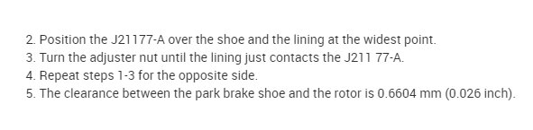

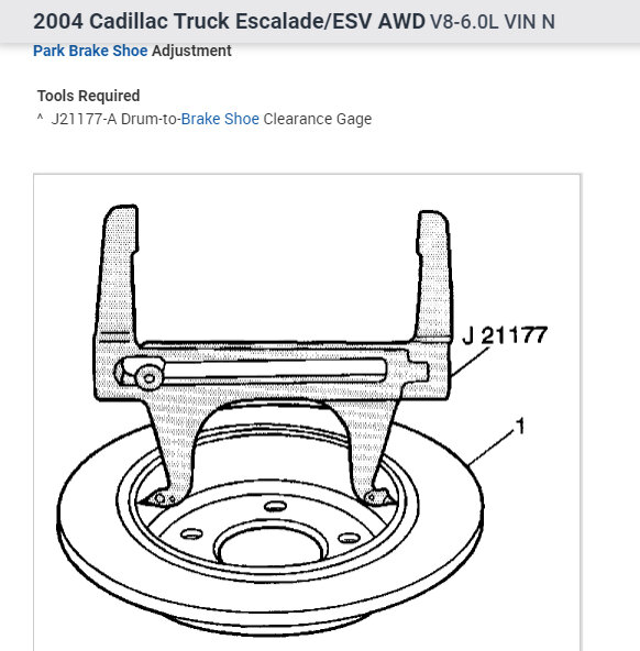

Adjustment is done at the equalizer and the brake shoe. When you installed the new shoes, how did you adjust the shoes? That needs to be done first.
I attached the directions for parking brake shoe adjustment. Let me know if this is what was done.
See pics below.
