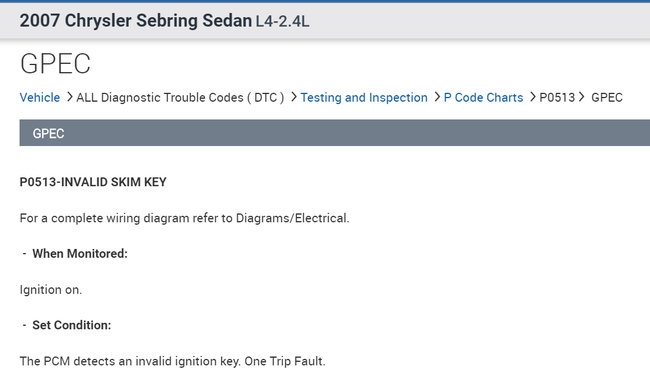

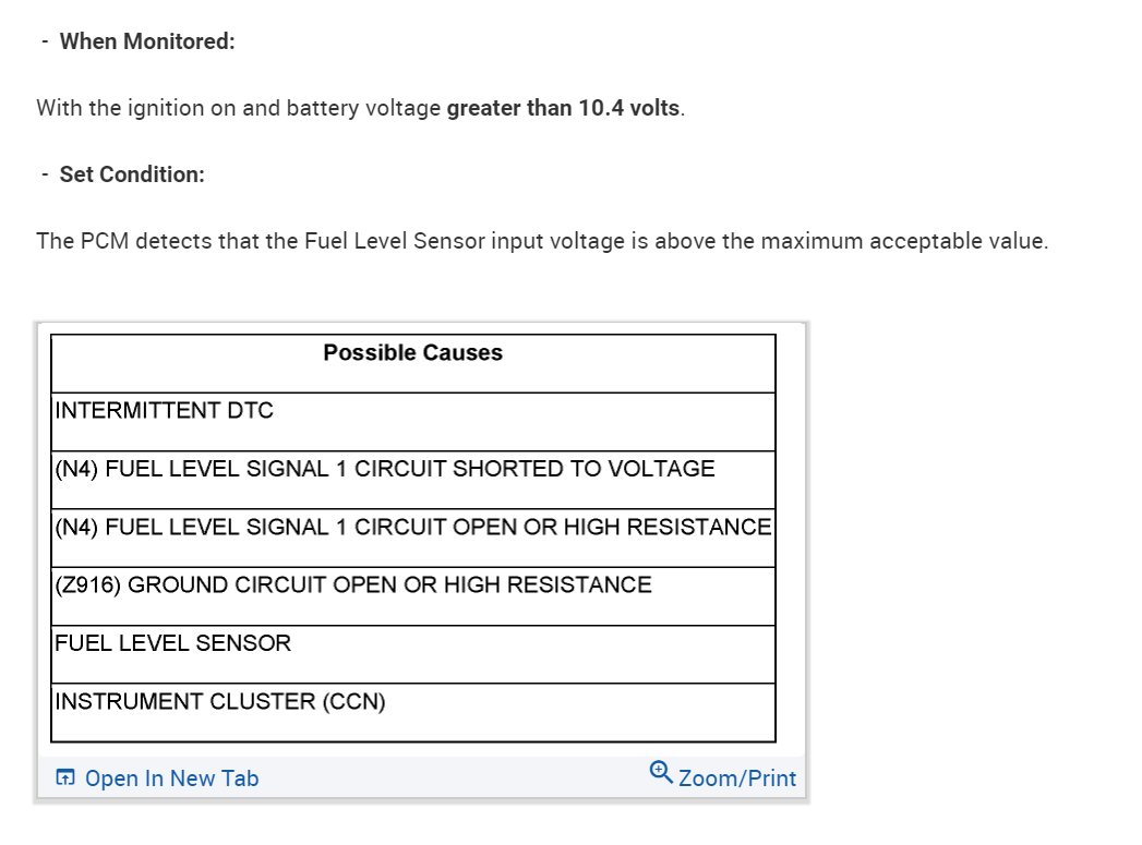

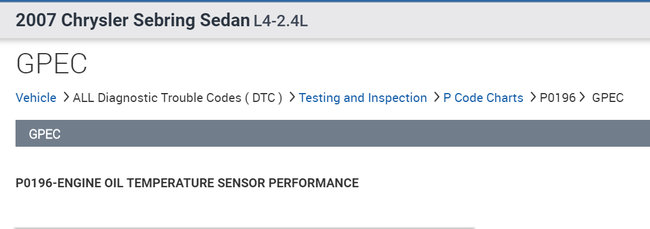

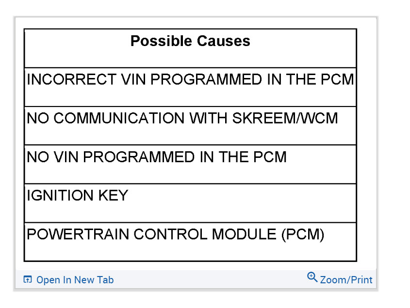

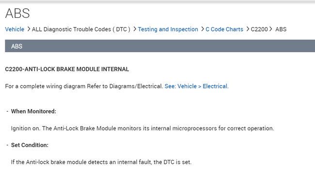

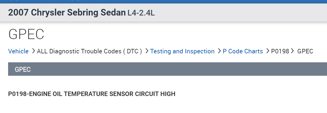

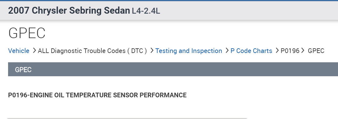

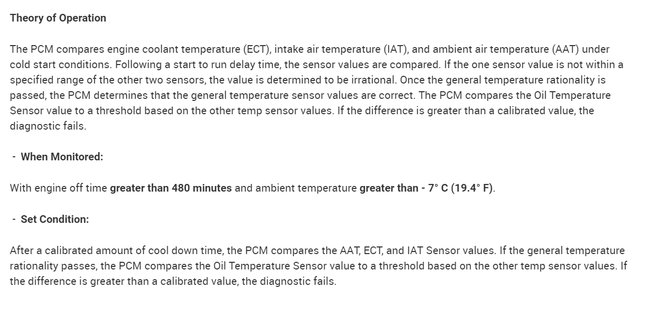

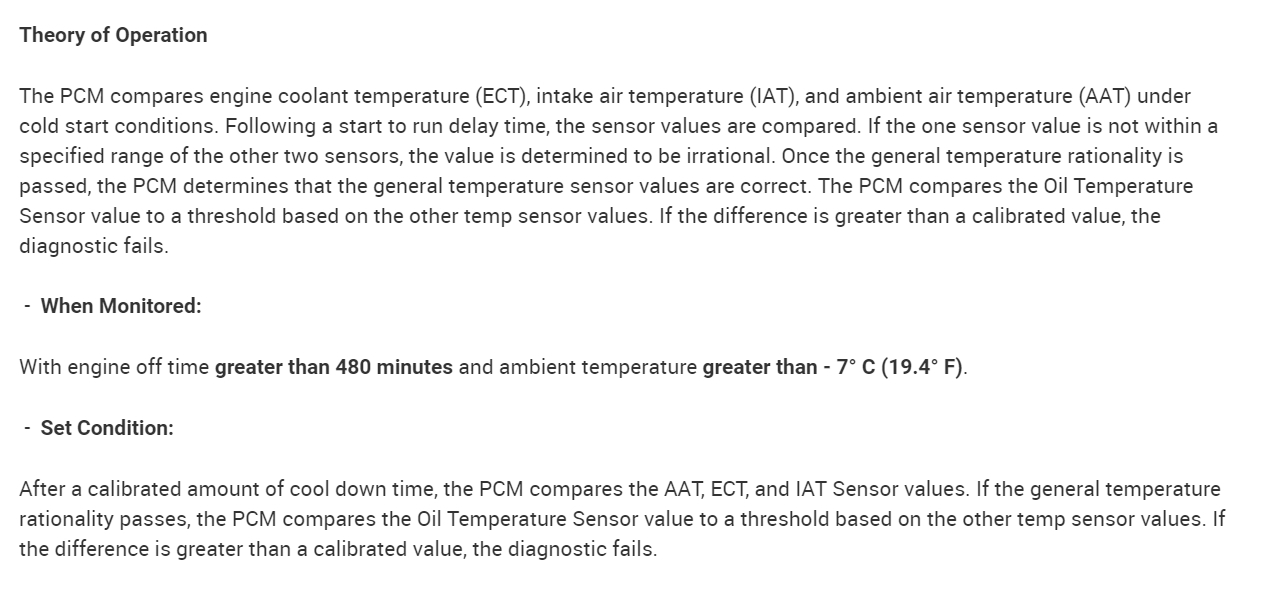

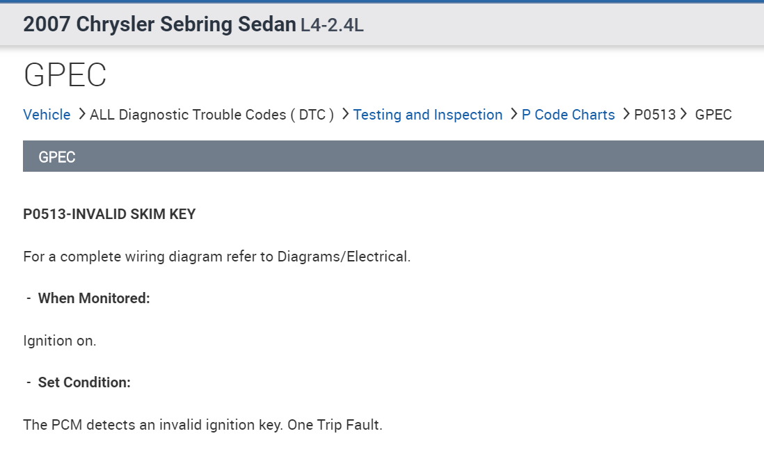

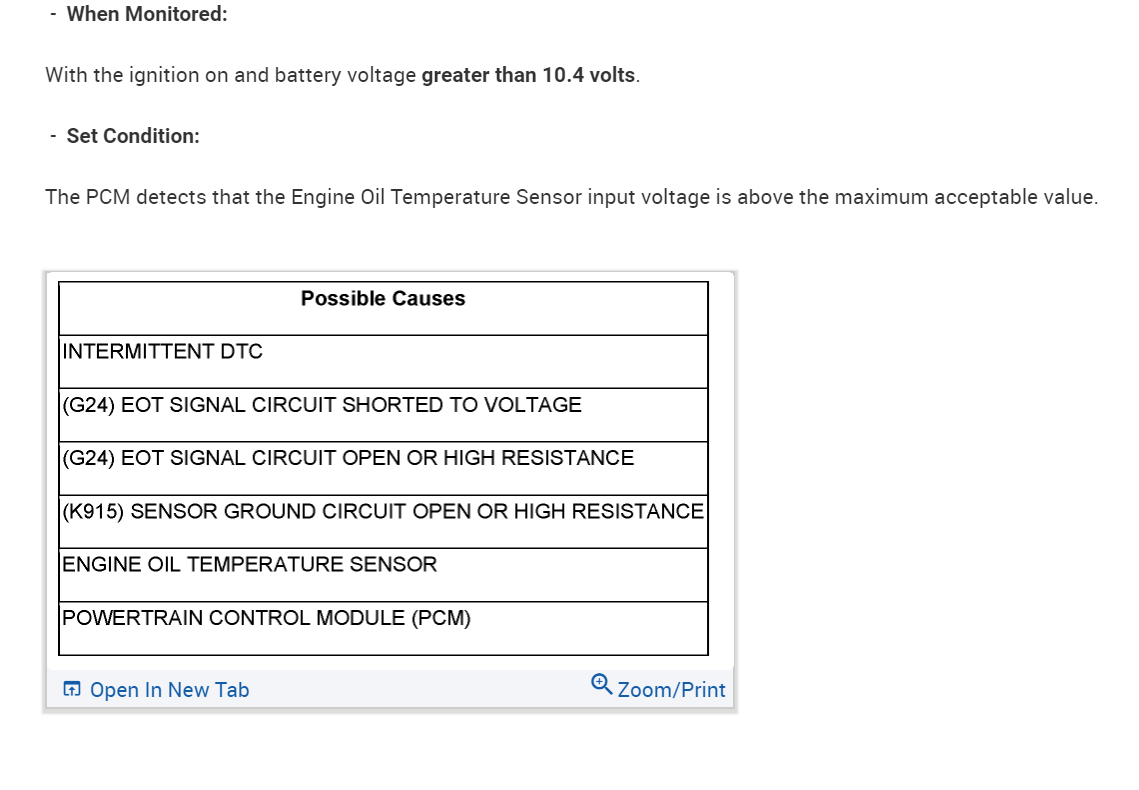

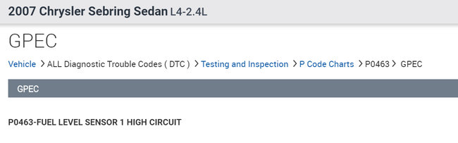

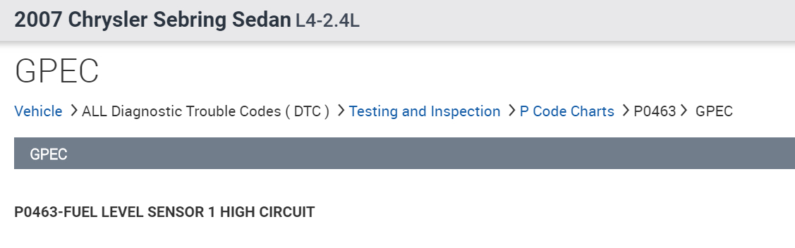

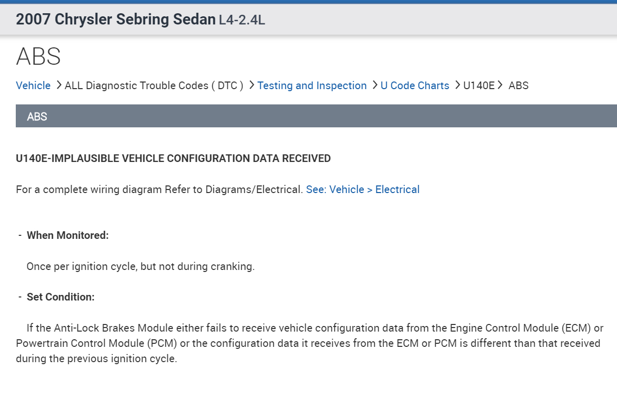

I got the car only days ago. Today i had a code reader hooked to it and it is showing multiple codes. All of which I have never personally dealt with. Also some of the codes from what I have researched could possibly be from the same issue.
P0198 P0513 P0463 P0196 the more unusual codes- U140e C2202.
