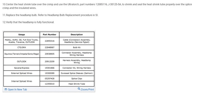

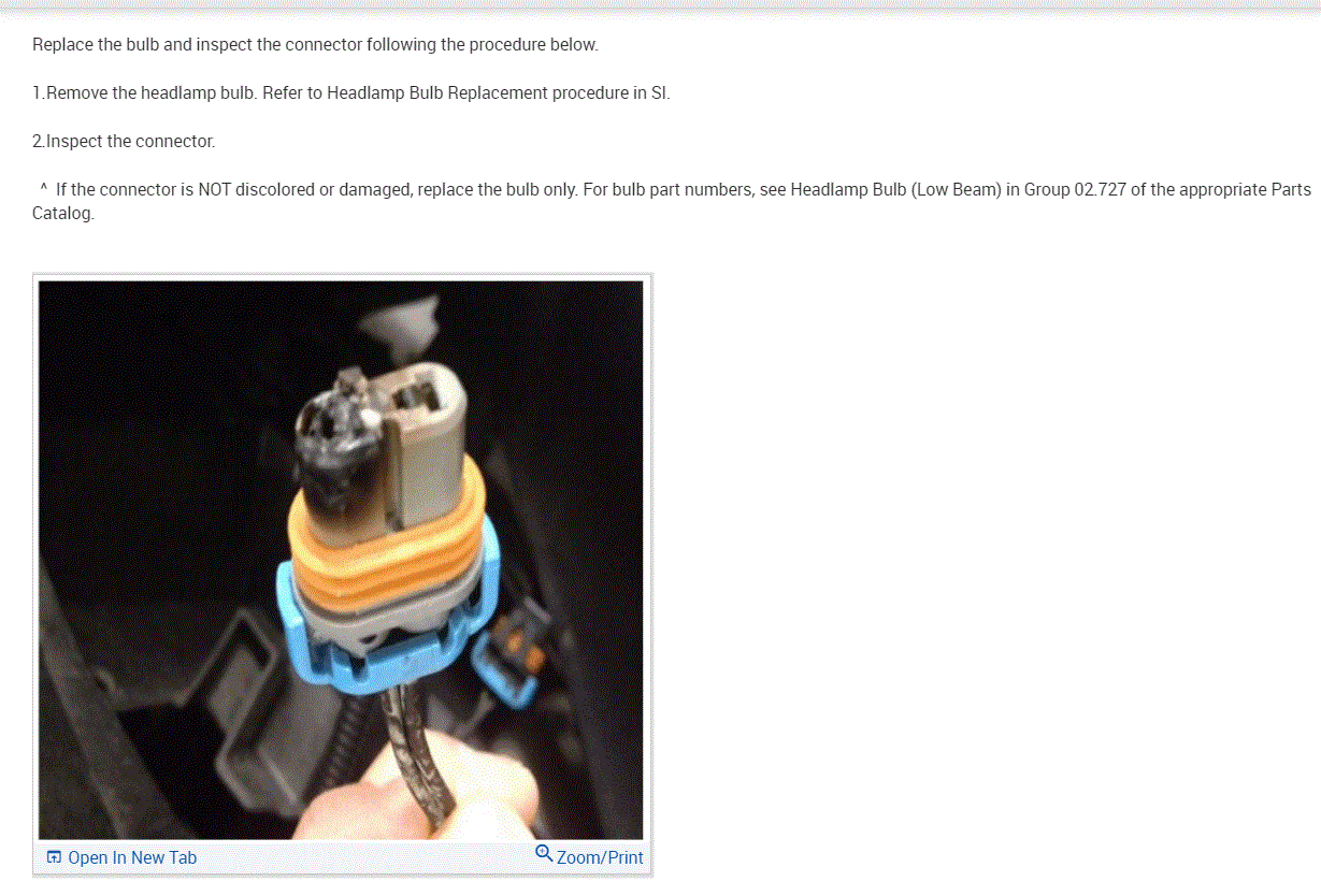

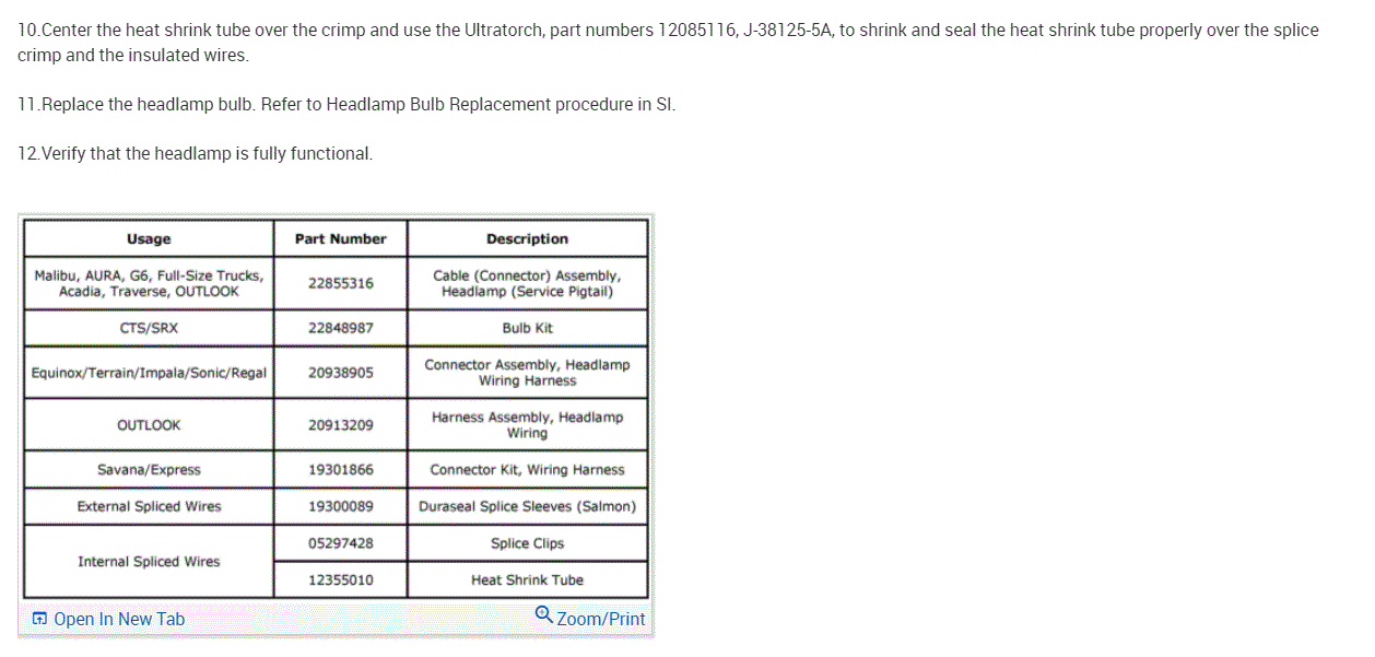

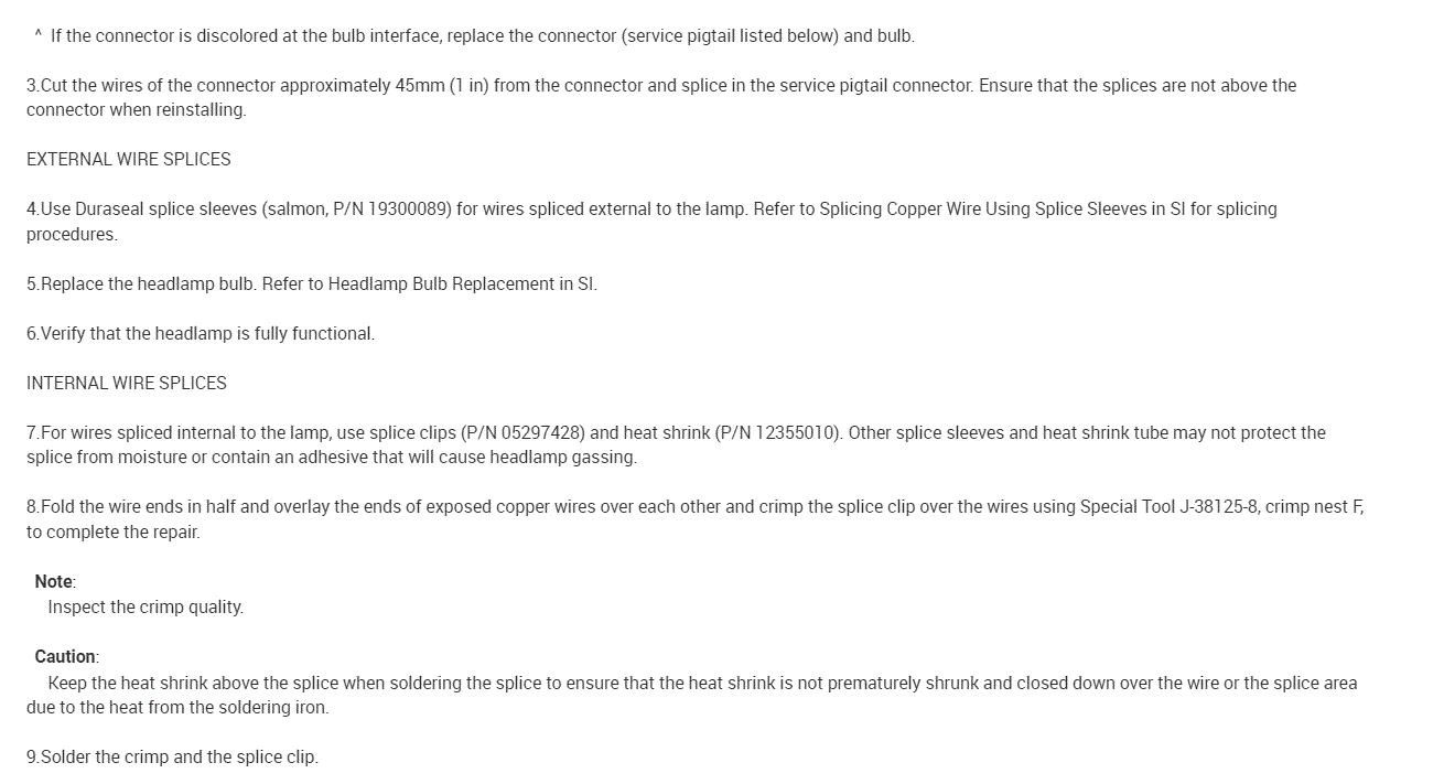

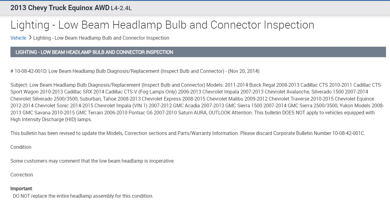

There is a technical service bulletin (TSB) related to this issue. According to the TSB, there is a likely hood that the connector at the bulb has failed (melted). I attached the TSB below for you to review. Inspect how it indicates and let me know if the connector is the issue.
The TSB explains how the problem is repaired.
See pics below.
