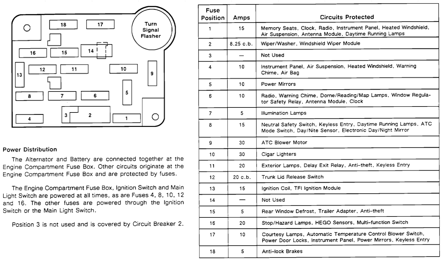

I need both Fuse panel diagrams for the main one under the steering wheel, and the one under the hood. thanks so much.

There is only one fuse panel for this car, Here is a guide to help you testt he fuses for power and the fuse panel ID in the images below.
